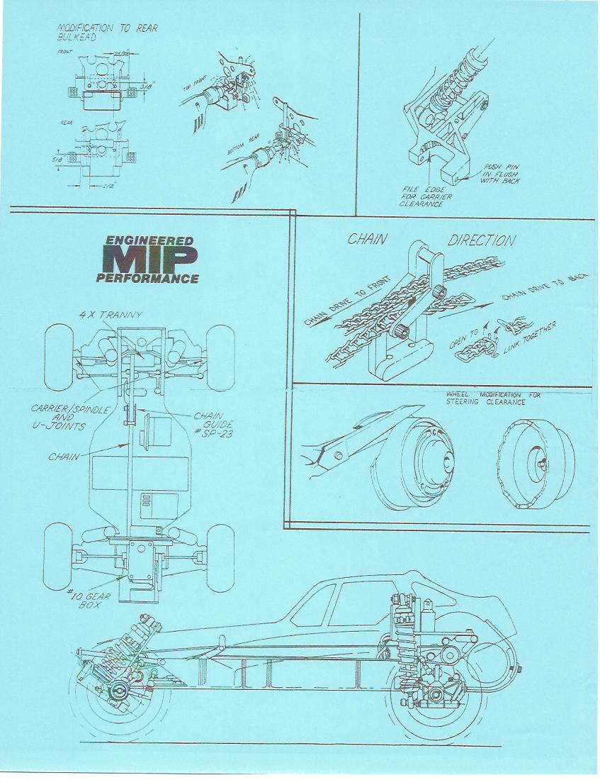

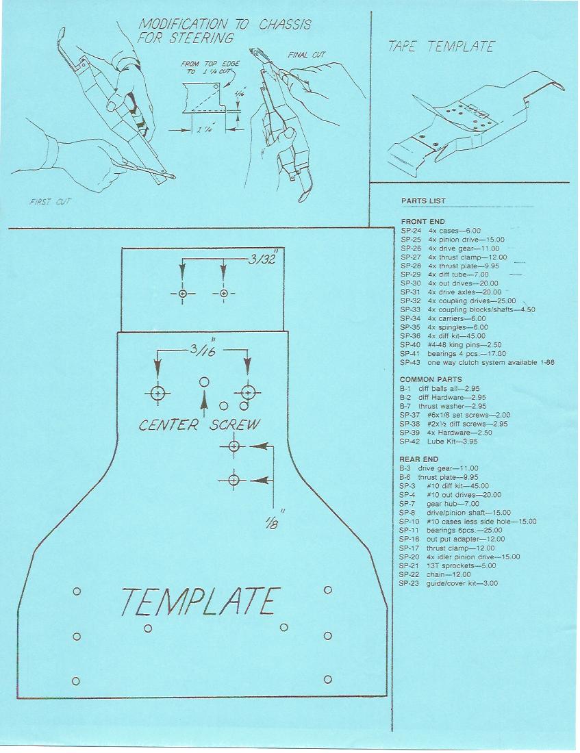

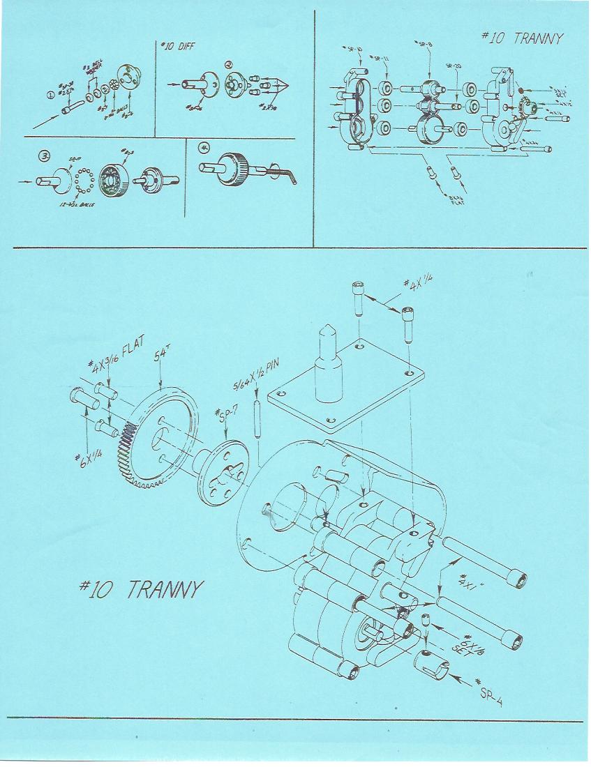

Couldn't find any SP-2 instructions in the scans section so thought I would put some up, additionally I will do the SP-45 belt drive upgrade instruction in a 2nd post.

In case you might have trouble viewing these pages in Photobucket here they are in attachment form:

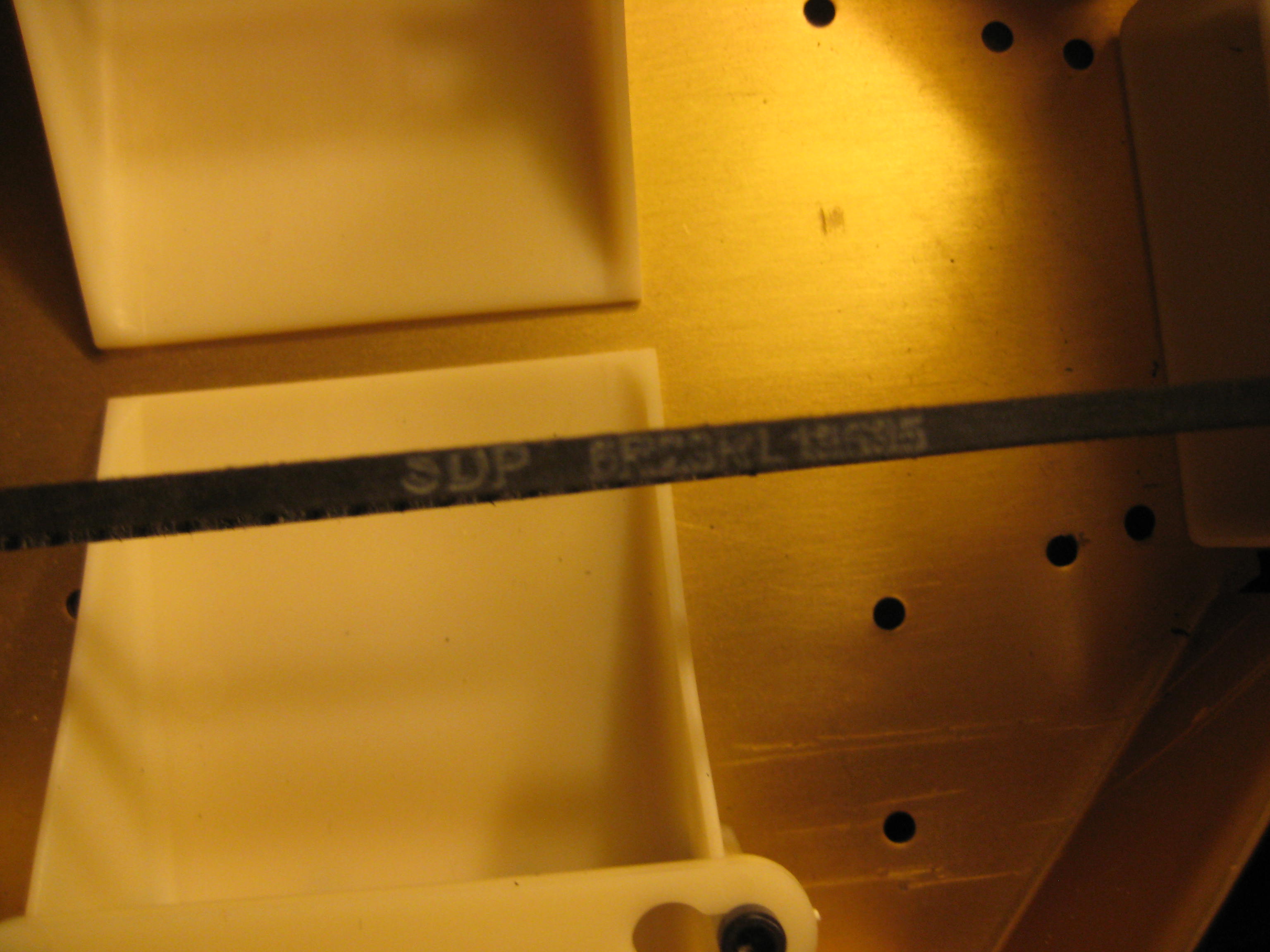

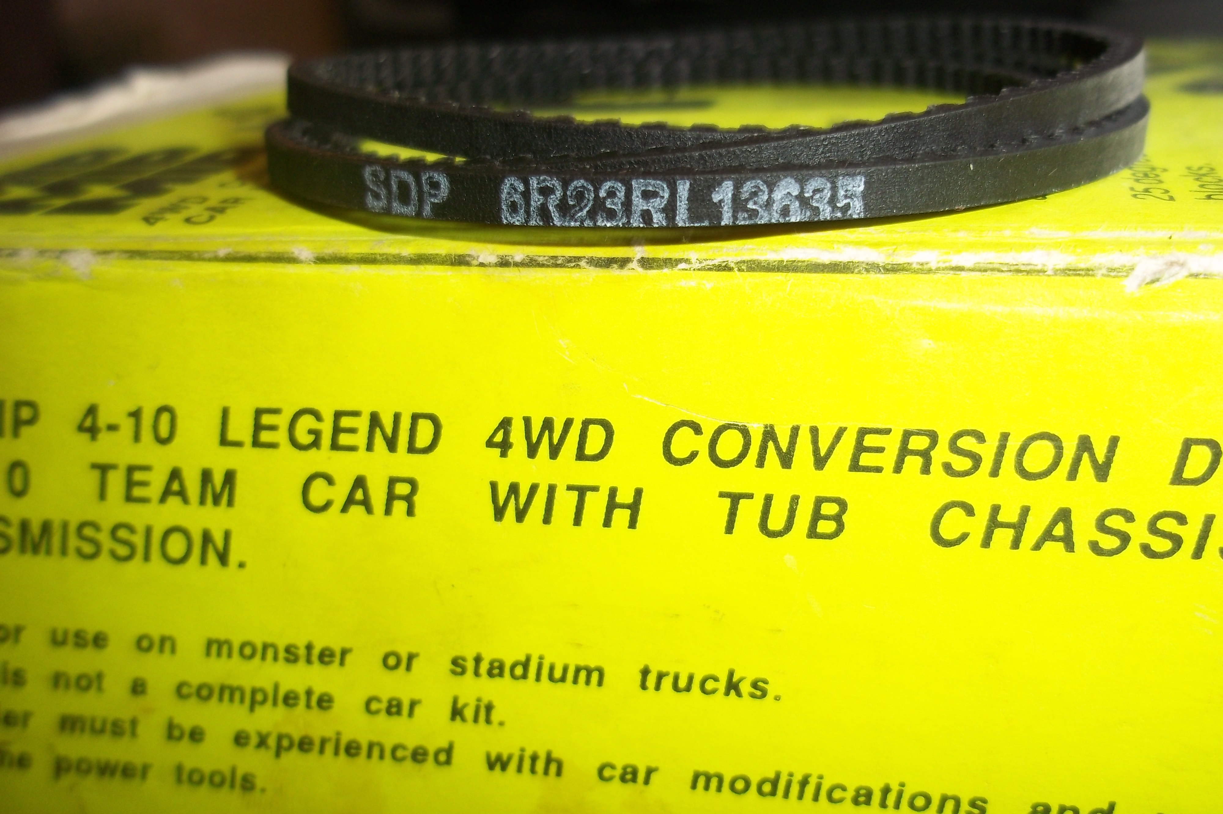

Hi.. I've got an rc10 with the SP-2 4x4 conversion. Where can I get any kind of replacement belt for it. Thank you

I sent a message on Facebook to aip47-2008 asking if he knows what belt is used, I can't make out what the number is on the belt of my SP-2 car and he knows or has info on it I would think.
