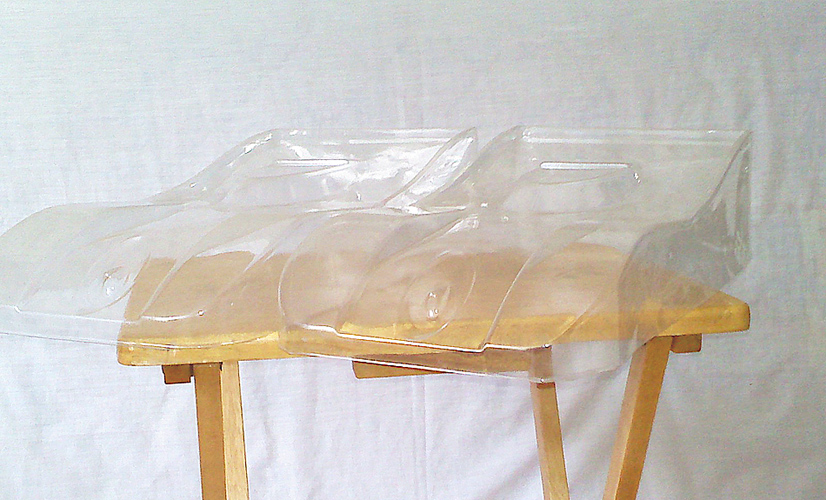

This RC10 dirt oval isn't that more interesting build, but I got tired of just lurking here, and after some time in limbo on what to build, I picked up a couple of NOS Premier/Twister Batwedge bodies on eBay and decided to put together a banned-for-racing (since I won't be anyway) late model car.

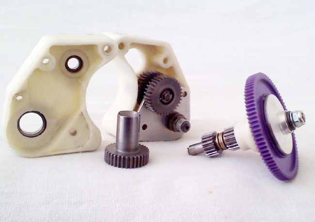

During the part collecting phase for my buggy build I picked up a new set of Thorp 48p outdrives, and then a spare 6-gear with chewed up outdrive cups to make a full metal 48p 6-gear transmission. It's also equipped with a new Jammin Jay Diff set.
My take on the bearing elimination mod replaces the brass tubing that goes over the outside of the outdrive cup with a filed down aluminum spacer, from a 3/16" MIP CVD axle set, on the inside of the outdrive. Spins much smoother than the stock two bearing setup and should get even better when the new bearings get broken in.

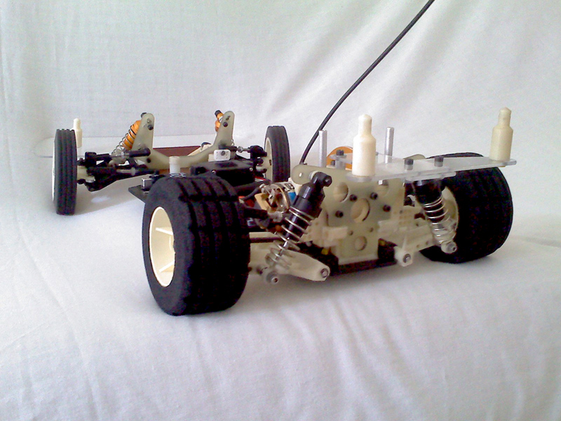

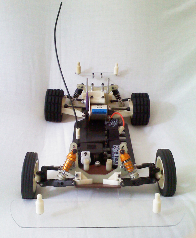

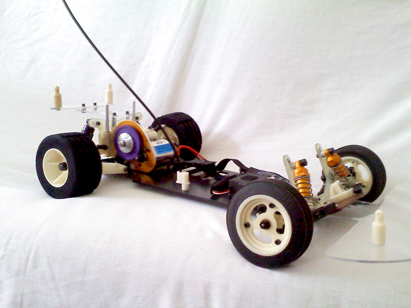

And finally pics of the car itself.
Rear arms, front wheels, carriers, towers, tran case, front shocks, knuckles, and bulkheads are all from my original RC10. Front arms are new, rear Bolinks, MIP shocks, MIP CVDs with 1/4" axles, 0 degree mounts, 15 degree caster blocks, and offset chassis are all parts I picked up from donor cars. The nose I chopped off of a graphite sprint car chassis that had a chewed up rear end, and the bumper and rear body mount I cut out of .93 lexan from the Home Depot. The MIP shocks on the rear will, more likely than not, be coming off as I had them earmarked for another build I have plans for, and the the front shocks will have to be rebuilt. Besides that what I still need to do is get a matching set of front Bolink foams (and apply silicone to them since this is a banned-for-racing build after all ), paint the nose (which I'll do when I paint the body), and figure out a steering solution. Can anyone tell me if the CW steering rack will mount up on an RC10? If not I'll go for a B3 set-up since I want to keep the servo mount as it is in the photos.
