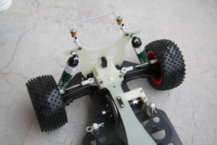

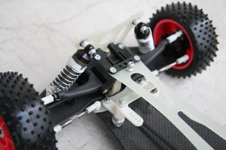

    Update for this project, I spent some time today cleaning up my shop so I could look for some parts for other members. But since I had some table space after the cleaning I thought that I might get some work done :roll:
    I made the steering brace from black g-10 and the steering rack from fiberglass like Masami's actual car
    and also change the RCPS links to shorter ones ( because of the steering rack ) and changed to black ball cups as his car was

    Very nice car. Anyone know why Masami had a steering rack on the car?? Reduce bump steer? or just to make it complicated?
    Posts: 8921
    Re: Masami WCS 93 replica UPDATE 6/2/10
    The only thing that this rack does to this car ( bump steer and didn't change ) is speed up the initial steering movement because of a little mechanical advantage from the "swing" of this particular rack-Seeing how he always overpowered his servos to get more speed anyway-the increased speed is my best guess :wink:
