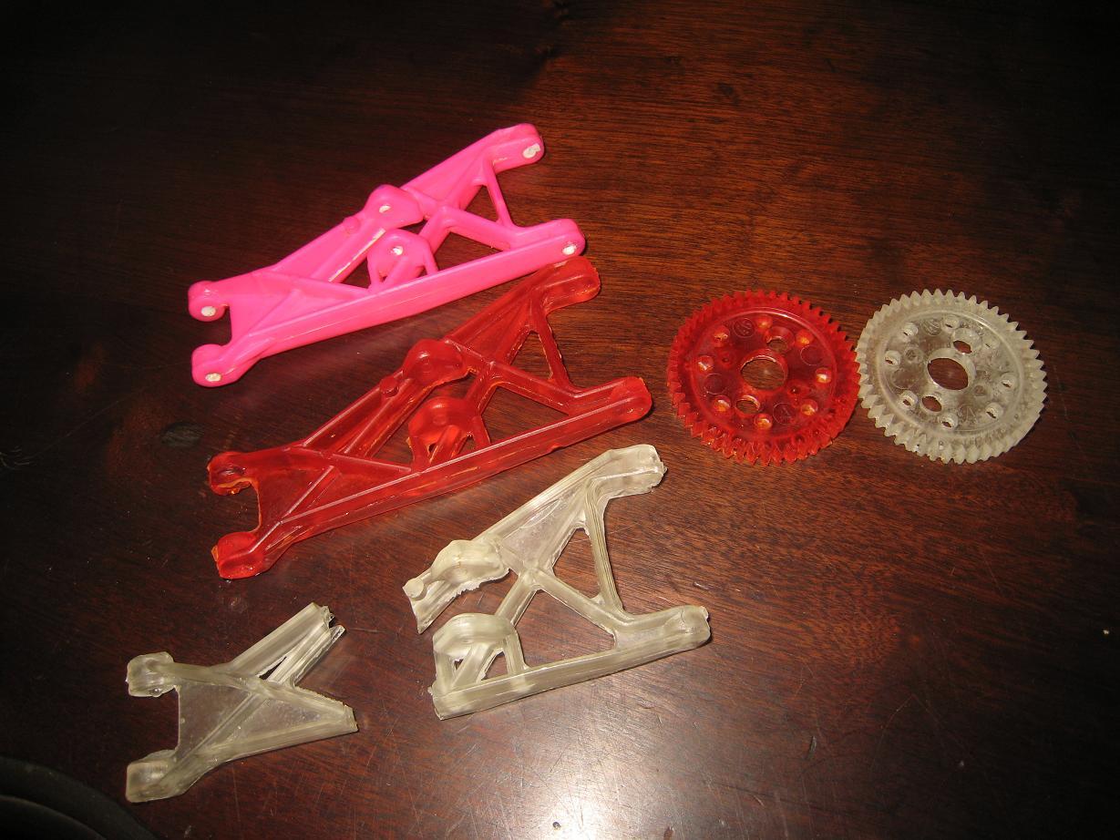

Wasn't sure where to put this but since I'm interested in making some RC10T parts it seemed best to put it here.
I think this is most useful for vintage goodies that are out of production but there's scope for all sorts of things:
Here's where I learned the basic technique:
http://www.youtube.com/watch?v=LSH19G_6Yeo&feature=related

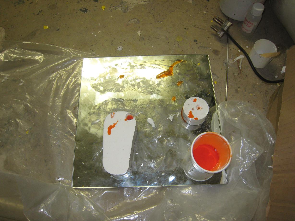

I use different casting materials because I live in South Africa and American products aren't exactly freely available over here. It's reasonably easy to do. I'm still experimenting with the concept. I will probably end up using some glass fibre to strengthen parts although it takes a lot of pressure to break the pure epoxy resin piece. I will also play around with resins that have different tensile strengths.
The nice thing about using silicon moulding resin is that once you have made your two part mould, you don't need to use a mold release agent for future parts (unless you try to cast a silicon part). Word of caution. If you are planning on painting your part, do not use a liquid silicon release agent during mold construction, rather use wax.

TIA (this is Africa) I can buy RC10T parts on e-bay as cheaply as you but it costs a buck to get here and takes 15-30 days USPS international. That said casting my own parts will be more expensive than buying (combination cost, time, effort). It's fun though.
The best part of this is that I could potentially carve a unique part out of some soft material like wax and then cast a female mould of it and make resin copies. Custom mods within easy reach of the imaginative rc car guy!

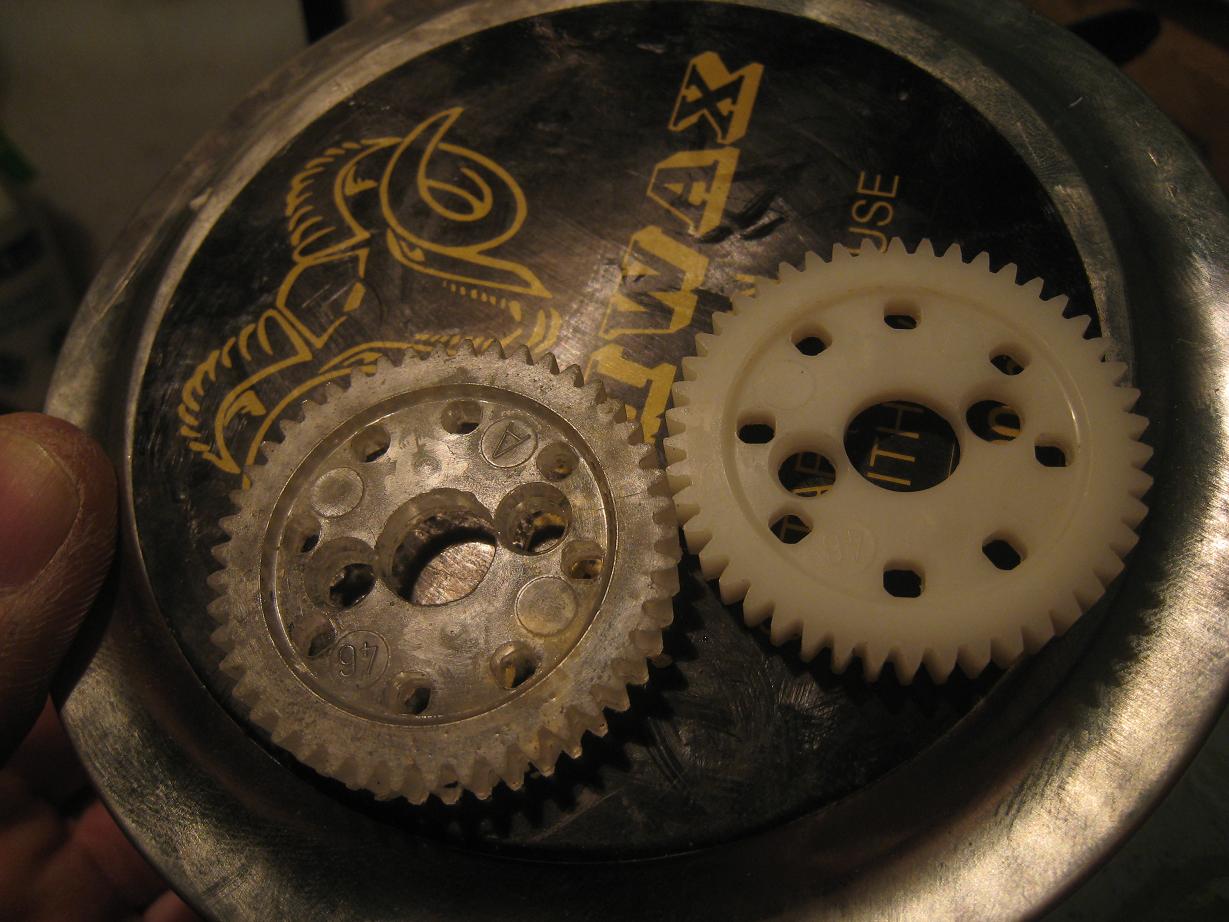

One thing you want to look out for when casting copies of parts is that the material shrinks as it cures, so the new part will end up being a few percent smaller than the original. There is a link to a Japanese site on here about making copies of a buggy body, and the end result was a few millimeters shorter than the original.
Might not be a huge problem, as long as you don't use a copy of the original, or a copy of a copy, to make a new mold when the old one wears out.

have you tested any of your parts on the car yet? I wonder how those arms hold up versus stock.
- Drusky
- Posts: 61
- Joined: Thu Jul 23, 2009 5:51 pm
- Location: South Africa
Re: Make your own parts
Nothing tested yet, I have decided to remake the a-arm mould with a difference that will make things a little easier, I will post a pic once I have been successful.
I know:
The A-Arm was lighter and stiffer than the stock part.
I'm pretty sure:
You can't beat nylon for tough, impact resistance not with epoxy resin only. Using some glass fibre may improve the durability of the copies but will also increase the PITA factor. Ideally I must find a tough nylon like resin.
I know:
I'm pretty sure:
