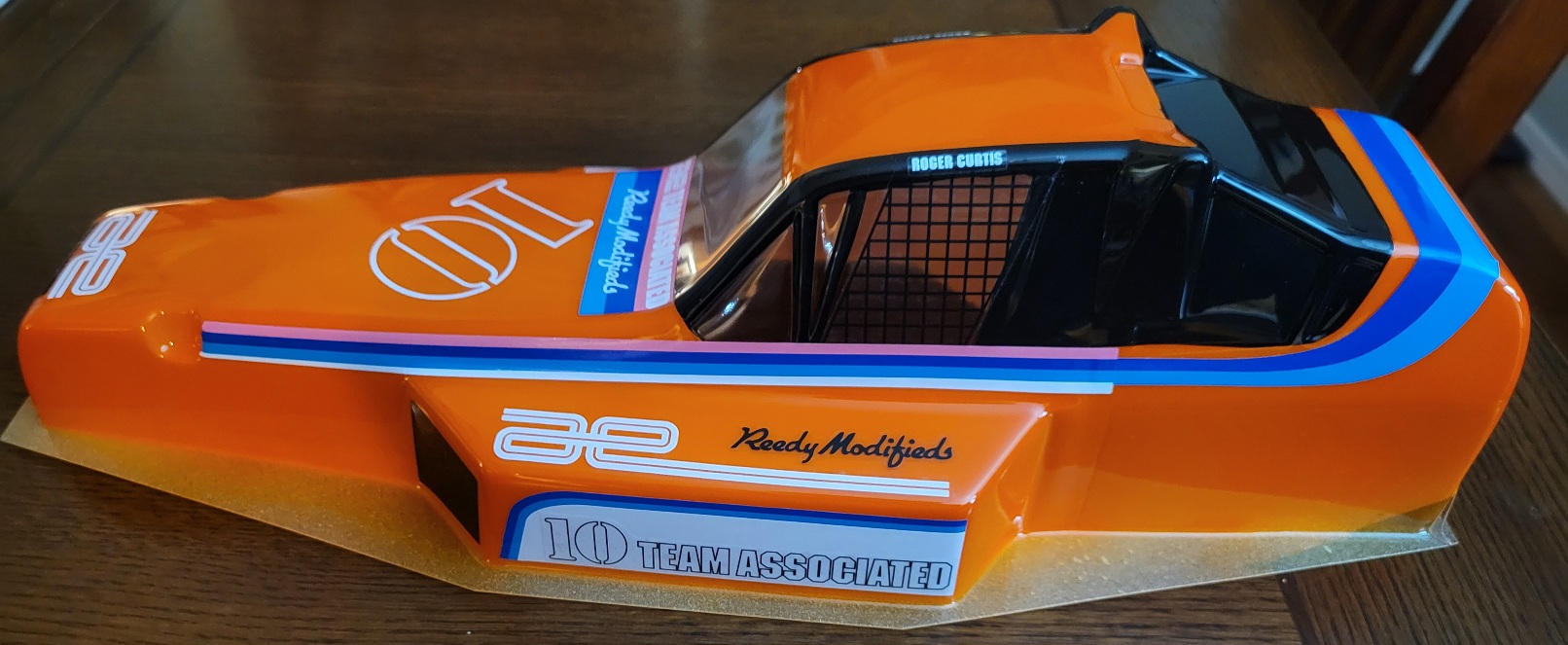

Closer look.
The red/white arrow points to the location on the boxart body where the decal is too wide, and it won't stay stuck to the body. The red arrow shows how the decal bunches up in the rear corners.

Here is one of mine I have done and the decals have all stuck just fine.

That's some nice work, Mike. It looks great with the CC decals.
Anyway, you just can't beat painted stripes. :D
For decals, I just warm the vinyl with a hair dryer, then press and hold them down tightly with my thumb while the vinyl cools and they will stay in place.
