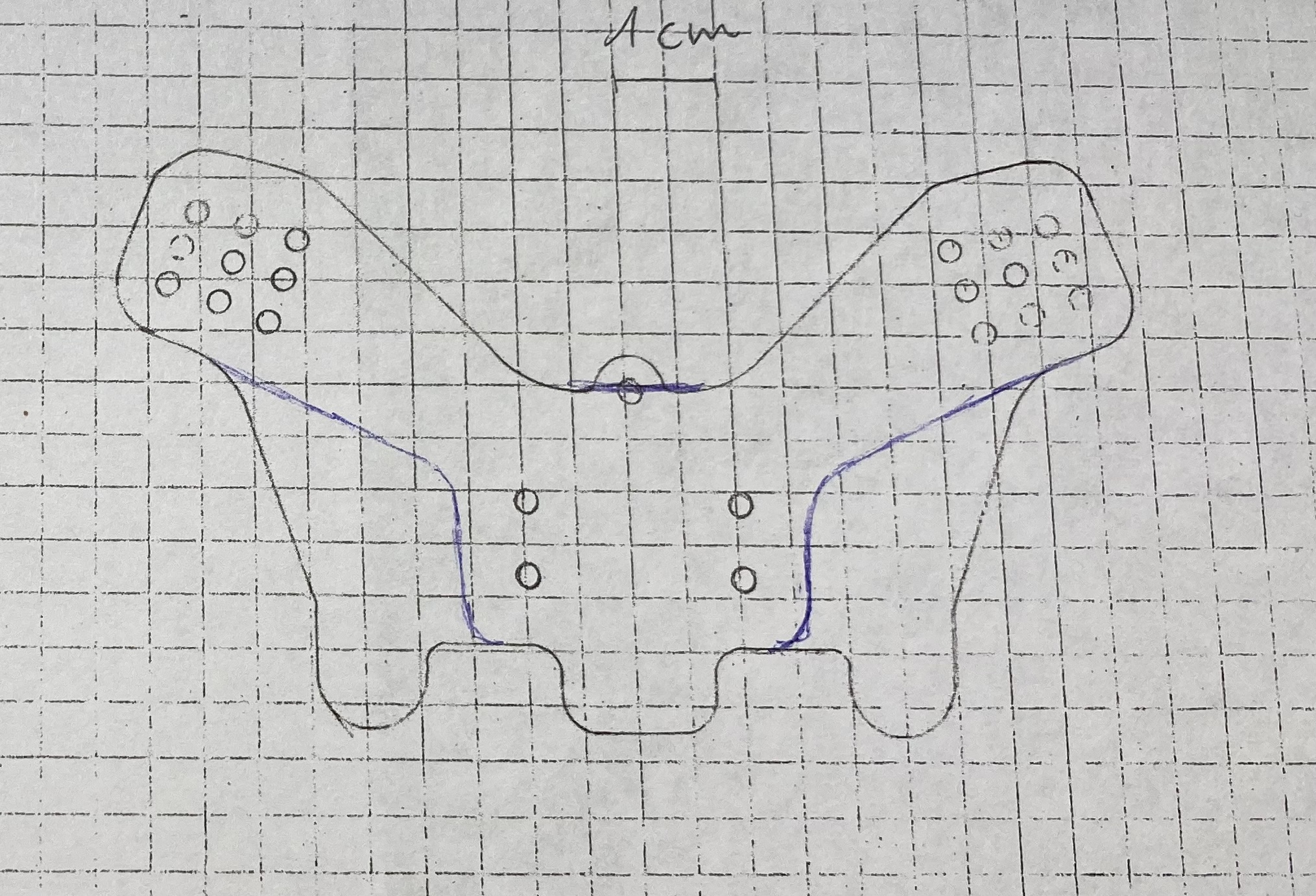

Now i mounted the rear GRO white bulkhead, and started to work on the shock tower.
My friend Philippe helped with the template, and i opened the NIP Storm tower, and started to dremel the tower… (bit sketchy tbh.. 🫣)
Again, very happy about the result!!

Well… here i am again, this time i hope i can write some more detailed information about some parts, and the actual start of the build.
As said before, i have been collecting the parts for about 2 years, and two months ago I started this build (see report 1).
