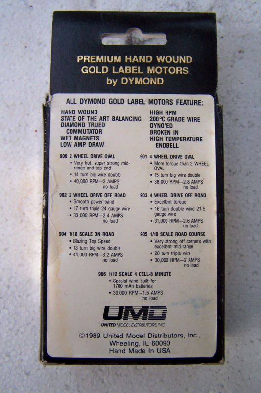

Yes, Dymond was brought to the USA by UMP. Does it have any colored dots on it?

Re: Anyone Know Anything About This Motor?
I will have to look closer but not that i recall. It does have a white sticker that says 902.gomachv wrote:Yes, Dymond was brought to the USA by UMP. Does it have any colored dots on it?

My LHS used to run these motors for the "stock" and "pro-stock" classes, bitd. We referred to them as the "Gold Diamond". I always had good luck with them. It had been thought, in later days, that these motors were "hotter" than 27 turn stock motors, however, I had never been provided any evidence. I have one now, on display in its original plastic tube. I'd be curious to find out more about it, too! (Sorry I didn't really provide any useful information about it. )
Ok just found it....

I know this thread is 6 years old, but I just bought this exact motor from the OP. Thought it was pretty cool.
