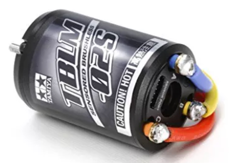

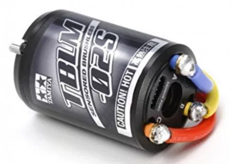

Re: 17t Goolrc in Zerda overheating ?
I had just seen this a couple days ago, and thought they would be perfect for cars that won’t accept a traditional brushless style motor. Tamiya TBLM series
Factory Works website
Both look like possible answers , I'd lean toward the Tamiya motor on price and clearance for the wires , the combined motor/ESC would need careful measuring to be sure it would fit . It will have to wait now for anyway untill the holidays are over as most of my spare cash will go on entertaining the kids .
