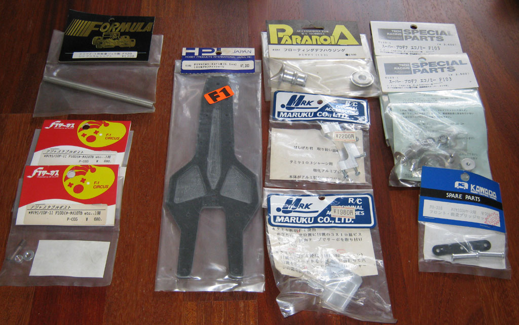

That is interesting. I have never seen graphite F1 parts like you describe. Over the years I collected a bunch of NIP parts for these cars. The graphite parts all have a weave pattern in them. On the FRP parts I can see what you mean about the edges appearing to be somewhat white in color.EvolutionRevolution wrote:HPI also made chassis parts from graphite without the CF pattern, which this looks like. Their FRP parts all are white on the edges.

So here is a fun one for you guys. I have discovered some rather unusual things about one of my F1 cars.
It is fun to speculate. What do you guys think?
- most of the graphite parts are thicker
- there are four extra holes in the chassis that appear to be factory drilled
- tiny hole at the very front of the nose
- tiny hole in front of the shock mount holes
- countersunk hole in front of the shock mount holes
- countersunk hole to the right of where the antenna mount would normally be (possibly because there is no antenna mount on this car)
- the servo mount holes are positioned farther forward (too far forward, in my opinion)
- the rear wing mount holes are not centered (they are too far to the left and make the wing visibly closer to the left rear tire)

They exist for the HPI RS-10. You have the FRP parts (white edges), regular CF chassis (pattern), and graphite (flat black/dark gray, like on a Trinity EV10; more expensive than regular CF). Then for the RS-4 they also have glittery graphite parts.ChisaiKuso wrote:That is interesting. I have never seen graphite F1 parts like you describe. Over the years I collected a bunch of NIP parts for these cars. The graphite parts all have a weave pattern in them. On the FRP parts I can see what you mean about the edges appearing to be somewhat white in color.EvolutionRevolution wrote:HPI also made chassis parts from graphite without the CF pattern, which this looks like. Their FRP parts all are white on the edges.
HPI also made a Tamiya F-103 chassis (that I have): 3.5 mm thick graphite (no weave pattern), milled to lighten it

HPI sourced at least some of the chassis material for their cars from DA Graphite and it was flat black/Uni graphite. Do an eBay search for HPI DA and you'll see a couple of pieces in packages labeled DA Graphite on the header card.ChisaiKuso wrote:That is interesting. I have never seen graphite F1 parts like you describe. Over the years I collected a bunch of NIP parts for these cars. The graphite parts all have a weave pattern in them. On the FRP parts I can see what you mean about the edges appearing to be somewhat white in color.EvolutionRevolution wrote:HPI also made chassis parts from graphite without the CF pattern, which this looks like. Their FRP parts all are white on the edges.
Most of the F1 cars I've seen are weave-type carbon fiber but the RS10GO and RS12G pics you can find on the web are graphite.

Here's the HPI graphite F103 chassis in all its milled glory next to some other vintage F103 parts.
