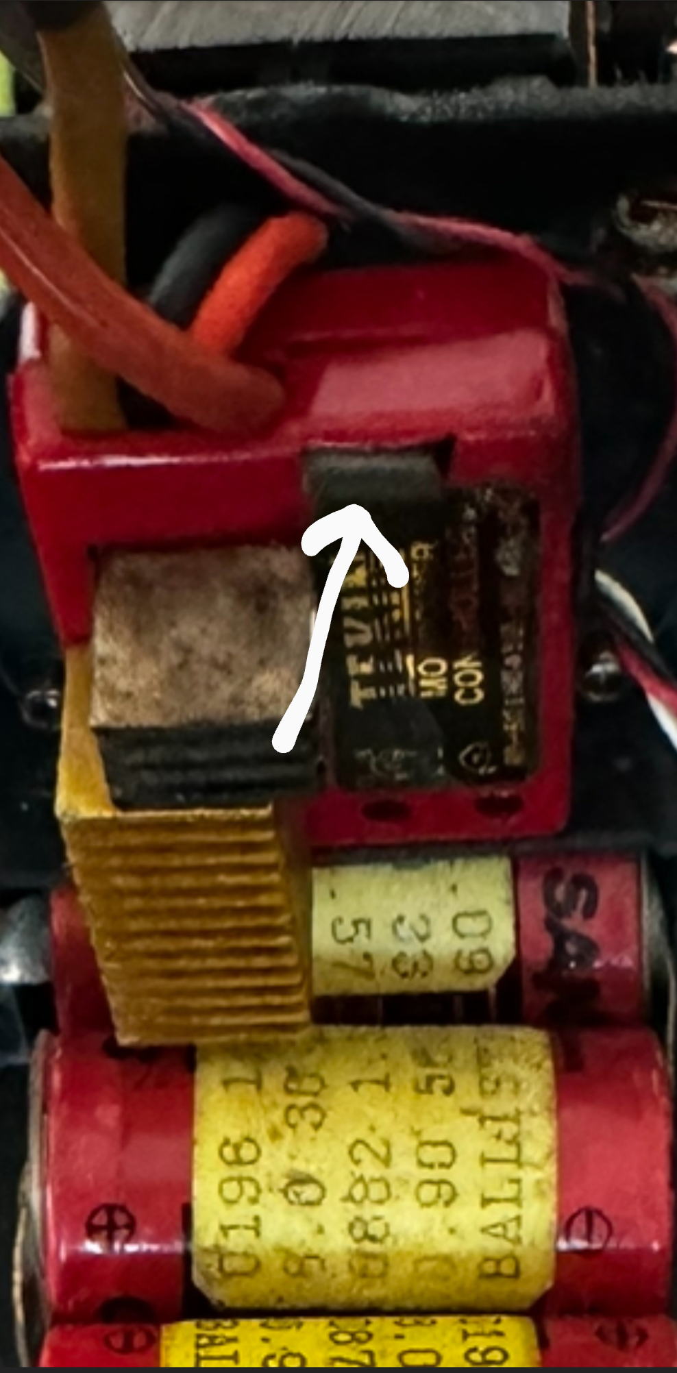

I’m trying to resurrect this old NiCd pack. Cleaned it up and gave it a few charge-discharge cycles. I remember these matched cells going for $60-$80 back in the day. Seems like it tops out at 800mah and it should be 1400mah. Any suggestions on bringing it back?

What is that?

Frankentruck wrote: Tue Aug 20, 2024 6:01 pm What is that?
Fuse? I remember they didn't always have the solder drop fuse.
