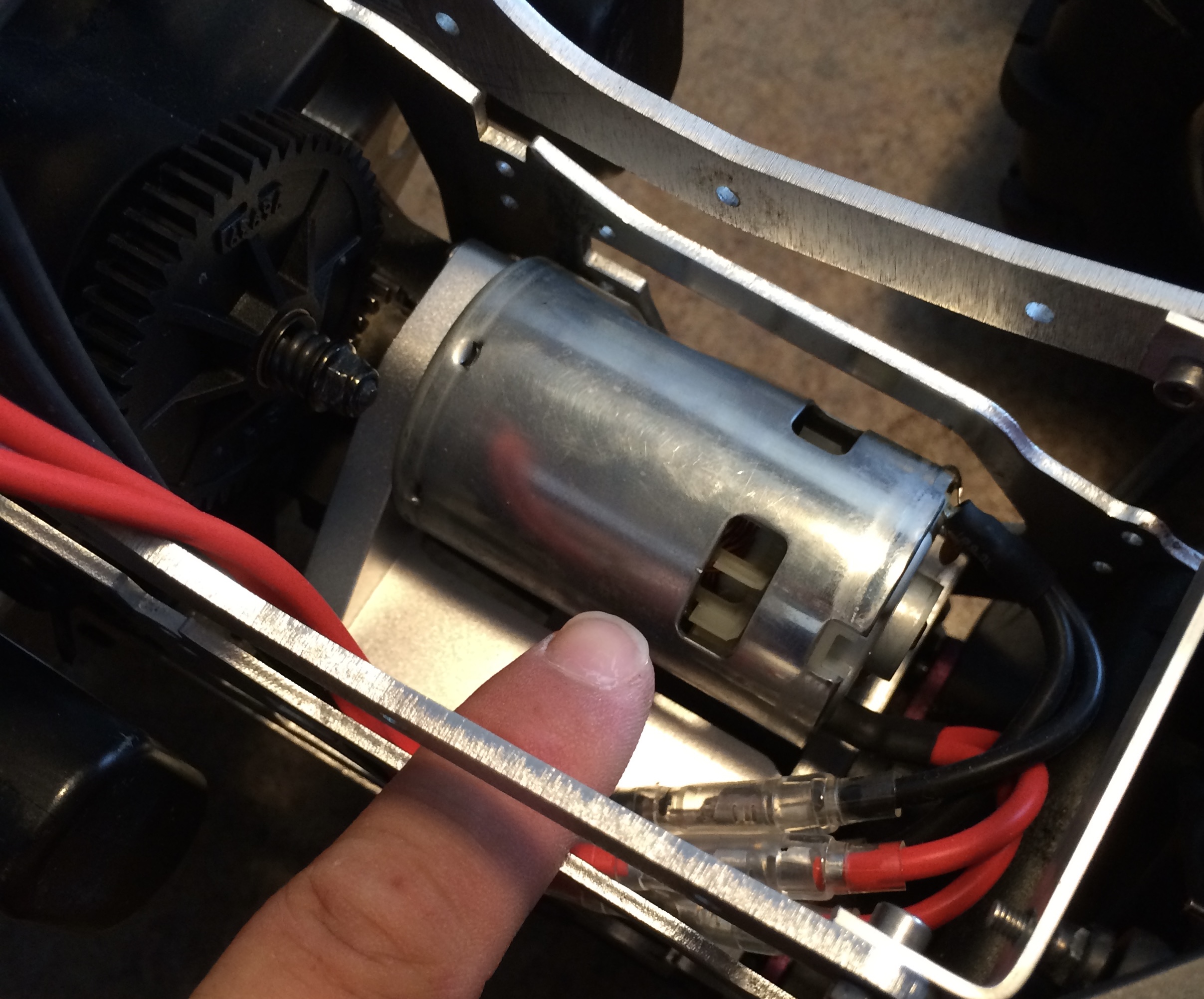

Yea I can attest to the fact that it’s one extremely robust esc for sure……
That’s also their single 775 motor in there.

by MarkyDents
I’ve got them in this truck, the cans are long. Not sure if they will clear your existing 4 link setup….
