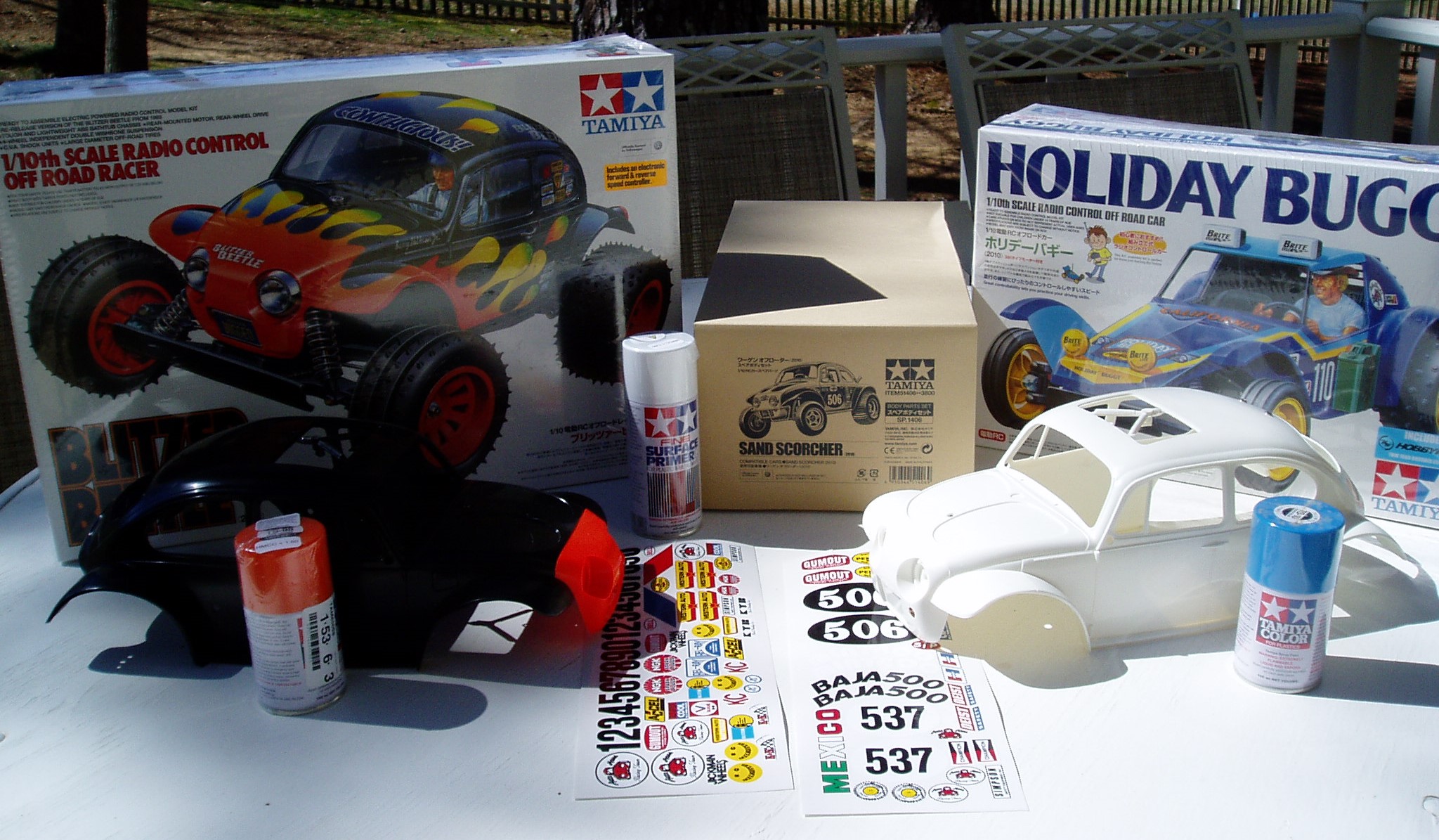

Anyway, a few months back I picked up a Blitzer Beetle and while building that car, I got the idea to recreate the Scorcher from my early years. Of course, the 2010 Sand Scorcher re-release kits are available again but this time I want to build the car around a lighter and more modern chassis with A-arm suspension and a gear diff, etc. I want something that looks like a Scorcher but with better performance. After considering a few different chassis options, I landed on the DT-02 – or more specific, the Holiday Buggy version. Had I been aware of the differences, I’d chosen the Sand Viper version instead. For only 50 bucks more, the Viper comes with oil dampers, adjustable camber links, metal out-drives, axles and dogbones, a 540 motor, and full bearings. It also includes a lexan body and wing that likely will fit many different off-road buggies in the collection. However, completely ignorant of the differences, I went cheap and got the Holiday Buggy – well okay, so be it. :|

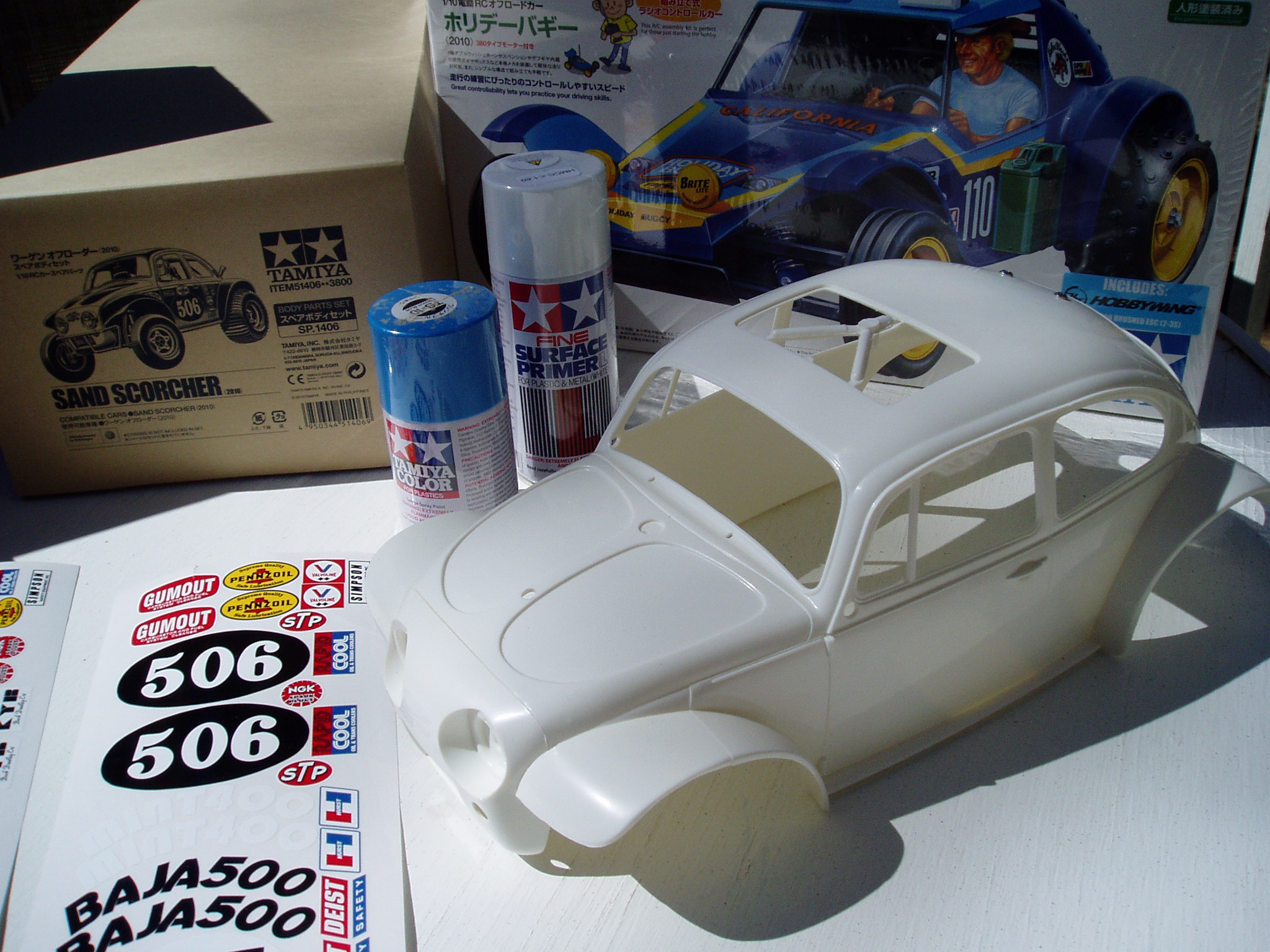

Some materials of construction:
So, the plan is to paint the Blitzer body similar to my old Scorcher (using TS-98 Pure Orange) and recreate the alternate livery shown in the back of the original SS manual using MCI’s reproduction decal sheets. The Blitzer chassis will be as standard – no mods.
For the Scorcher, the DT-02 chassis will receive new custom arms that will make the track width and wheelbase match the original Scorcher. The goal is to minimize chassis mods and alter the track and wb with arms alone. Of course, the body will be finished as close to box-art as possible using French Blue and MCI’s reproduction decals. I have a special modern 2.2 wheel and tire package in mind for this car that will pay homage to the vintage car (well, I think it’s special anyway :mrgreen: ).
The new DT-02 arms and rear guard assembly have been printed and the initial chassis mockup is nearly finished at this point. I’m just test fitting the printed parts, adjusting the "dampers" to get the ride height correct and sorting the body mounts. I’ll post more detailed info on that in a later update.
We’re approaching spring and with more moderate temps and low humidity, it’s time to get those bodies prepped and painted. Both will receive some body work, two colors plus clear and polish so this will take some time. I'd better get going. :D

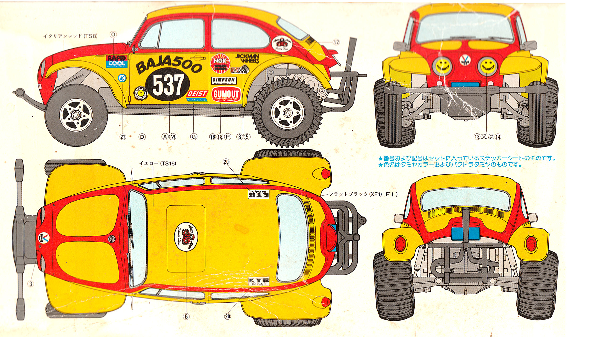

Here's the livery I'm going for on the Blitzer body except I'll be replacing yellow with orange and red with white. That's how I painted my original Scorcher.
I won't be using the decal sheets supplied with Blitzer.

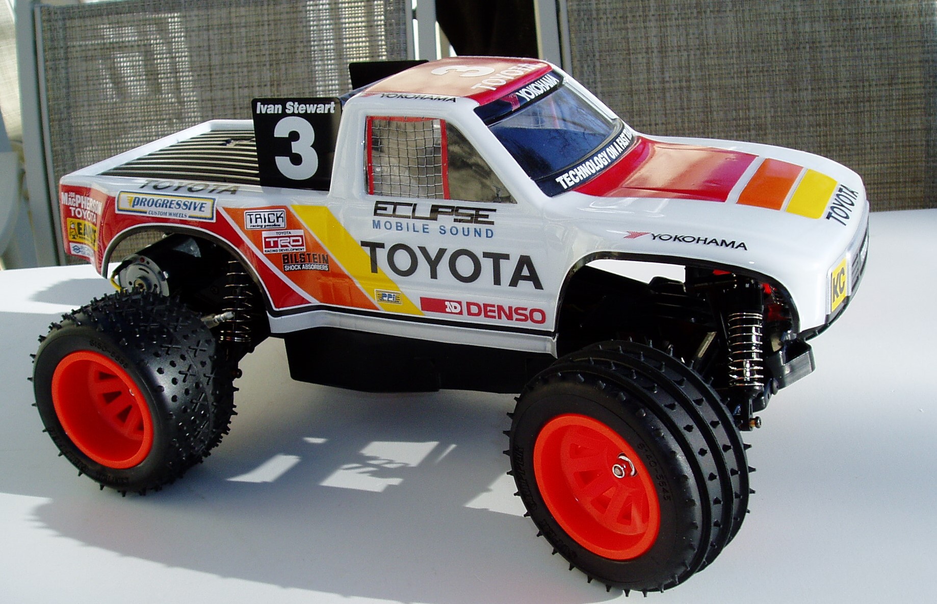

Ha. Nope sorry, no trucks here, this is “Beetle Mania”. :mrgreen:
But now that you mention it, I could easily do something like this since I have a Toyota body.
However, since the kit I have is going to wear an orange/white Beetle body, I would need to order another Blitzer kit to make a truck.
And, I probably should do that sooner rather than later while they are still available and before Tamiya discontinues them.
Then, I’ll have another Beetle body to use for a future project. :D

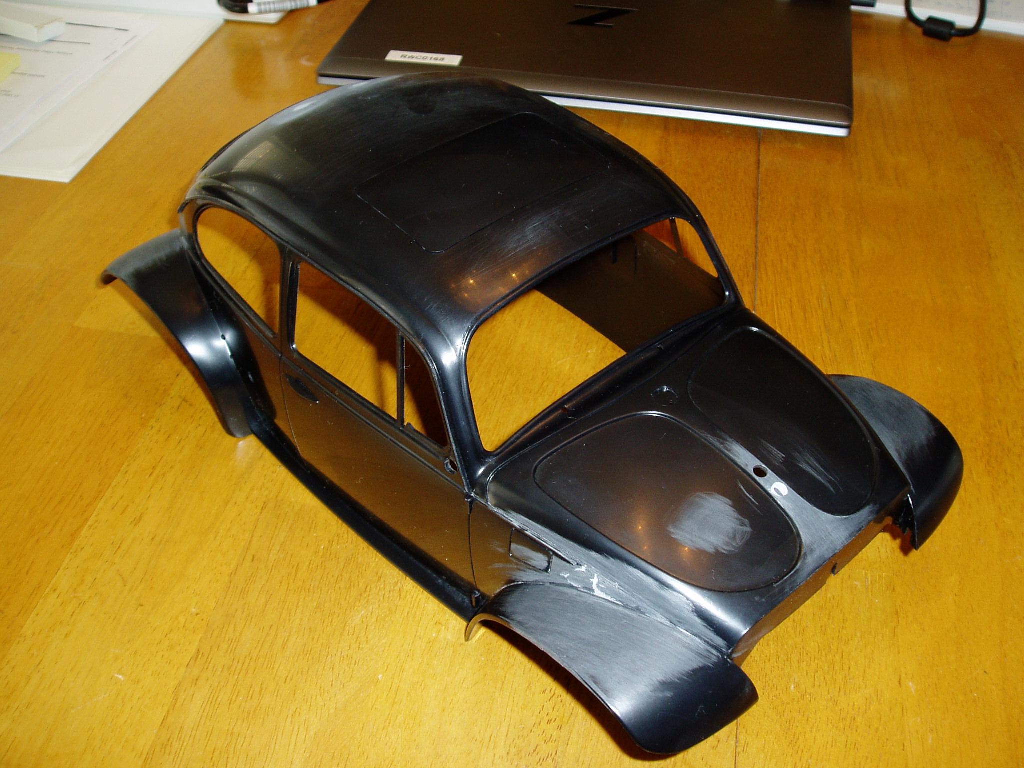

I've made some progress over the past week but I've been lazy about updating the build thread.

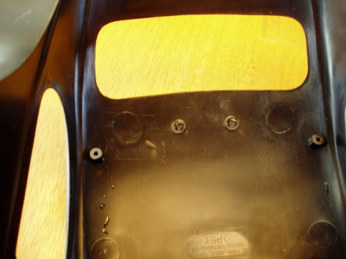

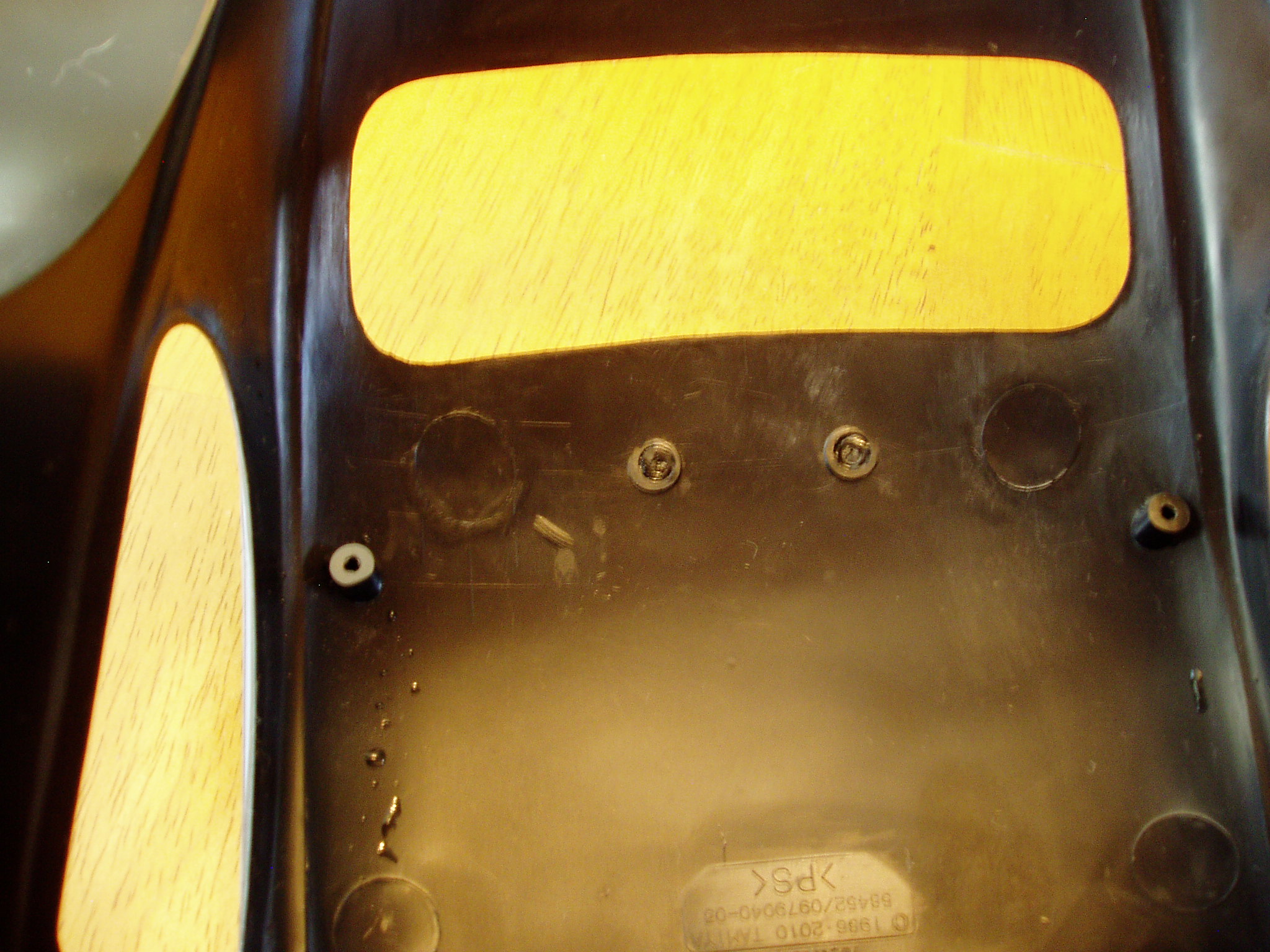

The unused mounting holes were plugged using some of the plastic sprue removed from the sun roof area...
... and I've applied some of Tamiya's filler and sanded them flat.

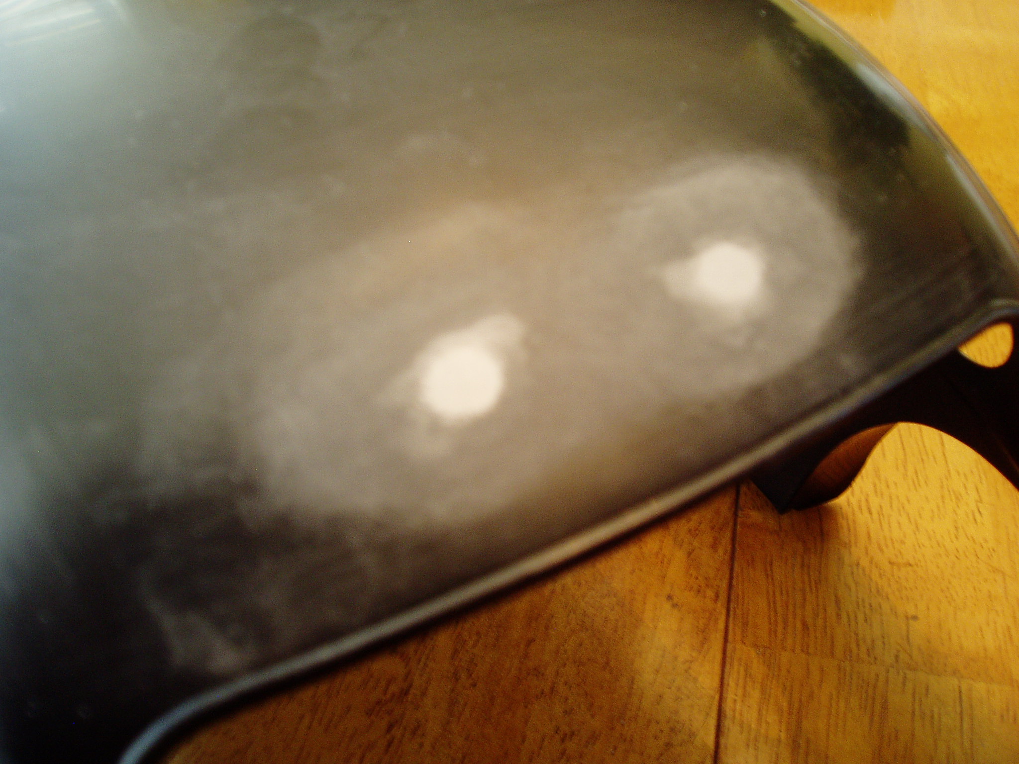

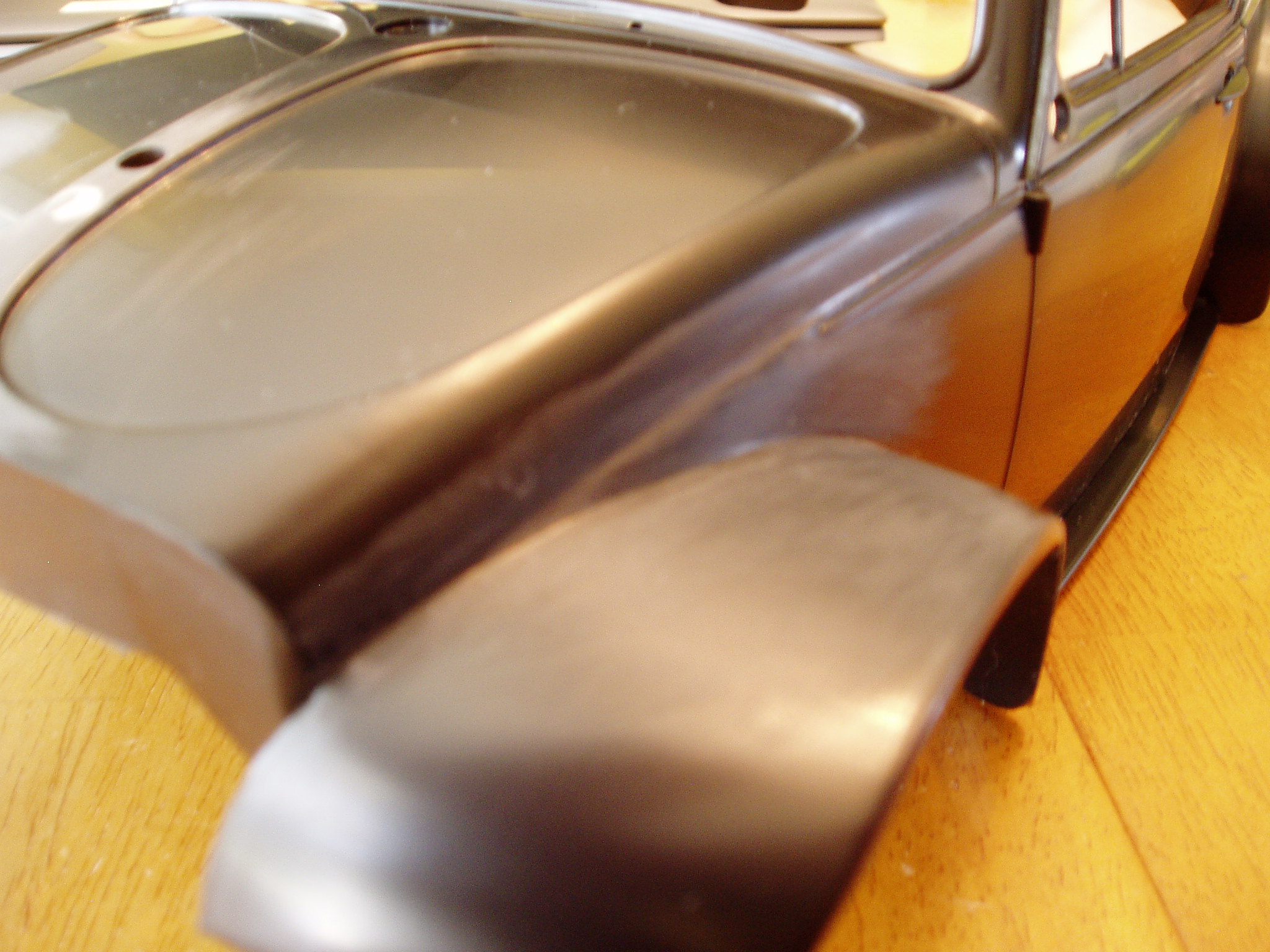

Next, the parting line flash has been removed. I find that rather than reaching for the sand paper first, it's more efficient to use an Xacto knife and draw the blade along the length of the ridge to remove most of the protruding material. Then, use sand paper to work the area flat (320, 400, 600, 800 grit). All four fenders have parting line flash and the fronts are especially suborn to remove.
I've glued the sunroof panel in place for this body. I didn't fill the gap because I prefer the look of a separate panel.
Next, the entire body has been wet sanded using 1500 grit, then rubbed down with a brown Scotch Brite pad to reach areas inaccessible by sand paper. Scoring the surface should give some tooth for the primer to grip. Since the body will be masked for two colors, I think it’s very important to key the surfaces so the paint won’t lift when the tape is removed.
The repaired spots will receive 3 initial prime coats to fill the sanding scratches, then the entire body will receive 5 additional coats. This should build enough thickness so the primer can be lightly wet sanded with 1500 to level the surface and provide tooth for subsequent coats of paint.

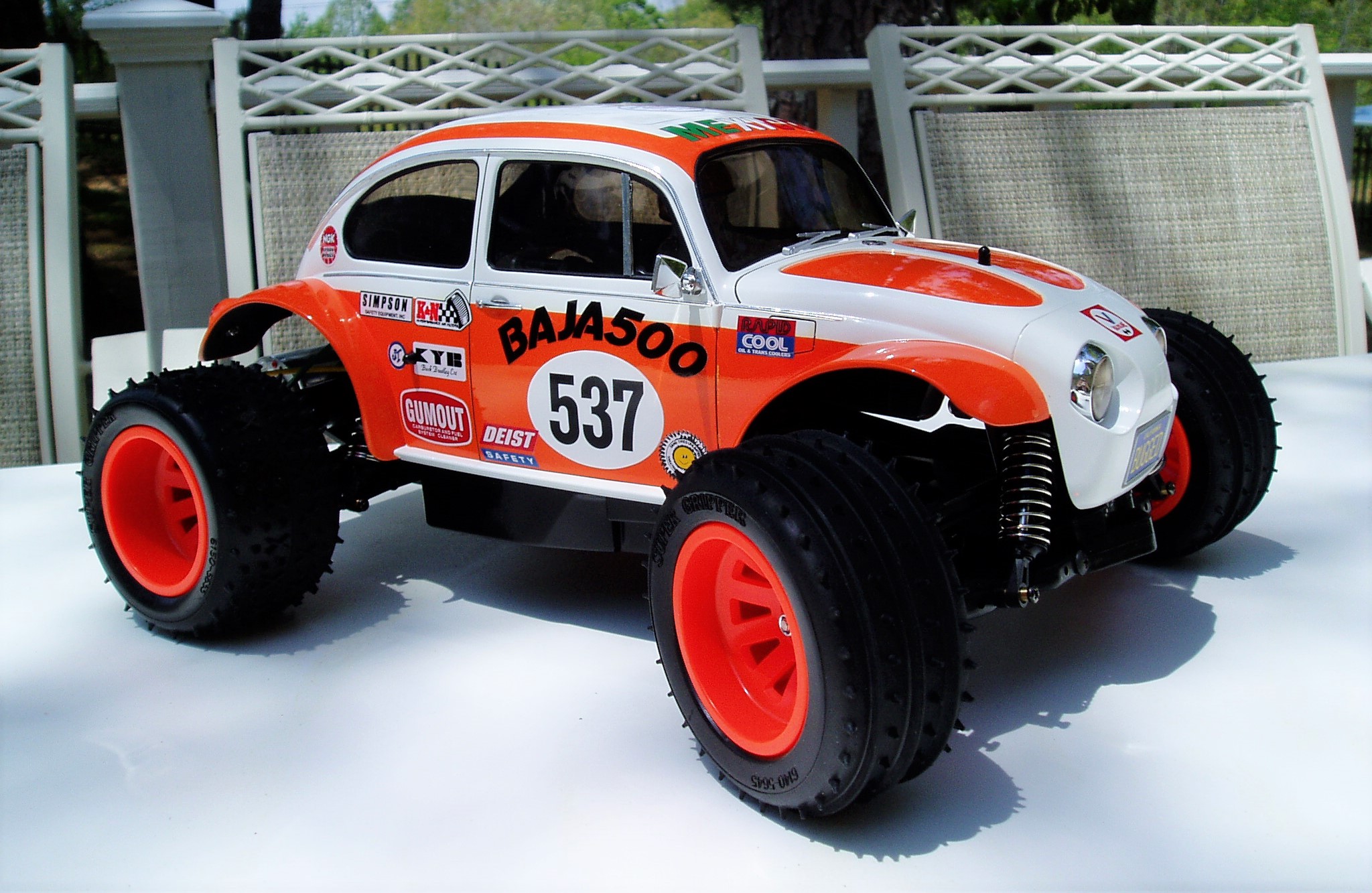

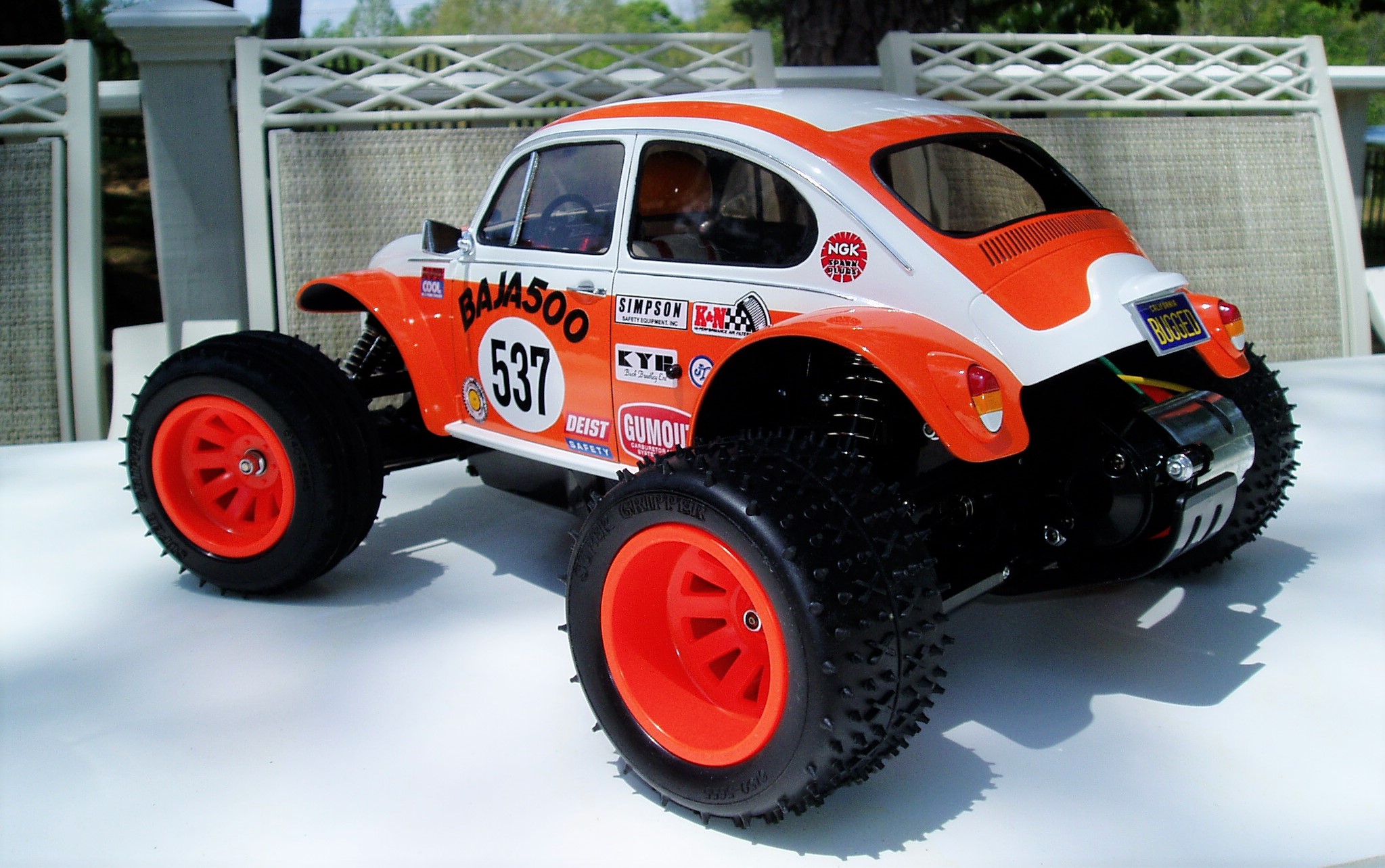

A quick update: the Blitzer is nearly finished. Just need to fit the bumper, Rx and ESC and it's ready to go.

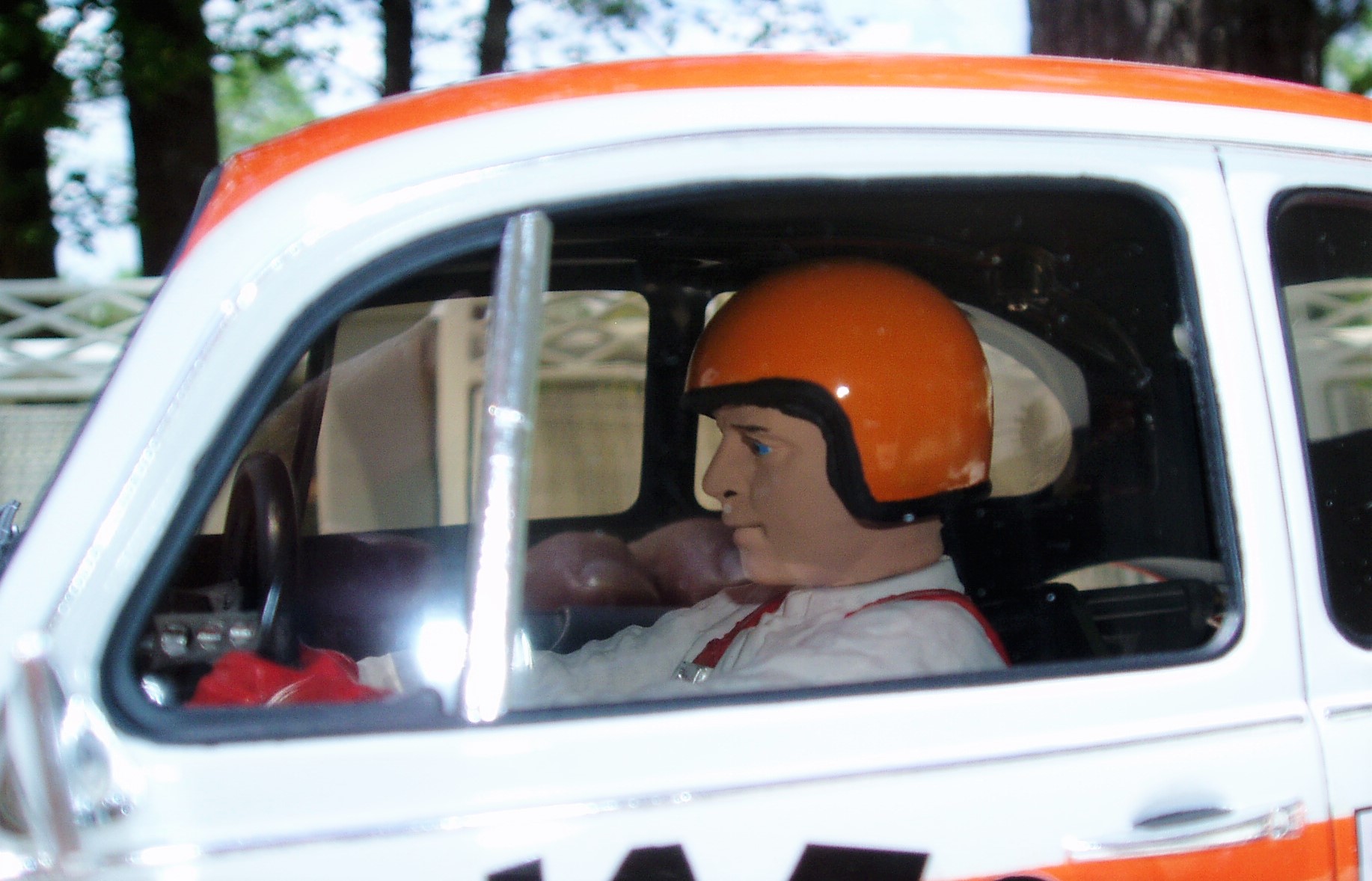

Moving on to the Scorcher body, paint work is complete.
Need to do the chrome trim, install decals, wipers, mirrors, driver, tail and headlights, etc. and body is finished.
I'm really happy with this one. It sanded and polished much easier than the Blitzer body. I reckon it's because this one sat longer after painting so the clear had more fully hardened.
Anyway, whatever the reason, it polished in less than half the time. :D
