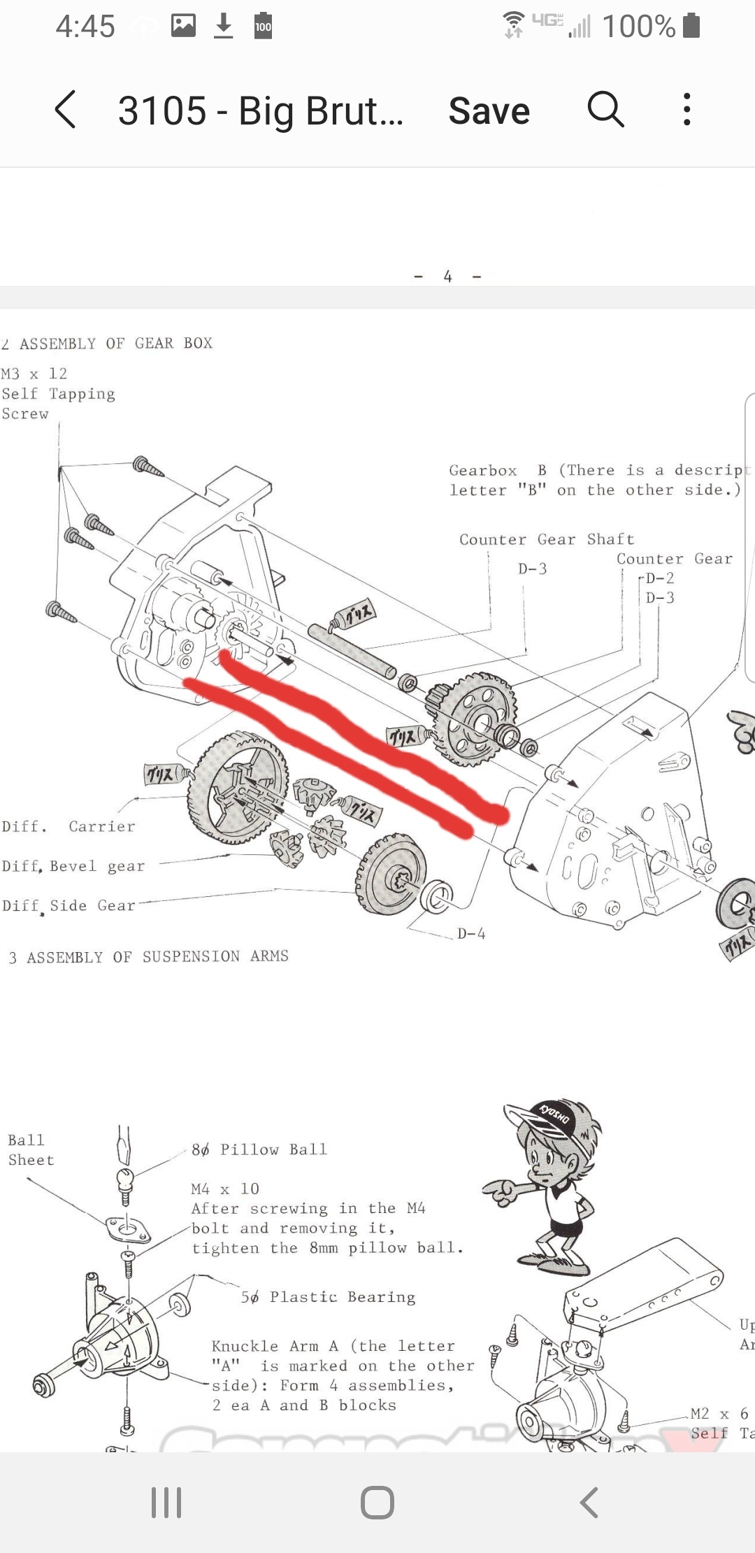

question from Nitro Brute thread:
The trannys are quite a bit different on my Nitro Brute vs your Big Brute. Yours just has a pinion gear/counter gear/differential gear. Mine has the input shaft coming in the back with a ring/pinion setup changing the direction of the gearing....big difference. I dont see anywhere those shims will work in yours. your best bet is to do like ole boy stated above and put those collars in place before the two halves of the case go together. 25mm long might be a good statting point. I highlighted in red where they go:

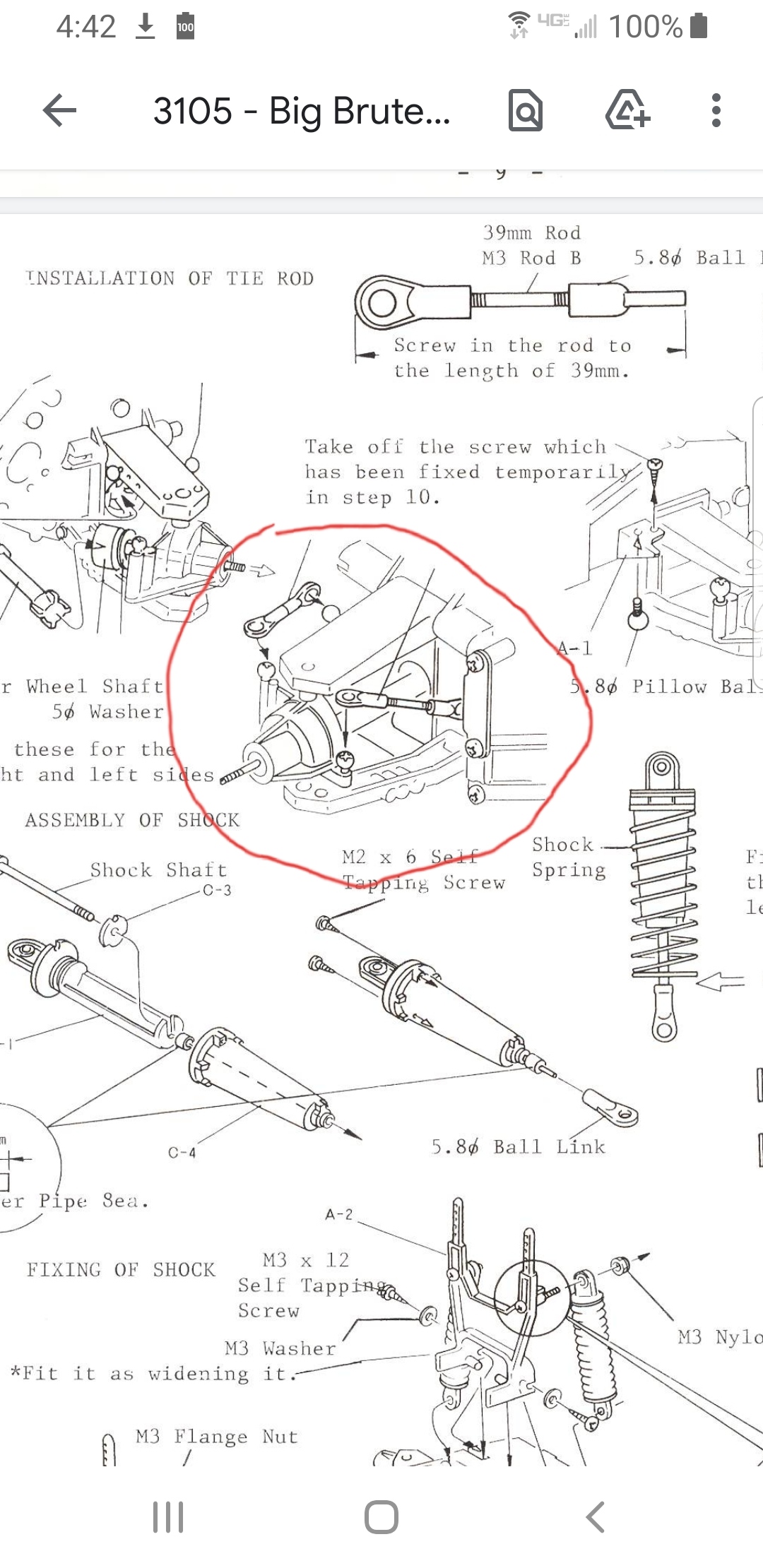

As far as that slop in the rear end, the manual calls for both rod ends like i have:
For anyone confused some questions were asked on my Nitro Brute thread

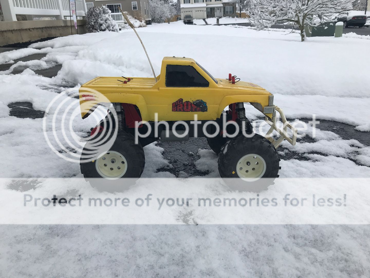

I though I toasted the trans today... my son was driving it in the snow and it was slipping a lot.... long story short I never glued the tires and they were slipping on the tires!!! Thank goodness! I took the whole transmission off the car and was getting ready to take it apart when I thought to hook the battery back up to the motor and give it some throttle to see if I could see the pinion slipping. The gearbox was tight! It was the stupid tires that came off the beed. Oh well… I keep learning!
The trans seems to be pretty OK now with me barely tightening up the screws and using some loctite
