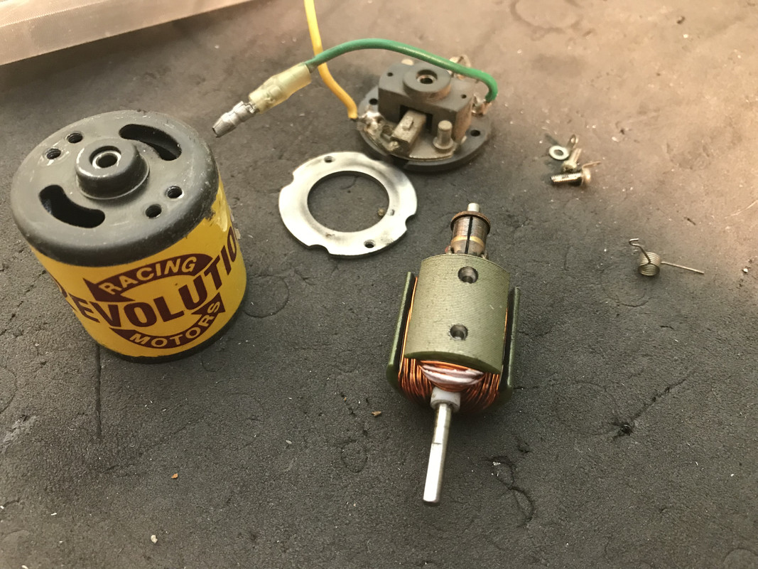

coxbros1 wrote: Sat Feb 06, 2021 2:47 pm Very cool! Gotta find out what Revolution it is....either a Killer, Brutus, or Insane
How do I tell?

"How do I tell?"
not real sure...hopin someone on here knows how.

coxbros1 wrote: Sat Feb 06, 2021 4:36 pm "How do I tell?"
Armature has a “1” or “I” on it with a white paint mark.

by coxbros1
Its a double turn, so its an "Insane" (15x2) or a "Killer" (14x2)...the "Brutus" which is the holiest of holy grails is a triple (16x3)
