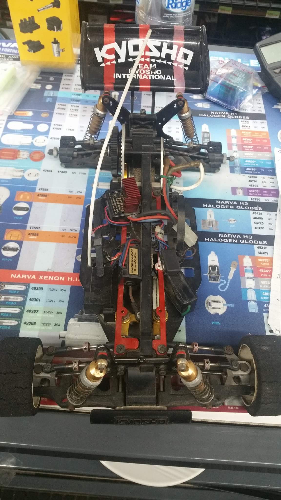

Seems all i see is threads about optimas :lol:

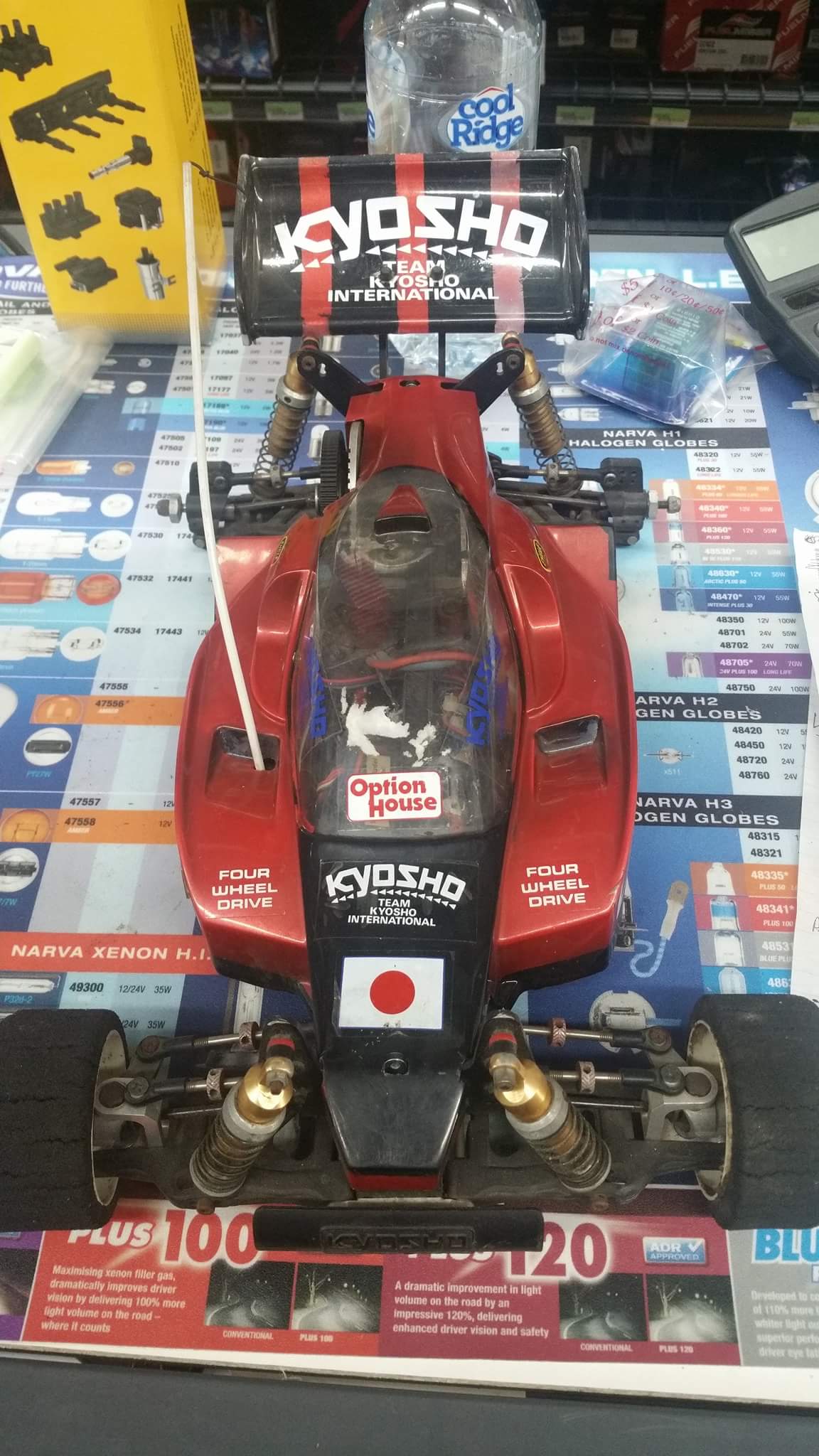

This car got advertised for a reasonable price on social media and i snatched it up.
Has been upgraded in Its life, hoping someone can enlighten me on which company did alloy upgrades.

Is that a Hong Kong style on-road buggy?

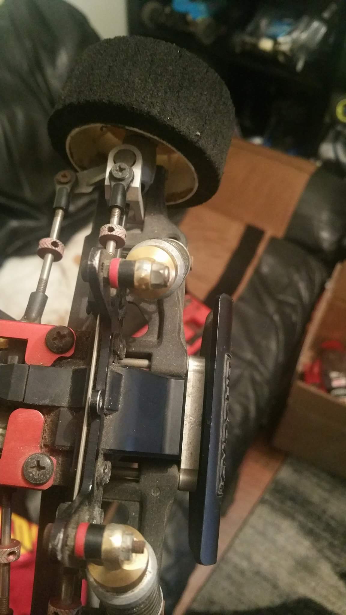

Think kyosho supplied the pivot blocks as they did do them, otherwise MMS , motor plate also MMS. Top deck i am unsure but think it might be wasp. Mind you im possibly wrong

Welshy40 wrote: Fri May 05, 2017 5:23 pm Think kyosho supplied the pivot blocks as they did do them, otherwise MMS , motor plate also MMS. Top deck i am unsure but think it might be wasp. Steering looks associated but unsure who made that. Mind you im possibly wrong

Really nice collection of alloy parts. Looks like a fantastic find!

The lot came with a invoice from Indonesia for some motors which are all labeled and dated in 1989.
I thought it came with some new universals but turned out they are niko brat unis!

Looking at replacing some items.

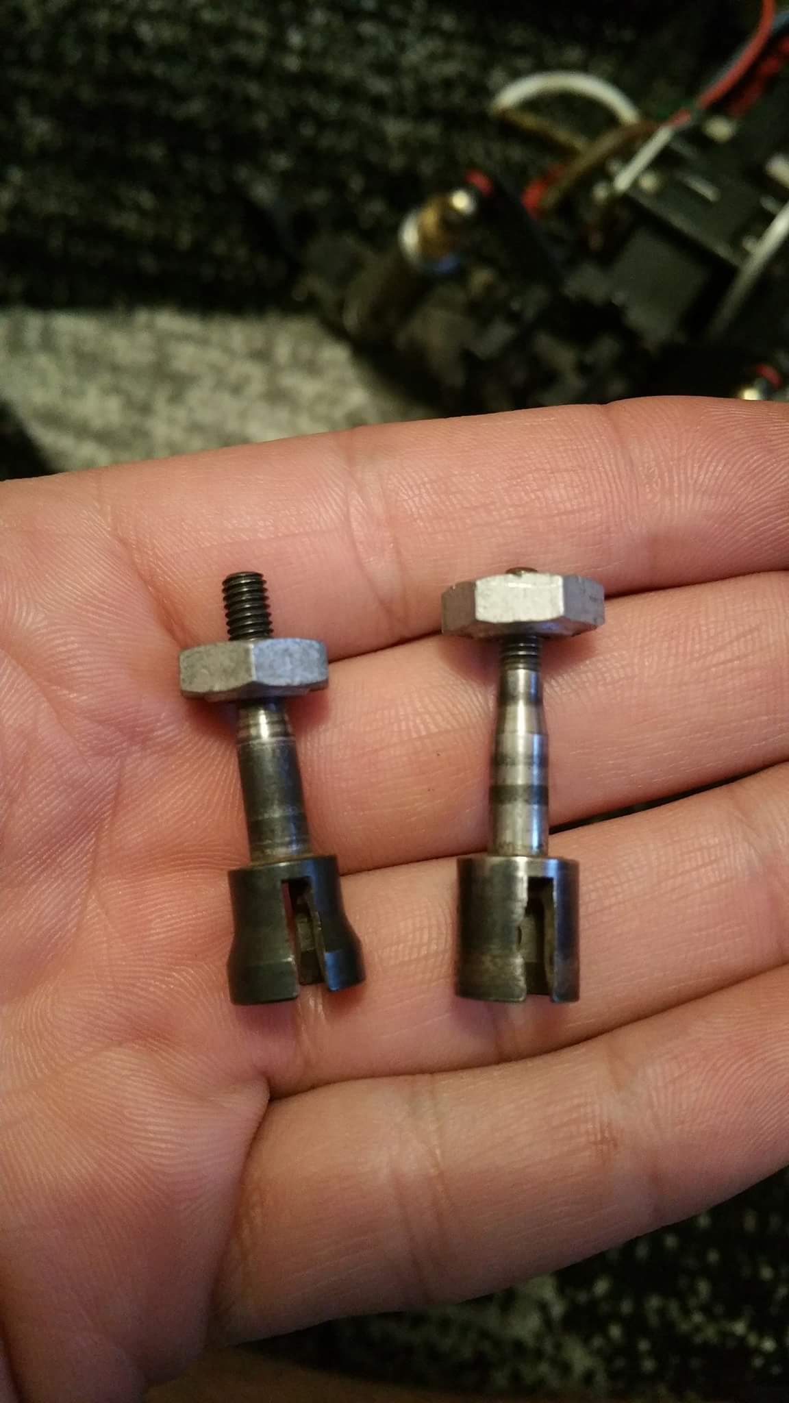

Rear axles, seems someone has used a front one? Seem to fit alright and are cheaper on ebay! But can someone comfirm it for me.
Also what part number is a shock rebuild kit?

Go onto google and search for retromodelisme and youll find a French site. Look for manuals listed top left and in that is the Lazer zx manual with part numbers. Tbh if shock shafts arent bent just replace the seals which you can easily find from kyosho.

Pk racing (corally) upperdeck from the Netherlands perhaps?
Front axles in the rear can help prevent binding when you have more than usual downtravel in the suspension. But more likely it's a spare used because of lack on rear spares.
