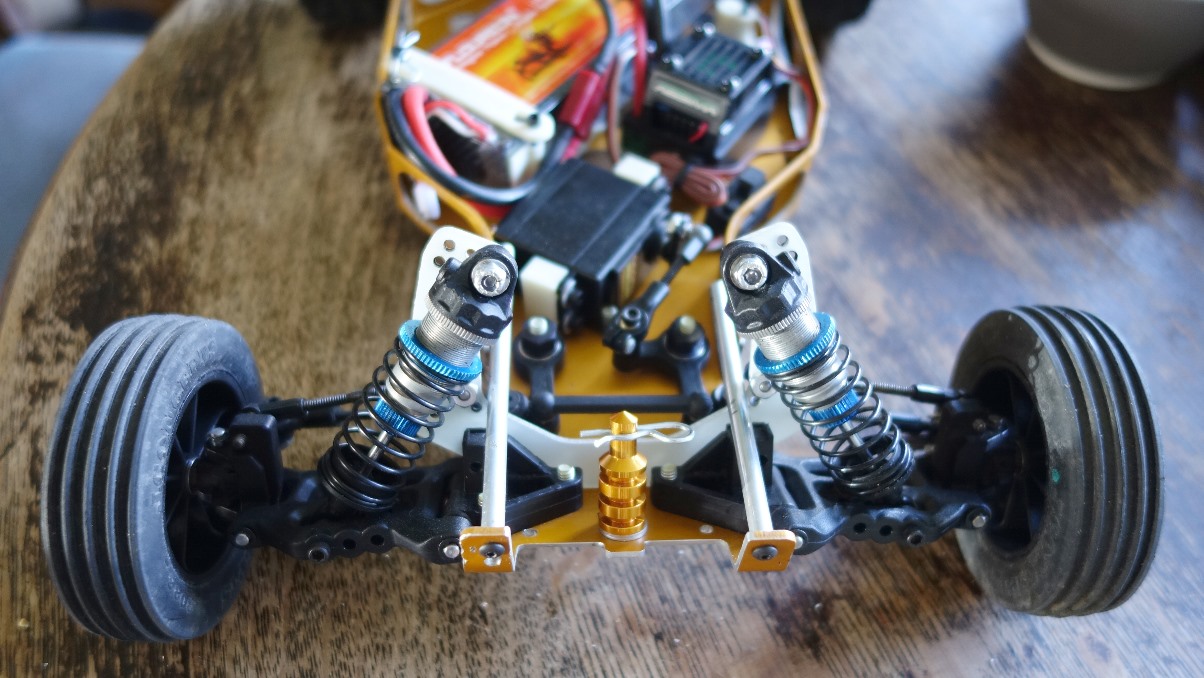

Martco78
Posts: 38
Joined: Mon Feb 22, 2016 10:48 am
Location: London UK
Re: Worlds car shock upgrade
Post by Martco78 »
Currently running B4 big bore shocks on my short wheelbase RC10 gold pan special. They go on just fine with the odd washer to improve shock tower clearance. Here they are on RPM arms which can give more throw through variable mount points and multi-hole towers can help to ease any close proximities. Using Associated 12mm blacks on the front and yellows on the back an it's all works pretty well.

JK Racing
Posts: 4618
Location: Placentia, CA
Has thanked: 129 times
Been thanked: 242 times
Post by JK Racing »
I run a longer front tower with mine as well, there are a few sources around where you can find them. I also spaced my rear tower forward and ran the big bores behind it. I found there was an odd bind as the suspension compressed that was reeking havoc on the track. After the change, could not be happier.

thodgez28
Posts: 46
Joined: Tue Mar 22, 2016 5:35 pm
Location: Logan utah
Post by thodgez28 »
Thanks for al the info you guys rock!
thodgez28
Posts: 46
Post by thodgez28 »
What shock towers are those? Where can I find them?
Posts: 12185
Has thanked: 1080 times
Been thanked: 3731 times
They are towers that I make. I have all the flavors- standard CE and Team, Worlds, and custom too that are all modified for big bore shocks and on the rears I modify them for modern wing mounts
You can pm me for details. i charge $15 for each tower plus $3 shipping. Here's my thread in the sales section

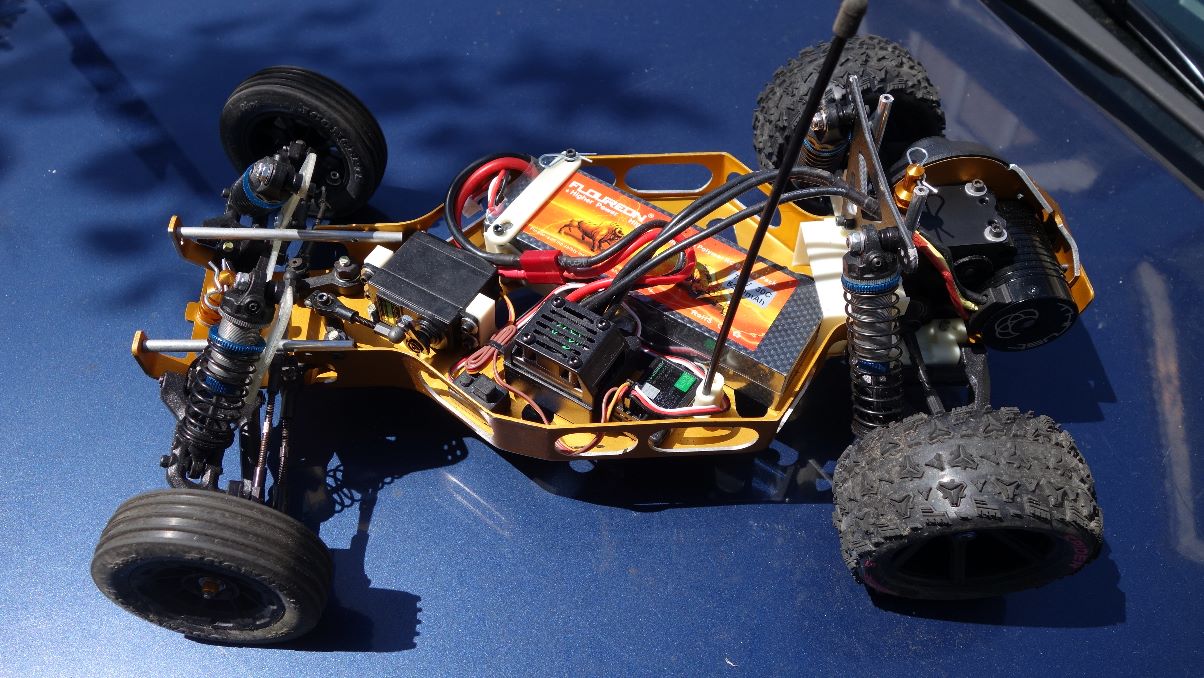

harvey
Posts: 176
Joined: Fri Feb 26, 2010 3:25 am
Location: British Columbia
Been thanked: 5 times
Post by harvey »
That is some tidy motor wiring!
JK Racing
Posts: 4618
Post by JK Racing »
Thank you...tucked the edge of the speedo into the battery cup, opened a hole in the top of the cup. Out the hole, through the bulkhead and to the motor. I've been getting more OCD about simple/clean/neat wiring as I get older.
