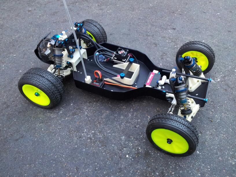

So I'm finally at the point of installing the ESC and receiver (servo is in) and I have a few options I guess. Could you post top down pics of your pan so I can see the different choices you've made for ESC location and wiring routes?
One thing that's binding me up a bit is the BEC wires off the ESC either rub the pan or the battery tray. They might be fine, but it puts a sharp bend in them which I don't really like. The ESC can't be turned 90 degrees from either of those options because there's not enough room between the battery and the pan.
Again, I'll post some pics but I'd prefer to see yours! Thanks.

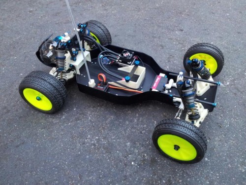

Here's some current pics with various layout options. There are even more new pictures in the other thread. You can see what I mean about the BEC wires being a really tight fit in between the pan or the battery tray. Right side of the car seems to have a few more mm clearance.

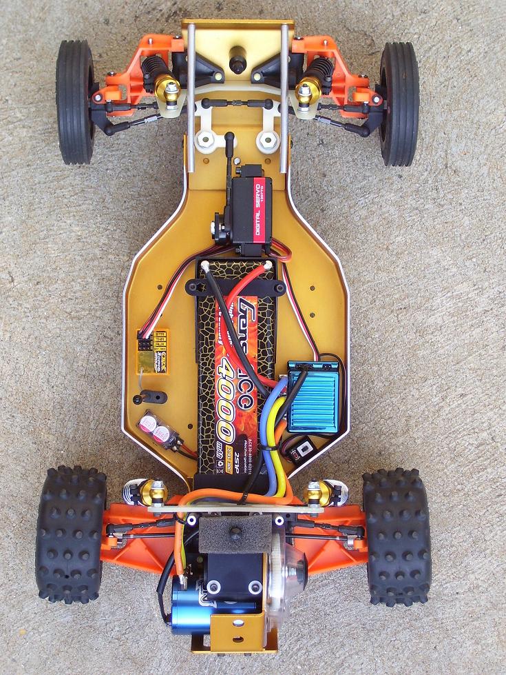

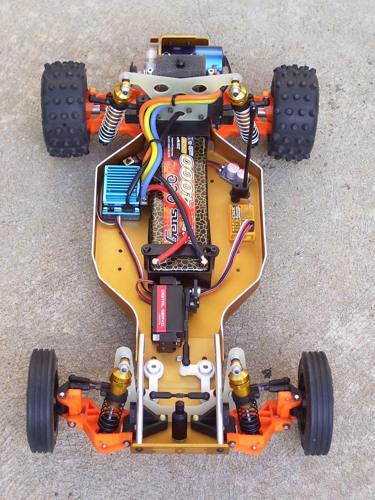

This one is probably close to how mine will turn out. Any particular reason why you put your ESC on the "other" side?1300GT wrote:Here's how mine looks.
As I mentioned, I think I have a few more mm of clearance on that side but then the motor wires will have to cross over.
*EDIT -- wait a second, does you BEC wiring go under your battery or even the chassis??
**EDIT -- upon further thought, I don't think my sensor wire will reach from the "other" side.

Re: Show me your Gold Pan electronics layouts
I put the ESC on that side to balance out the motor overhang.
Yep, the wires run under the battery.
I ran the sensor wire on mine through the matching holes in the bulkhead and shock tower.
You can see it a lot better in this picture.

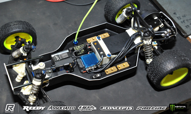

I really dig Kinwald's layout and the use of AE TC6 weights, if I ever get around to building my re-re this is the direction I'm going.
