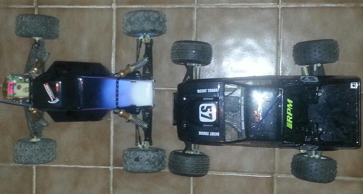

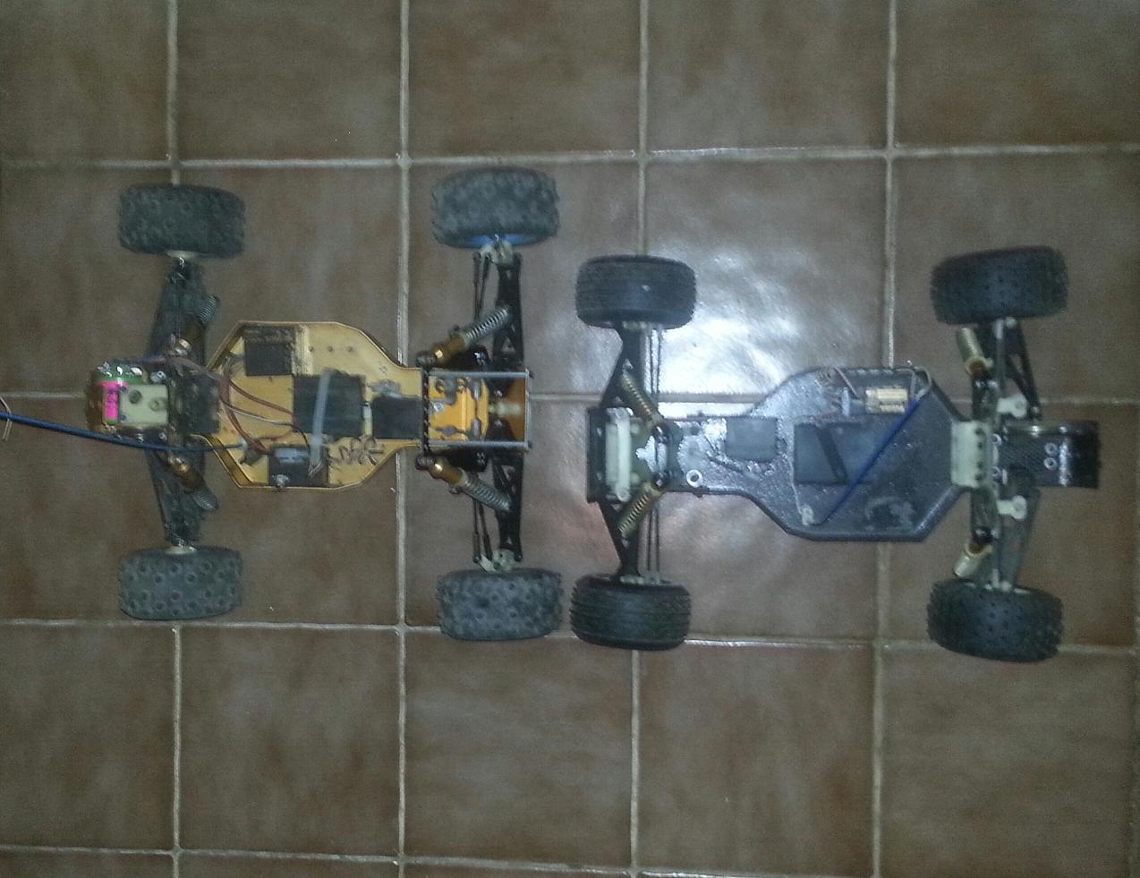

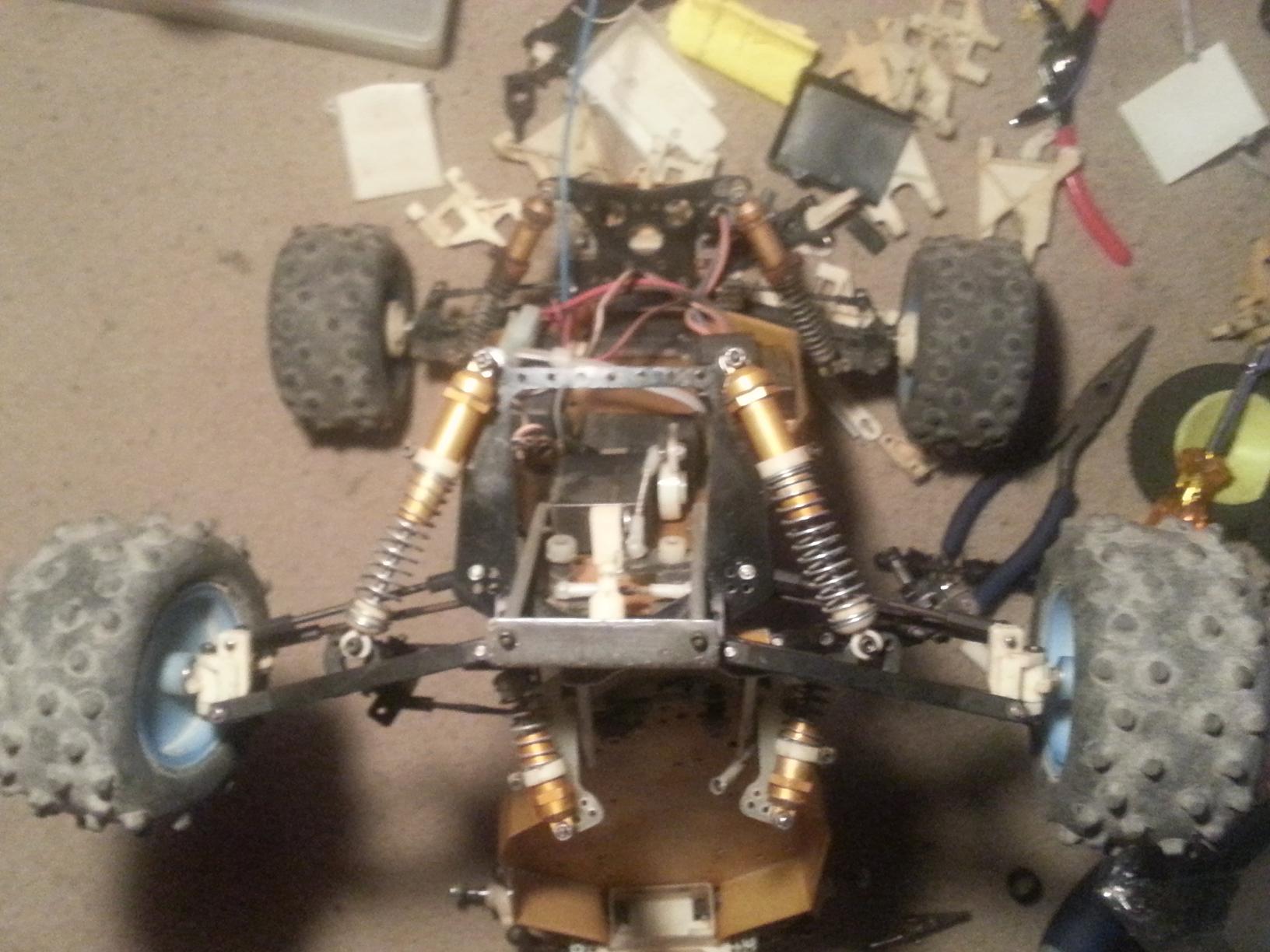

t3 front arms ,tall ftont shock tower,and a old monster truck conversion with wide offset rims .. a little over 15 inches wide...

Traction rolling? What's that!? Lol, Nice!

wow 5 days and 1 comment..( i know the pics are kinda crappy) i never saw anything like this before so i had to build it. just thought people might like to see someone doing something different then a stock rc10 build ..

It certainly has that 'wheel at each corner' look - very square :wink:
Be interesting to hear how it handles - corner grip should be pretty good, not too sure how it'll cope with rippled surfaces in a striaght line.

it handles good and turns alot sharper then you would think(its kinda a wider 10t with a shorter wheelbase).. the wide offset rims could use a stronger servo(runing futaba s3003) but this was more of a project that i wanted to have for the shelf and just something i wanted to do cause i never saw it done. i got the idea for the project cause i have always been into the crazy front ends they put on desert racing trucks and atvs .

do it .. the rear is rc10t arms and the t3 front arms must be trimmed a little to fit on the rc10 front arm mounts.. i was wondering how this would look without the monster truck conversion ,if you want
you could just use rc10t/t2/t3 rims. it will not be 15 inches wide but it would be alot cheaper to build.. the real fun is finding what long front shock tower to use. you could run stock shocks and tower but i think the long tower and large shocks really give it that crazy look
