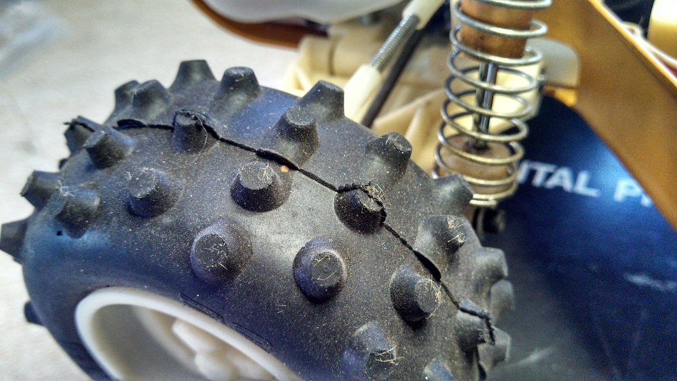

I would say this tire qualifies as 'never run'.... :)

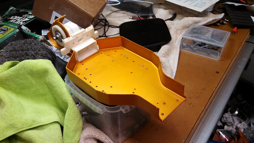

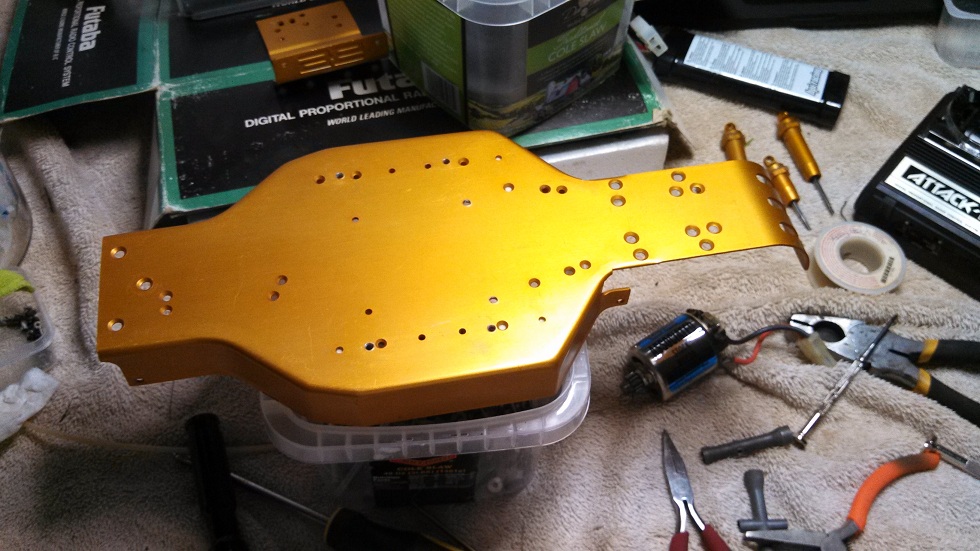

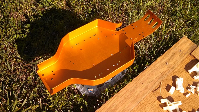

Here's the one major issue I found.
Used a large Futaba servo, which resulted in the chassis being drilled for the throttle resistor (per the manual, I checked.... ).
However, they also offset the battery trays by about 1/4 by drilling 4 additional holes for those mounting screws. Extremely unfortunate, but not the end of the world.

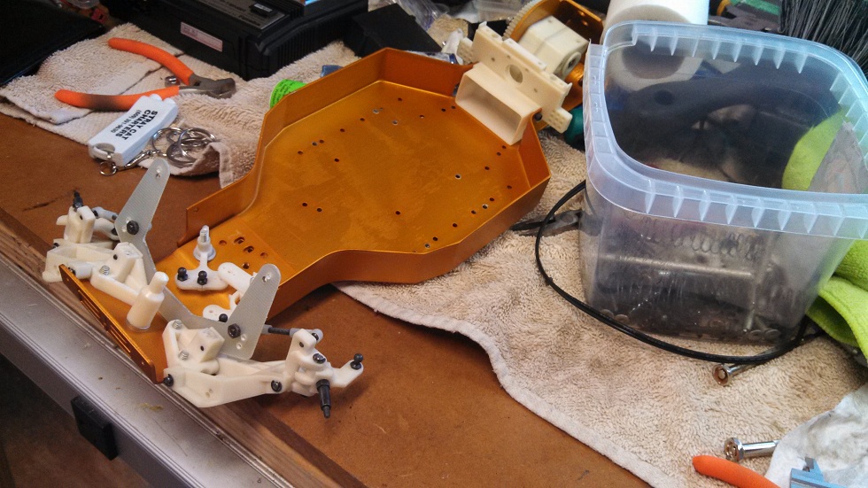

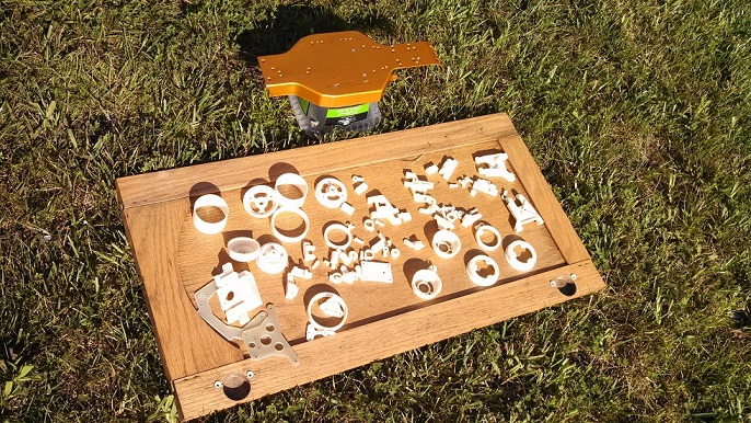

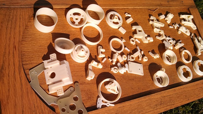

Fully re-kitted (lol) to be cleaned and reassembled. More pics to come once I have her back together.

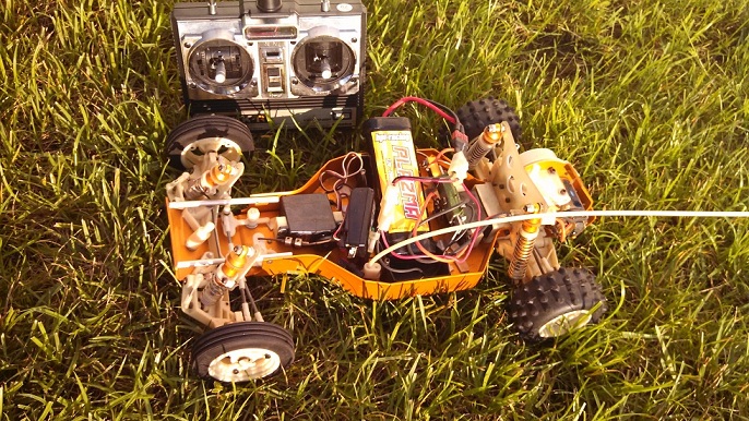

Quick video of the first test run, slapped a battery in it and had to adjust the resistor wiper arm and steering servo. More evidence this thing was in fact never even test run before I got it.
https://www.youtube.com/watch?v=oMdCW8oHUIo
Posts: 12336
Been thanked: 3919 times
Re: New To Me Never Run Gold Pan from the 'Bay
Gears sound a bit tight and battery strap fail :lol: but otherwise she looks great! Those MSC don't like slow speeds and long grass so be careful you don't hurt it. I love the old attack radio too, that was my second radio I owned.

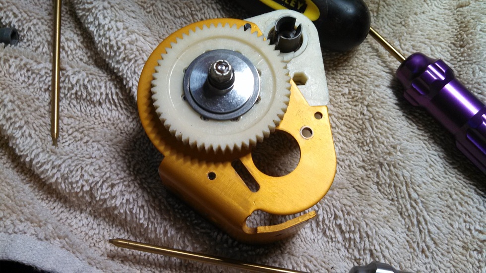

Pinion might have been a bit tight against the spur. Also, I took the 6-gear apart and one side binds a bit, the out drive gear to center gear mesh is super tight. Will have to work that out.

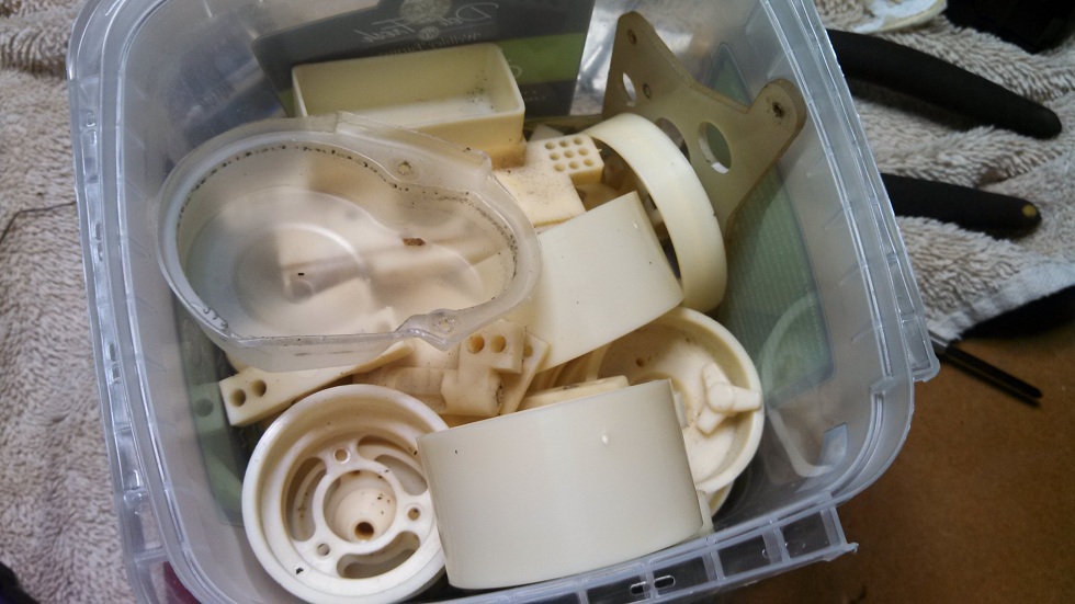

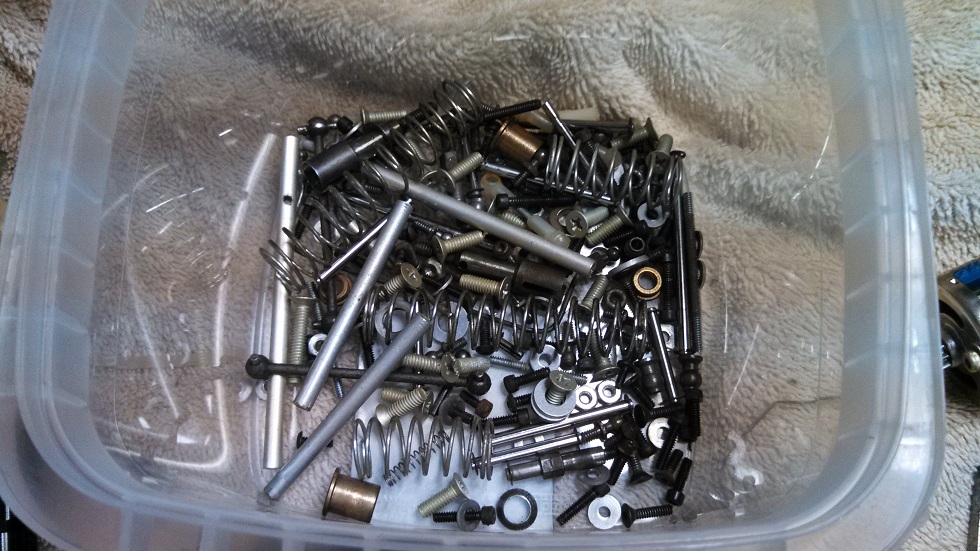

Cleanup Pretty much done, must say I'm happy with the results so far. I had a moment of panic when I thought one of the ball cups went down the drain. Even took the drain pipe apart. Found it in the container with the metal parts in it. oops.

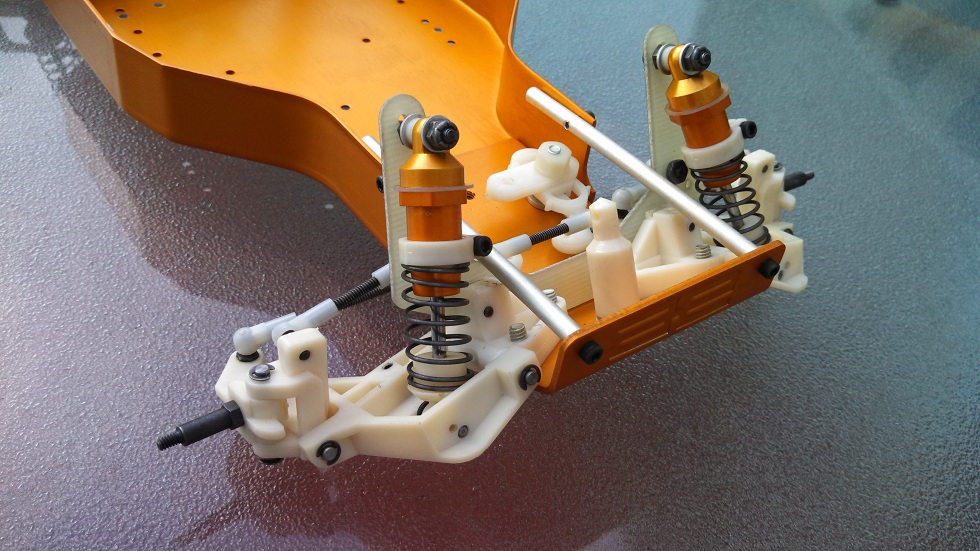

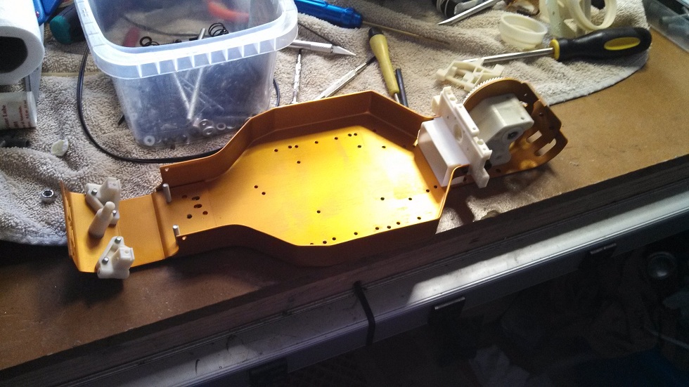

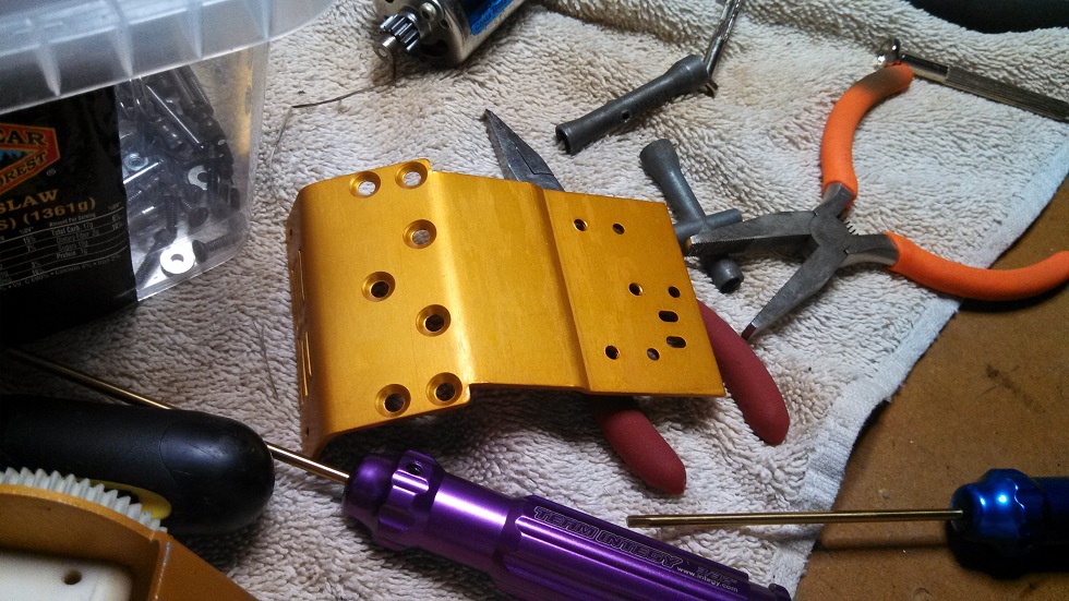

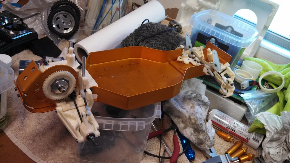

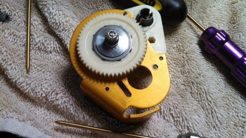

Going back together nicely. Taking my time and following the manual to the letter. Decided that I will keep the bushings for now, I already have a mint bearing car and it will be cool to also have this one bone stock as it came out of the box.
Getting started here:

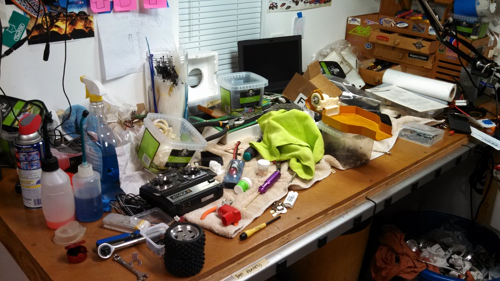

Might be time to clean the workbench soon....

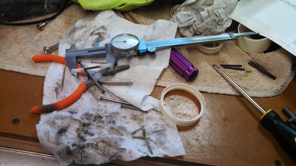

Busted out the dial caliper for perfect length tie rods.

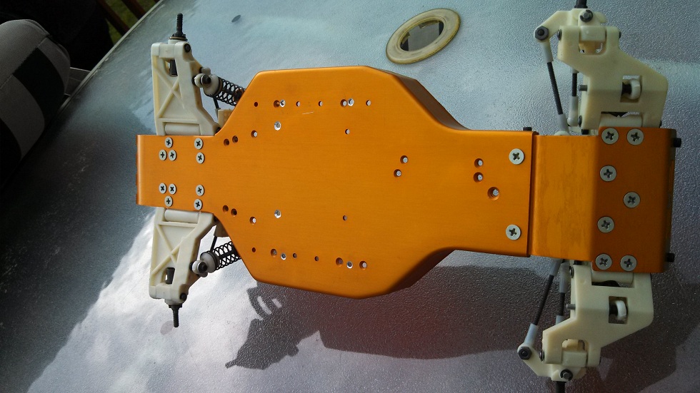

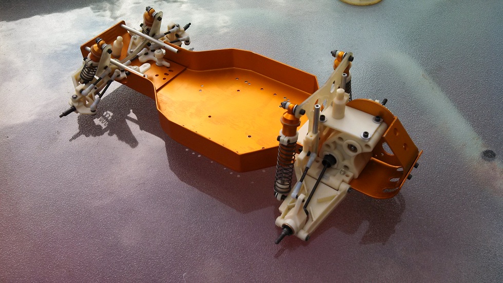

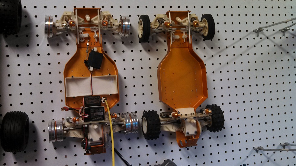

This is as far as I got over the weekend. Also tires were assembled and installed as seen on the last pic here. It is hanging next to my other gold shelfer, with it's new Lohas wheels. :) They will make a good pair of shelf mates.
