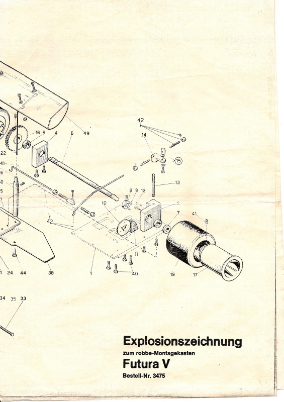

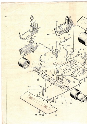

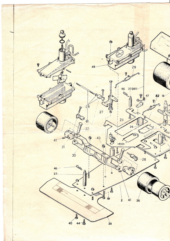

Here are scans of the SG Futura V exploded views....hope they help.

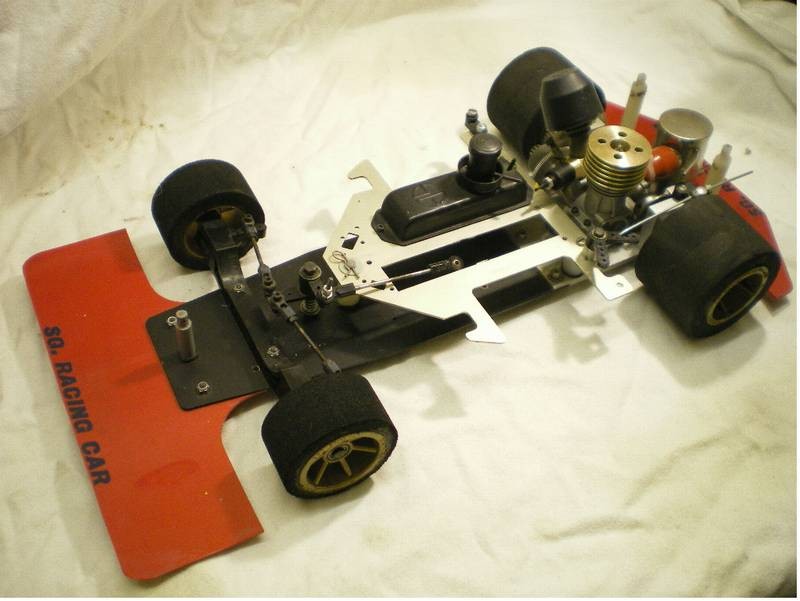

Hi Todd, the Futura 111 was introduced around 1977, it's predecessor was the SG1. the main difference (I think) between the Futura 111 and the Futura V was that the latter had a fibreglass chassis, forward of the aluminum powerpod. And the frontaxle and steering blocks were a bit different. Also the tank is different (111 metal, V plastic). I found one picture on Google that shows what your car should look like after completion. Here it is, not my picture!

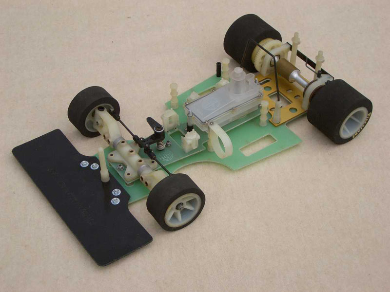

And here's the Futura V. A rear diff was optional. Note the different gastank.

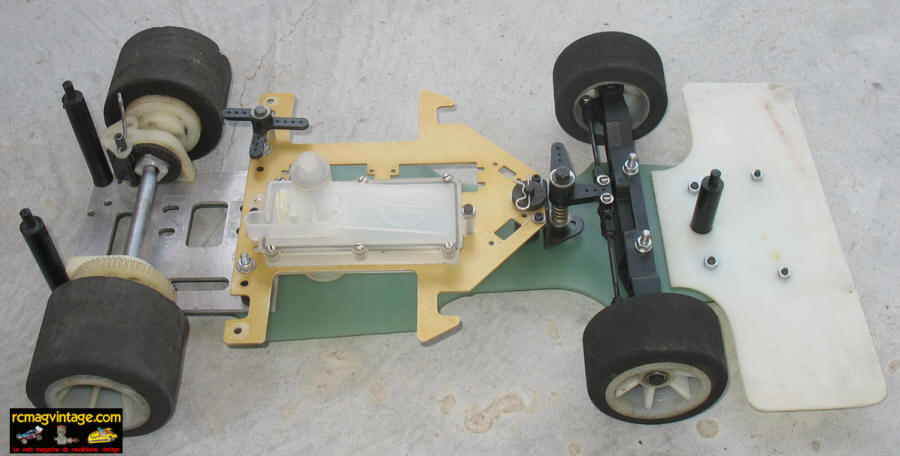

And here's a pic of the evolution of the Futura V, called the Futura VCS with a pendulum style front axle. These are the most sought after, at least here in Europe.

8valve wrote:Hi Todd, the Futura 111 was introduced around 1977, it's predecessor was the SG1. the main difference (I think) between the Futura 111 and the Futura V was that the latter had a fibreglass chassis, forward of the aluminum powerpod. And the frontaxle and steering blocks were a bit different. Also the tank is different (111 metal, V plastic). I found one picture on Google that shows what your car should look like after completion. Here it is, not my picture!
Ok good I think that is the picture I was referencing when I bought mine. Mine is a 111 then. Thanks again for your help
Yes, definitely! Super Tigre engine with rear mounted exhaust-pot would be perfect.
