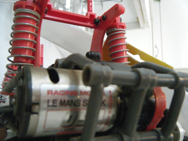

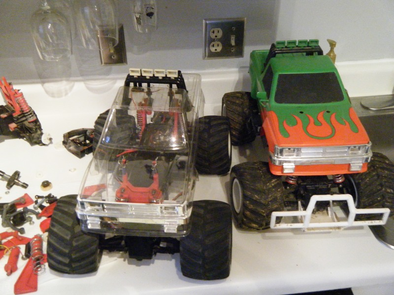

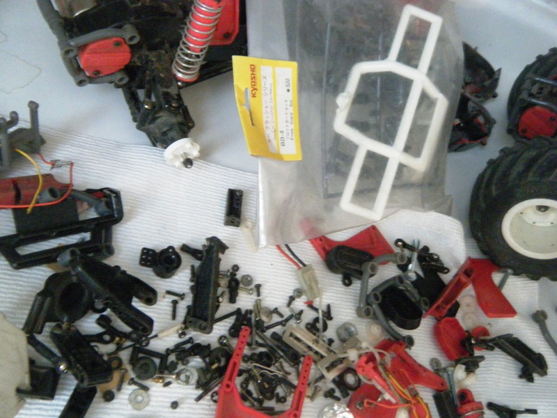

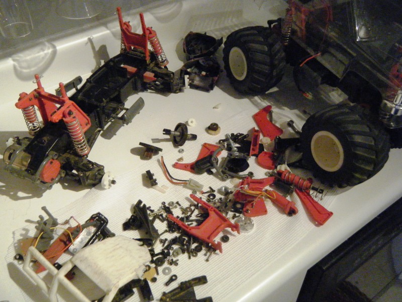

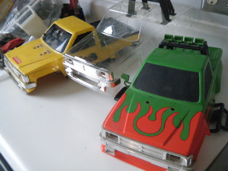

I have been acquiring Big Brute parts for a while now to restore my favorite childhood memory truck. In the process I ended up with a couple pretty complete trucks the last of which I got solely because it had an original unpainted body.

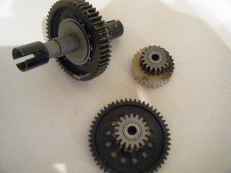

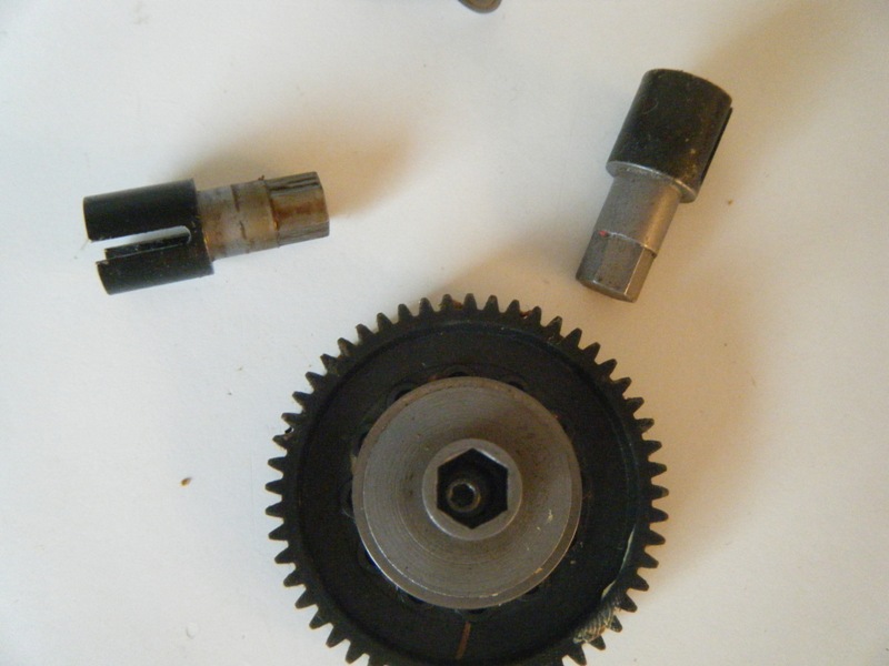

I opened one of my gearboxes that was in the pile today and found a thorp diff and gears, very happy about that! I have found some info on the dogbones I will need (even a modern sub I believe) but need help on the axles?? Pics of the set below and then random pics of what I will working with. My goal end up with one very nice runner, some extra parts and the rest will go to a mega blow out Brute part lot :lol:
So I need thorp dogbones and axles? What were the part #'s I need to search for?

I also notice the diff I have has hex drive outdrives which are different from what appears to be a slotted type in this Lowgear, two types or do I have something else? Never mind, Isee now, his diff is locked version. Need to find an axle solution.

I look forward to seeing what you come up with as I'm stuck on finding axles as well. I want to use standard 12mm hex rims but don't know what axles will fit in place of the stock ones, and I can't justify the cost of buying a whole bunch of different axles I think might work. I was hoping people here could dig through their parts to see if they had anything that matched the dimensions I gave in my build thread but didn't get much help.
I don't think theres a specific reason why the Thorp outdrives have a hex shape and the Maxtrax ones are slotted. It must have just been easier to manufacture them that way, and what they thought would work.

The Thorp Diff is unique from other ball diffs. The screw threads into the other half but does not appear to be a lock nut, I am not certian how this can stay set and not just loosen up unless I am missing something?
