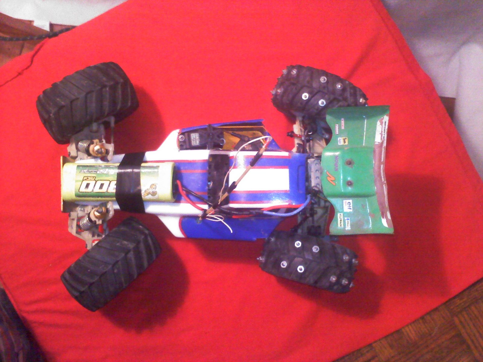

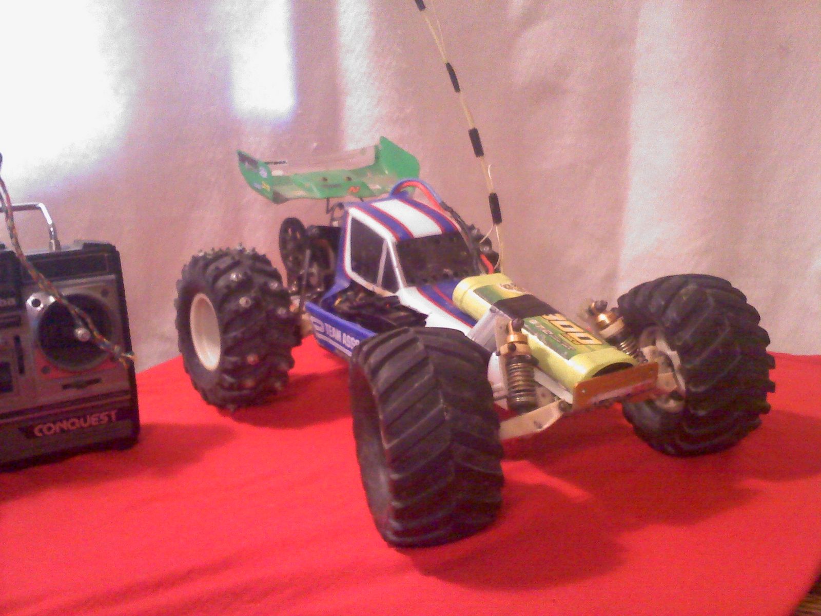

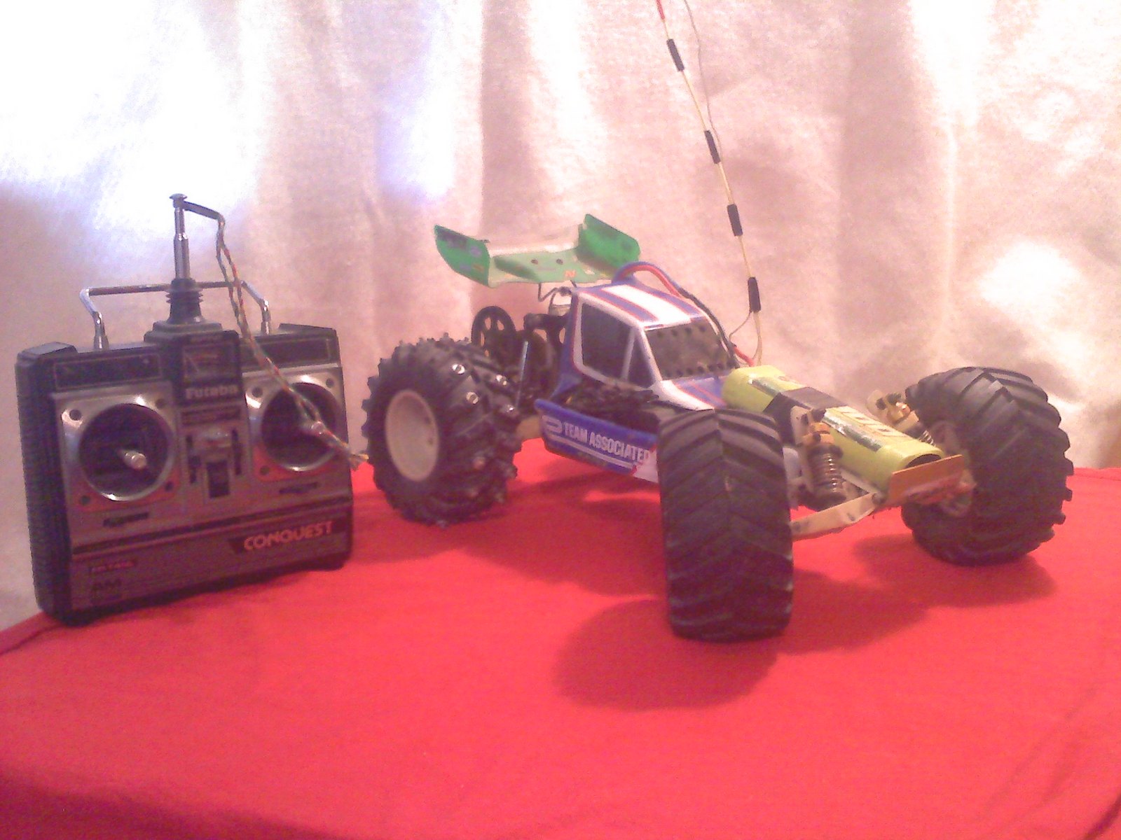

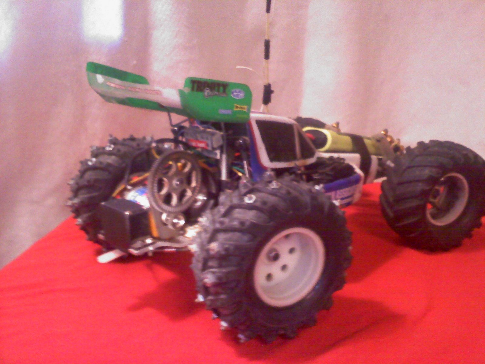

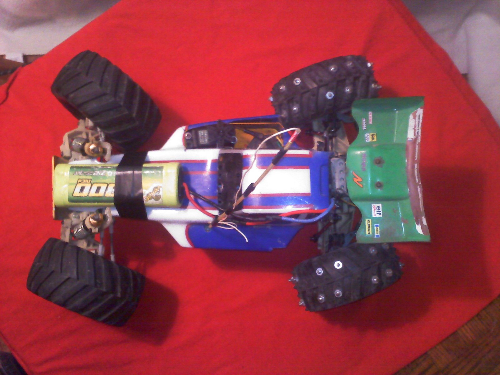

i hope this counts, the concept started long ago but never really got off the ground. this low buck build off was the perfect excuse to waste some time throwing this wonderful gem together !!!! the body is an old terrible condition botched paint job body that came on a bay purchased RC10, i believe it was on the chassis i used for this build too. i didnt think too much about cutting it up to fit the MSC over on the side all wacky. the wing is from a b3 i think, one of my 1st paint jobs. i used the wrong white paint. :roll: yes, that is a vintage futaba conquest, the only radio i have with more than 2 channels. found the radio + half of an old gas plane with receiver and servos in the garbage. the battery is mounted on top, up front to get some weight up in the front of this machine, also, adds to the aesthetic quality.

i needed the extra channel for the 4 wheel steering ! :shock:
lets turn left !
lets turn left !
lets turn right !
lets turn right !

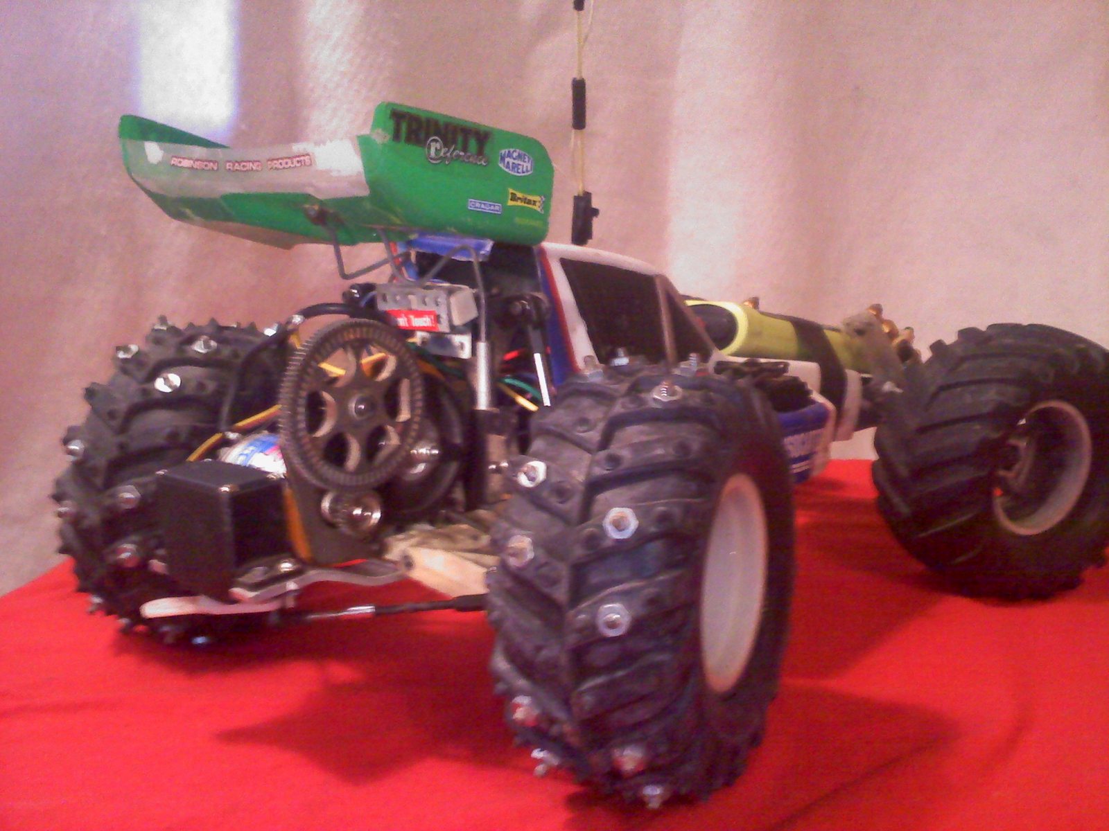

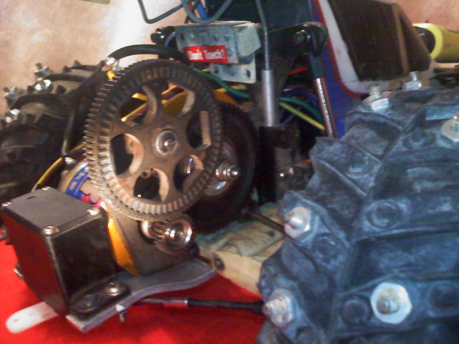

i suppose by now you might be wondering what on earth i was thinking, and maybe noticed that strange transmission set up hiding back there ?

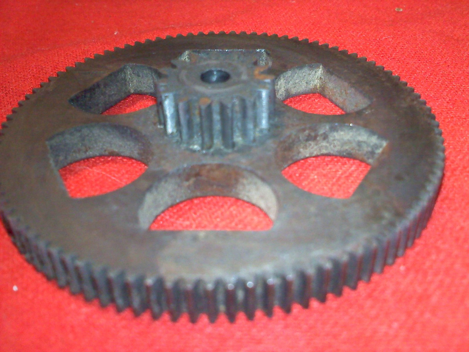

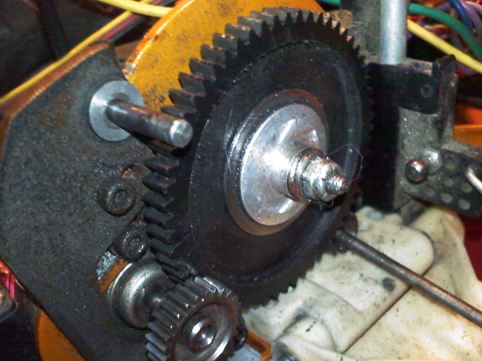

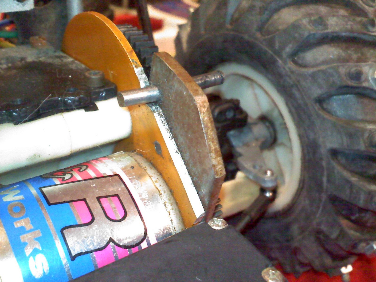

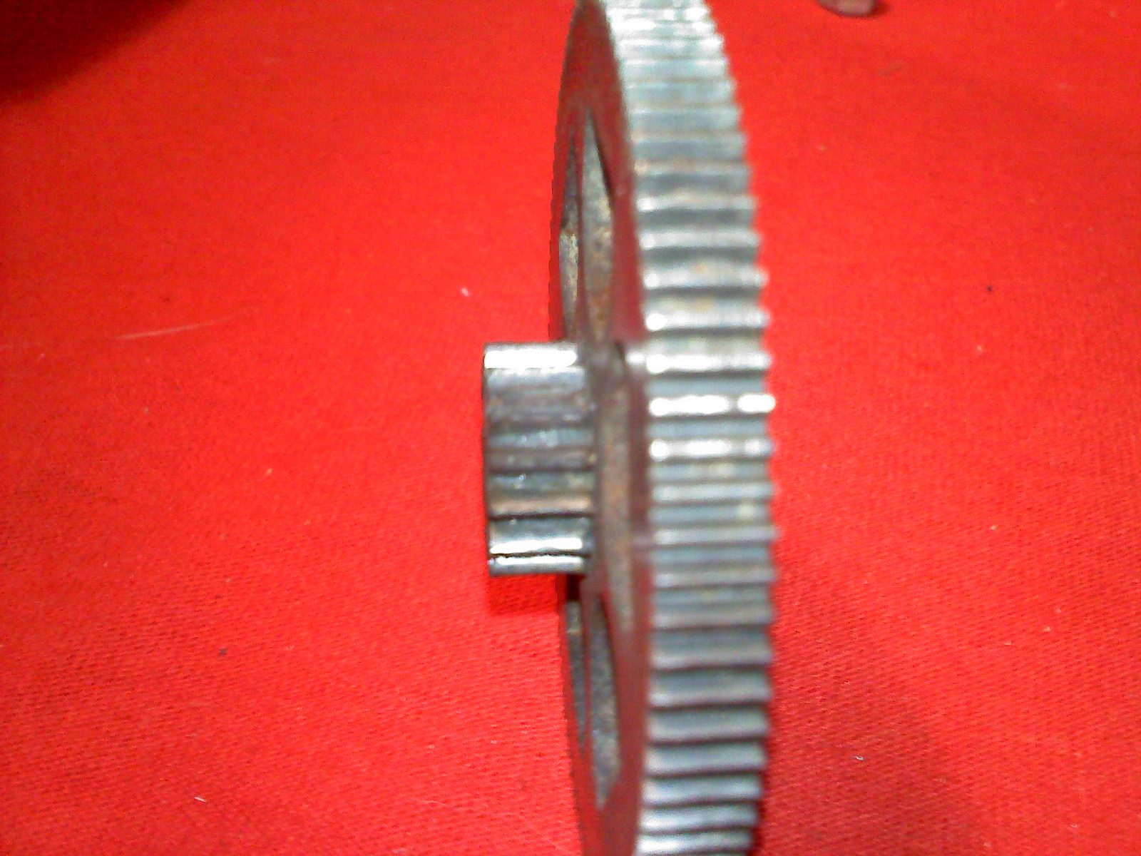

You guessed it !!! Home made gear reduction ! :) see that fancy steel spur gear ? its actually a gear from a mid 90's computer printer ! :lol: its secured to the stock associated transmission brace with a random hinge pin from some forgotten RC car. the soft aluminum obviously isnt strong enough for such a modification, so i made this steel ''brace'' of sorts. on the back of the printer gear is an old steel pinion gear, silver soldered in place to mesh up with the stock associated spur to create my underdrive ratio. so the fancy printer gear/pinion combo acts as an idler. ( i have not yet determined the exact ratio, but the car moves about 1/10th of the speed )
closer inspection of the printer idler and the transmission brace :

the rear of the transmission brace :

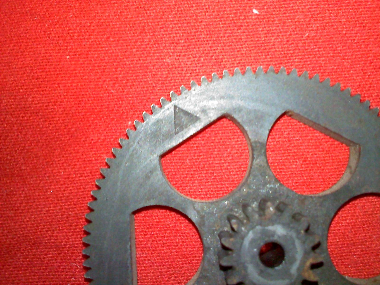

also, notice the alignment mark on the printer gear, now i can finally find top dead center on my motor ! :lol: i know bad joke...

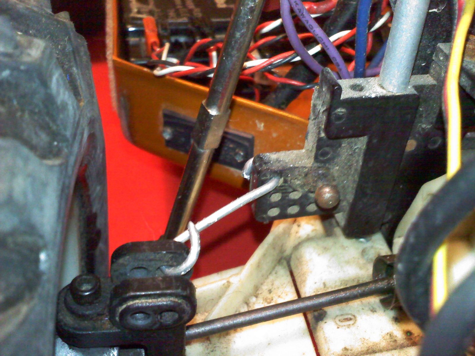

i used some wire for my rear turnbuckles, very low budget, and i didn't have any spare long shocks to use on the rear anyway, so i used some draglinks i had previously upgraded from a losi mini rock crawler to hold the arms in place. ( come on guys, i at least needed one real rock crawler part on here )

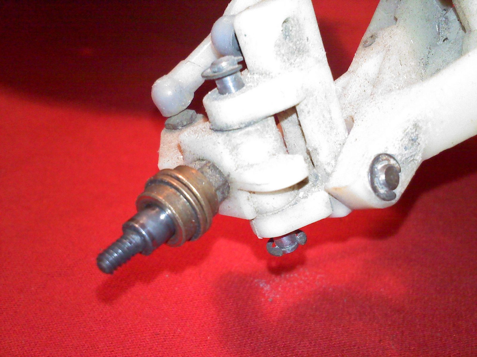

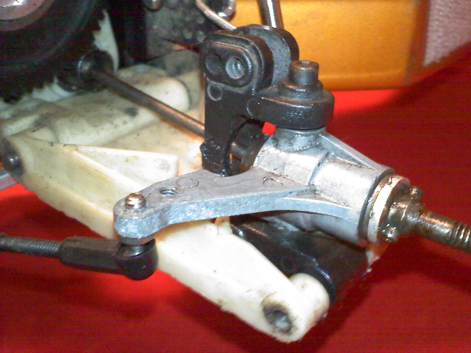

here are the rear carriers, which are actually the front carriers and casters off my 1st nitro car, which has been deceased for quite some time. i think it was a traxxas maximum bx? if that sounds right. (edit, i just remembered, it was duratrax maximum BX lol ) i fitted them with some old rc10 stub axles, by means of a few strategically placed shims and bushings. its a miracle the dogbones fit, well with a few fine touches.

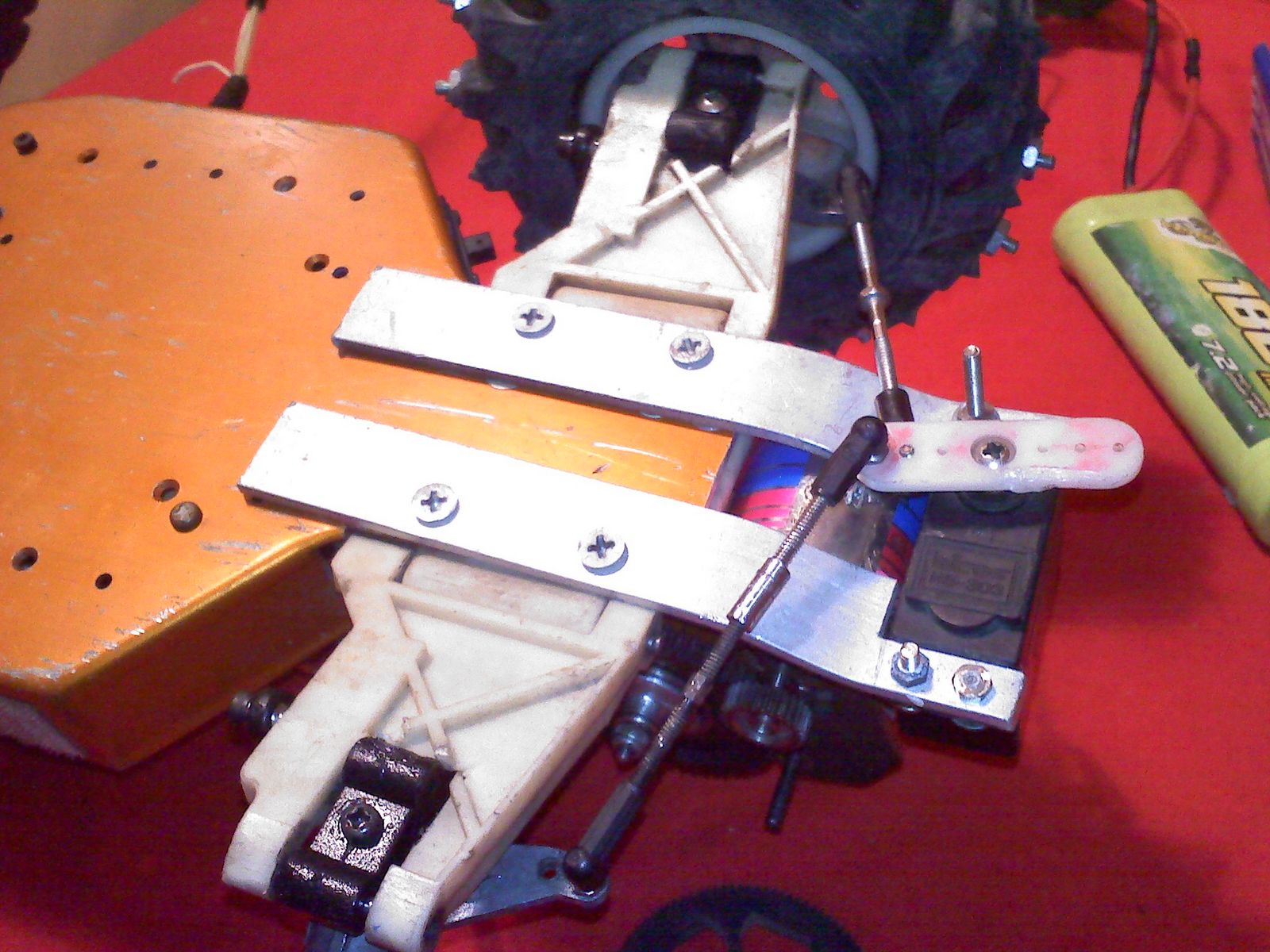

here is a look at the underside, and my special part #00054541 aluminum locate-a-servo brackets ( yes of course im kidding ) also, here we can see how i had to sacrifice these rear arms to accommodate the front casters from my BX. :cry: sorry guys.

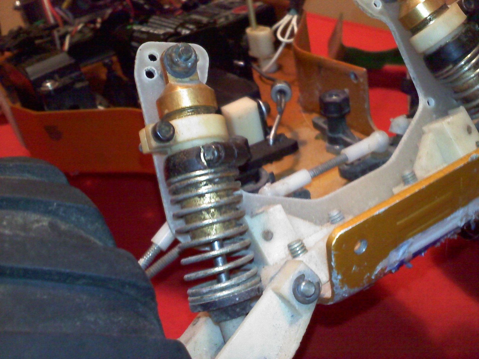

here is a closer look at the front shocks. yep not associated, i believe kyosho. they were hand me downs from a friend. the spring retainers? were cracked so i could not adjust the spring tension. rather than remove the old ones and add the associated ones in their place, i opted to keep both sets :lol:

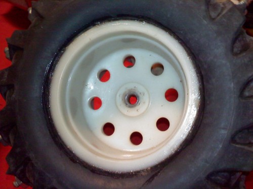

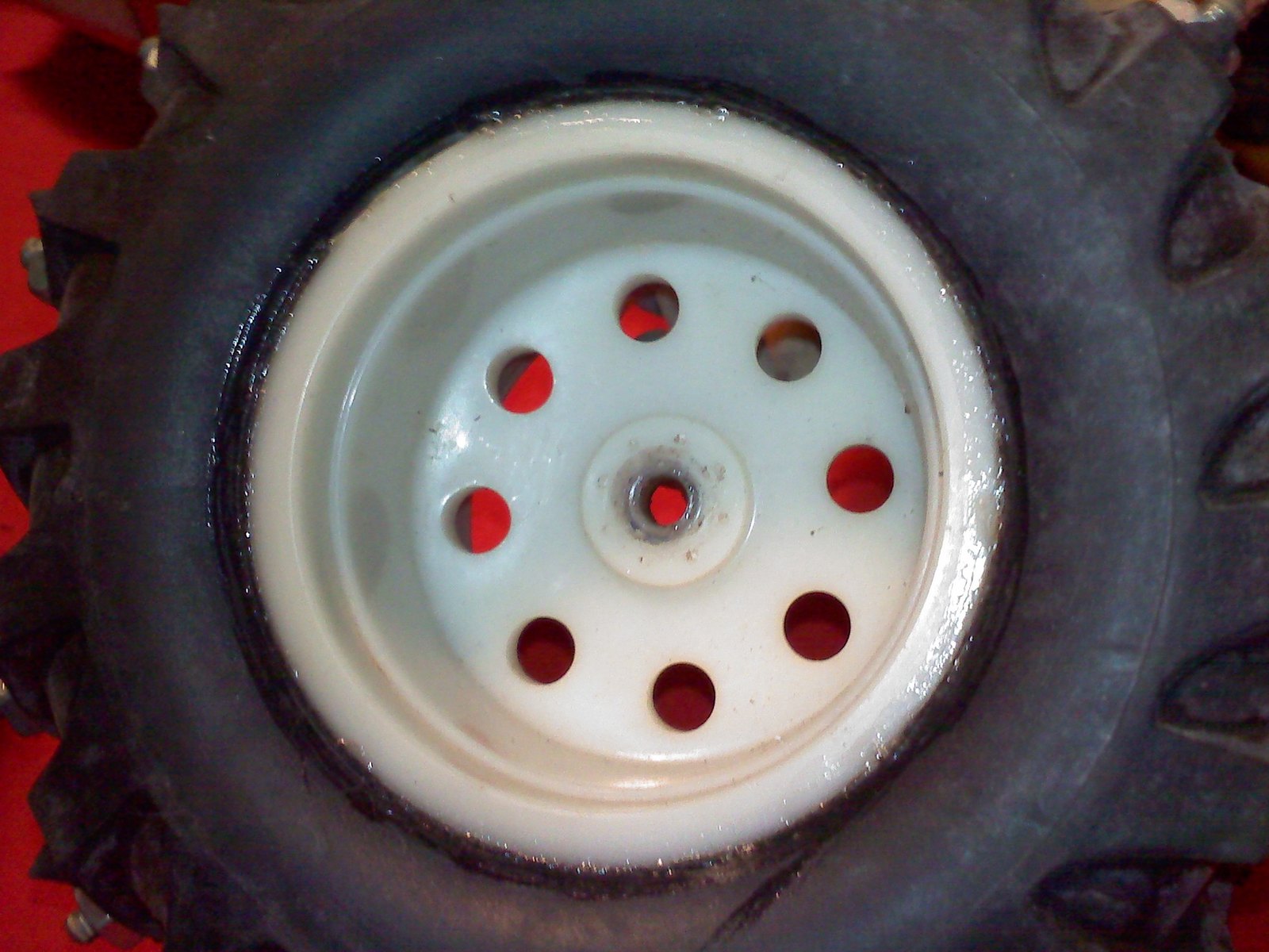

ahh the front axles, two bushings on each side with the rear wheels from previously mentioned maximum BX mounted backwards on them 8)

the rear wheels are i believe old pro lines ? or some knock-offs from the toy RC arsenal.

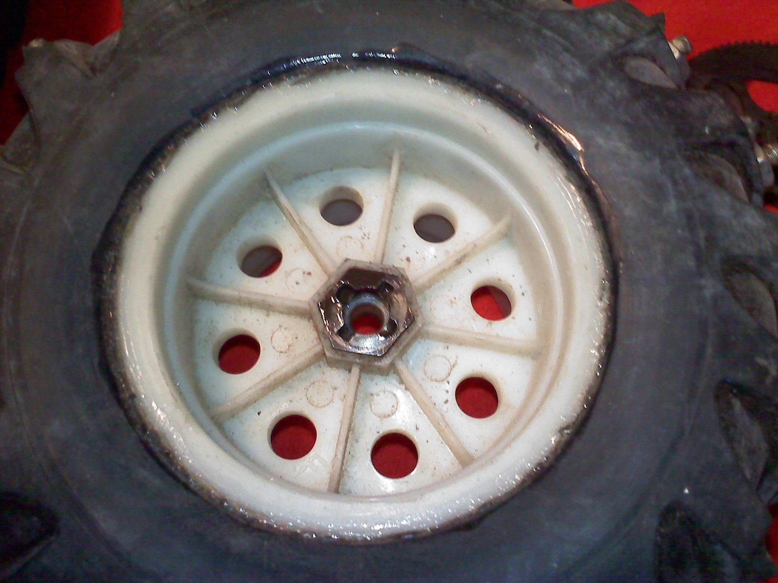

i used some aluminum hex wheel adapters from the same lot my friend gave me.

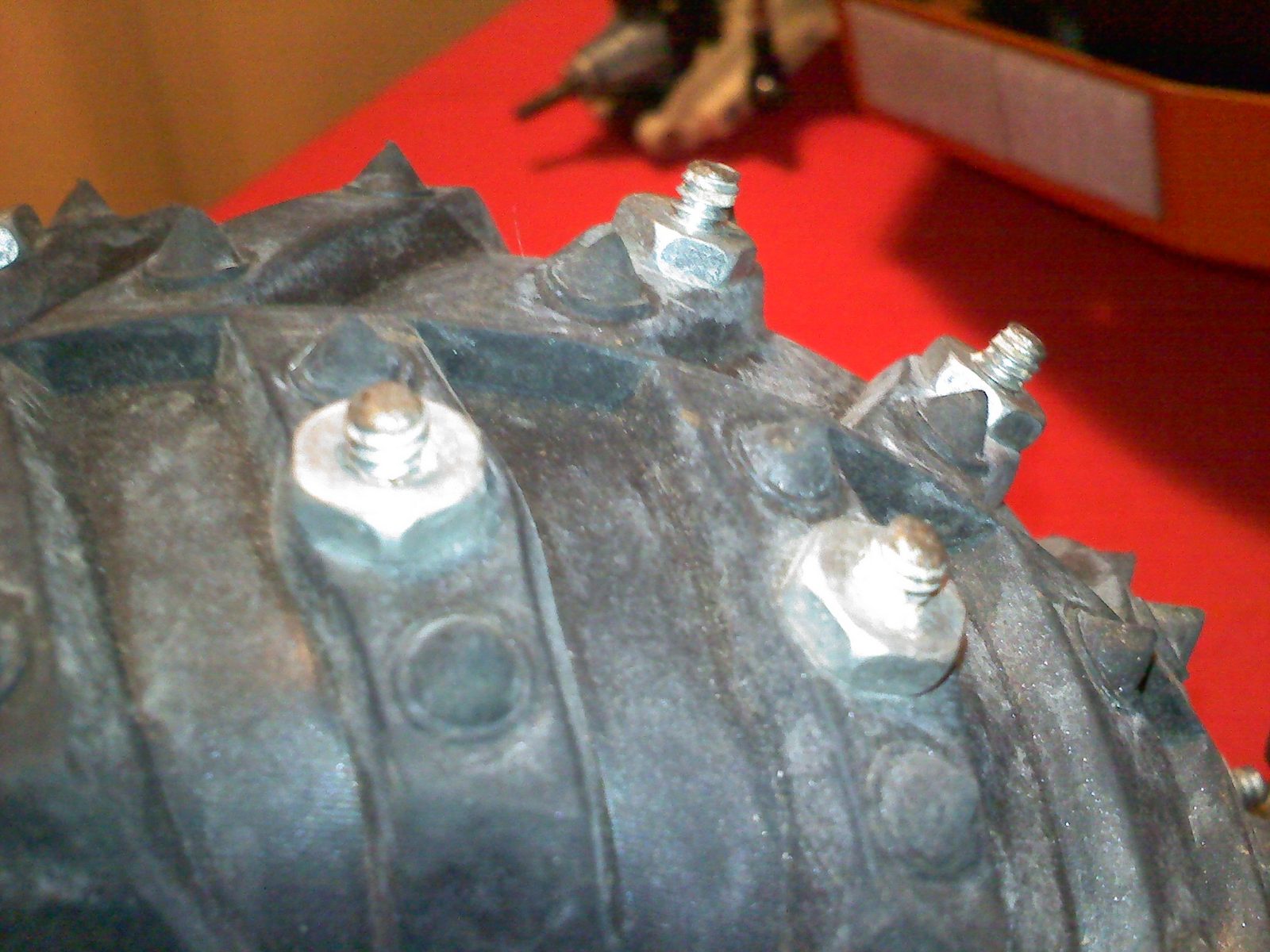

notice my traction grabbers for dirt hill climbing.

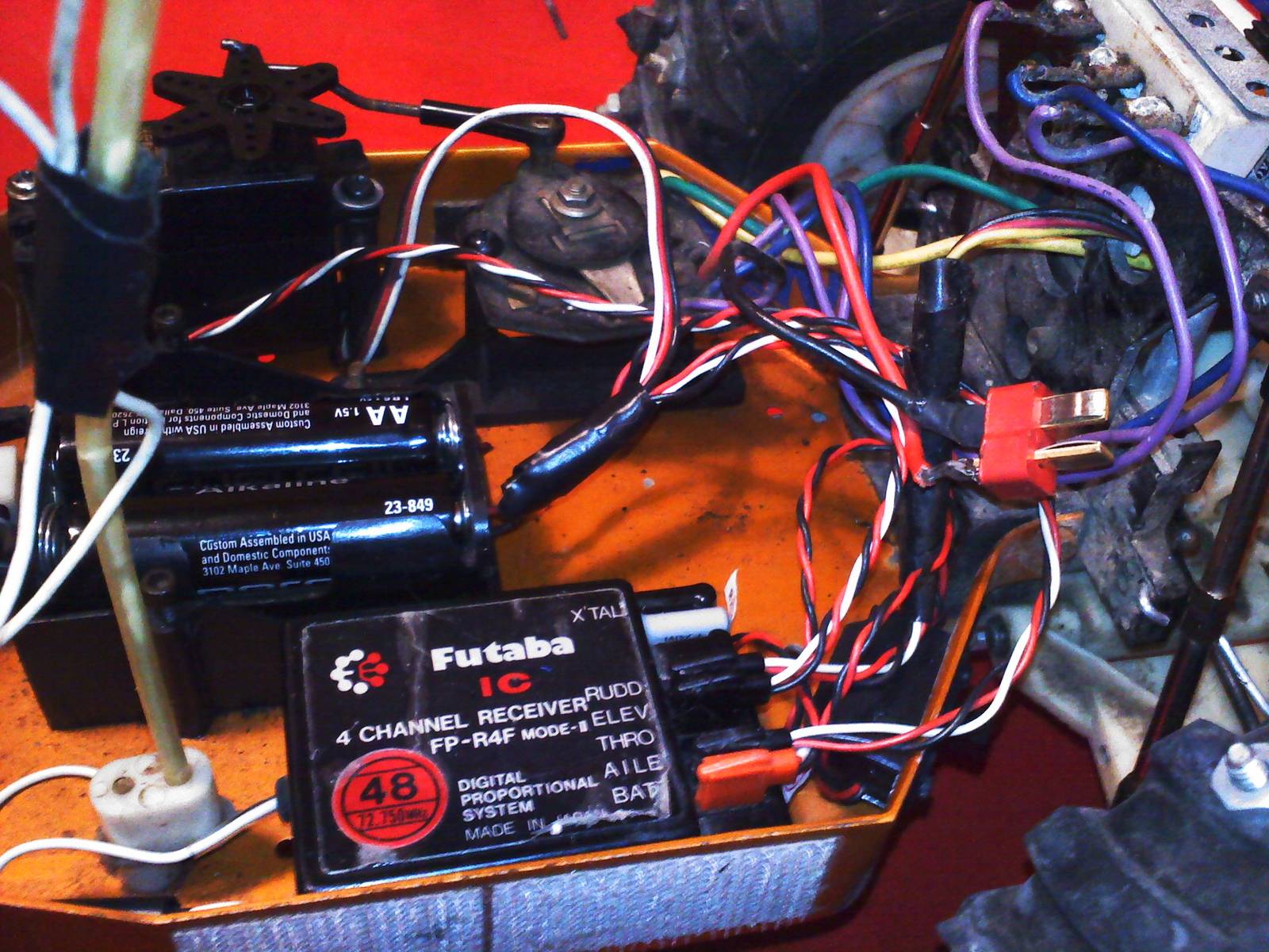

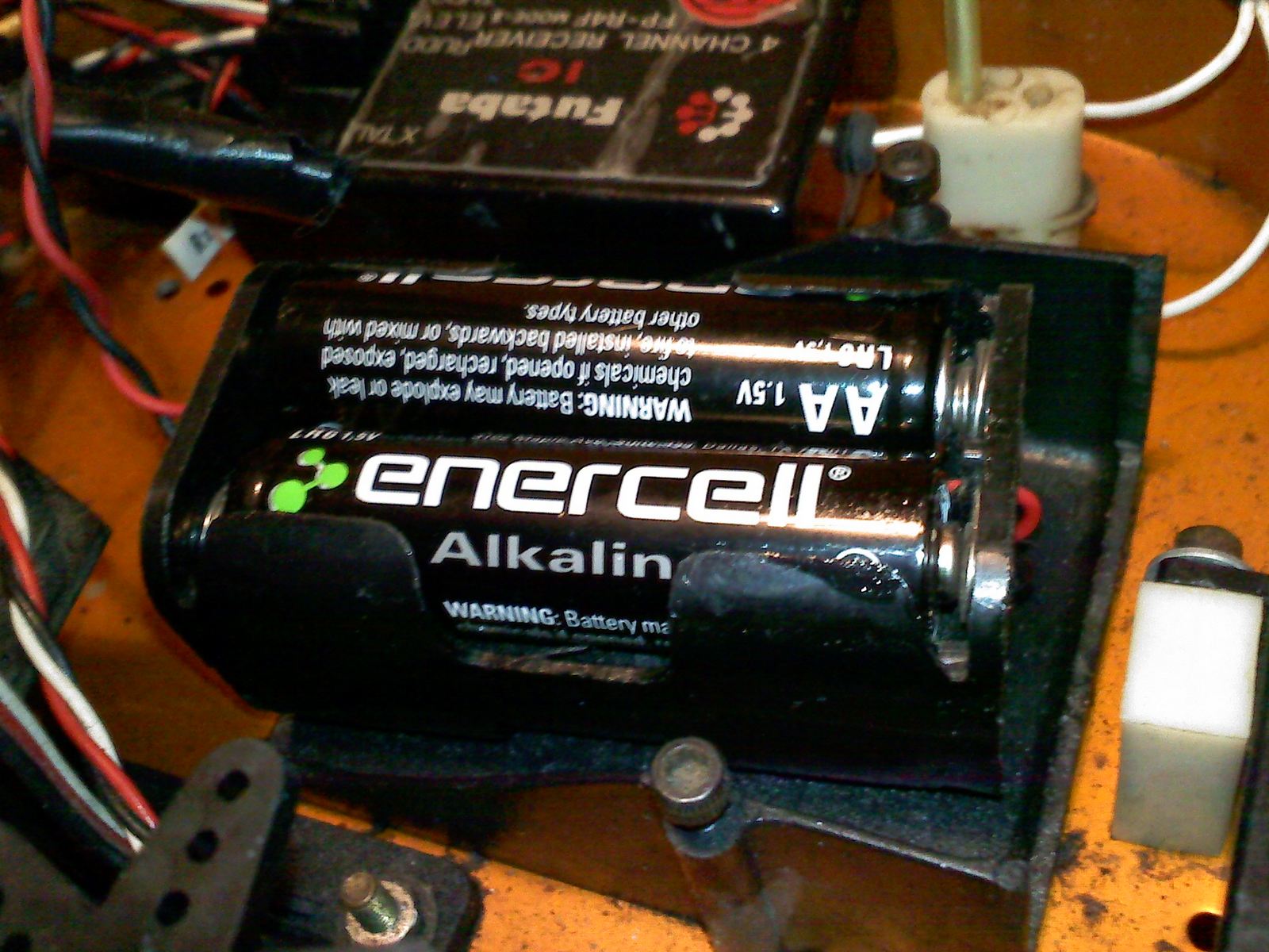

i didnt even buy real batteries for the receiver power pack! ( the pack was also from the plane someone had discarded )
lastly but not least, my beautiful wire routing skillz
