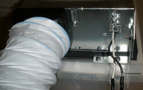

1. Partly disassemble the fan so that you can route the 2 electrical wires outside. The inside has a 2-prong connector that you plug into the fan housing.
2. Place fan on top of plastic tote, mark the perimeter with a Sharpie.
3. I had some foam tape that was 1/4" thick, I stuck that where the fan housing would meet the tote, to make it somewhat air-tight.
4. Cut a hole within the perimeter line, at least an inch or so inside the perimeter, for strength to support the fan. It's not really heavy anyway, it's just what I did.
5. Find 3 pieces of L-angles, drill a hole at each end and find some screws, nuts & washers to fit. I didn't even have to drill my particular fan housing, holes already existed.
6. Bolt L-angles to the housing. Place back on tote, mark the mounting locations of the remaining 3 holes with a Sharpie. Drill holes where marked.
7. Bolt the fan housing to the tote. I used washers on either side, inside the bolt-heads & nuts, to again help with structural integrity.
8. Attach the duct to the fan's exhaust port with a plastic clamp.
9. Cut end off cheap extension cord, strip a half-inch off each of the 2 wires.
10. Solder these 2 wires to the wires routed through the fan housing in Step 1. Make sure to shrink-wrap the exposed wires, you're talkin' 110V alternating current. Unlike milk, it does NOT do a body good. :shock:
11. Cut off a section of furnace filter to more than cover the hole cut out of the plastic tote. I attached it with Velcro at the corners, for easy replacement. I attached the filter section to the underside of the inside of the tote.
12. Plug in cord; fan exhausts through the duct. 8)

Detail pictures of the completed assembly
Post by Coelacanth »
Some close-ups to show the construction.
