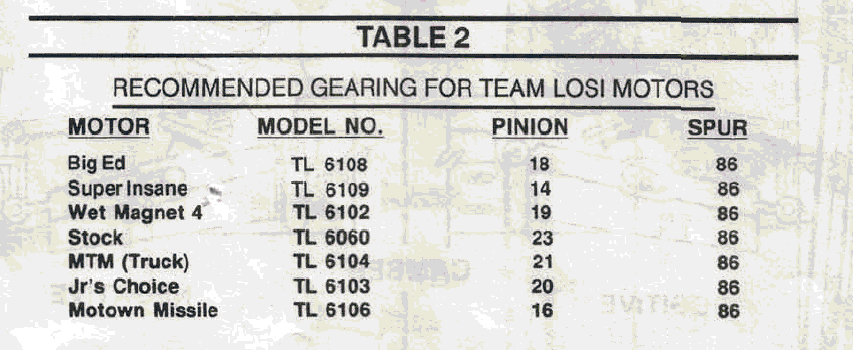

Your 16*3 is called Brutus and it's not listed in Brandon G's list. There was however a Jr's Choice, that I know is a 17*1. But (almost?)all motors on the list were also so called "Wet"-magnet motors and Brutus was older "Dry"-magnet can based. Wet magnets did offer more magnetic field or something like that and therefor more torque but less RPM. So I think that You can start with Jr's Choice recommendation 20/86 and see how it goes with 2" wheels and tires. If motor gets too hot after a minute or two, use smaller pinion. If you use 2.2" wheels and larger diameter tires than there were in early 90, like Jrx2 stock tires, You should use smaller pinion gear. Gearing recommendation is also probably based for ROAR/US rules for 4-minute runtime and US style tracks.

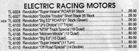

I found Team Losi's old price list that was Effectice: 10/15/90 and on page 4 is a list of some Revolution motor winds.
So Bongo Fury ,You were right about Jr's Choice.

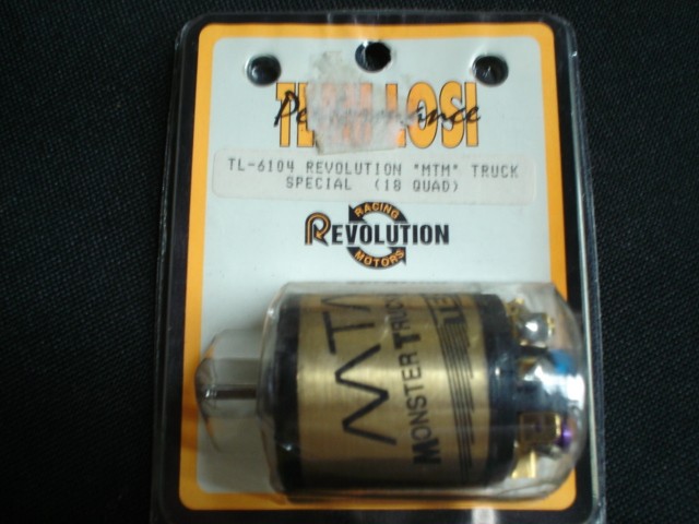

But I also found a MTM pic from Tamiyaclub, and on that pic MTM is 18*4.
Jirka

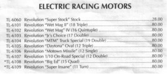

And today I found an another "Team Losi Price List" Effective 3/15/93. There were couple of differences: Jr's Choice was now 17*3 and Motown Missile 12*4.
Jirka
