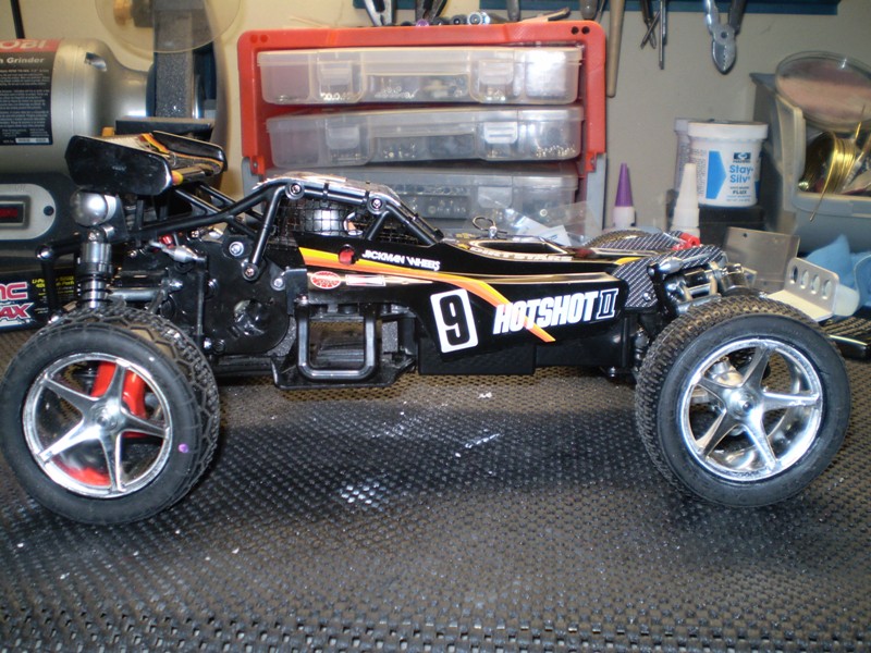

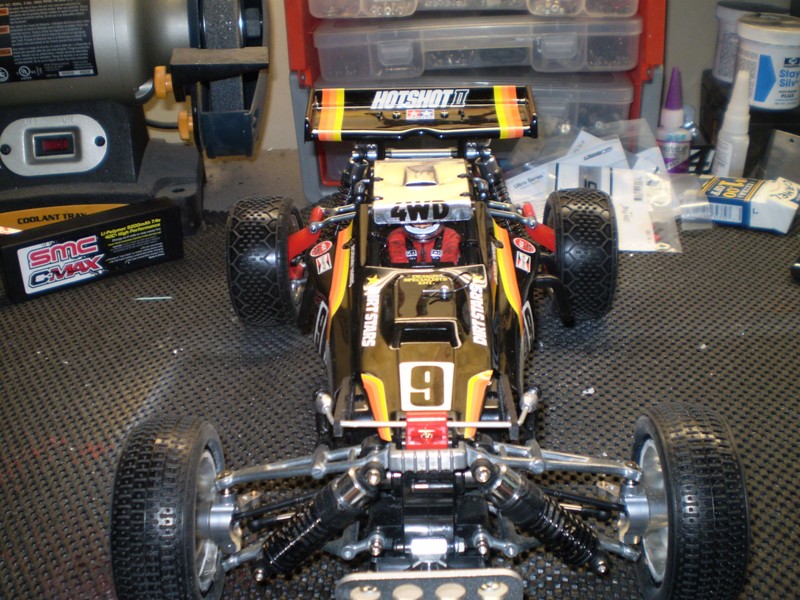

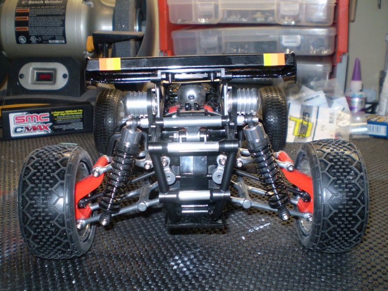

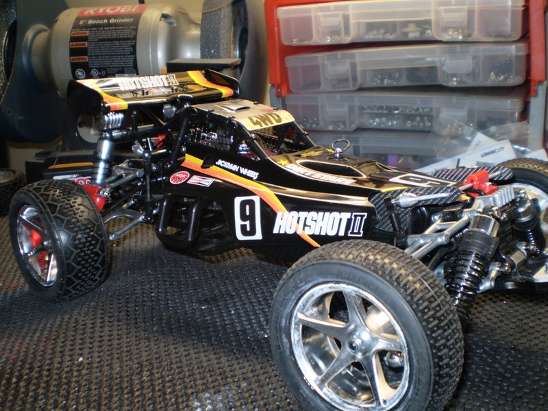

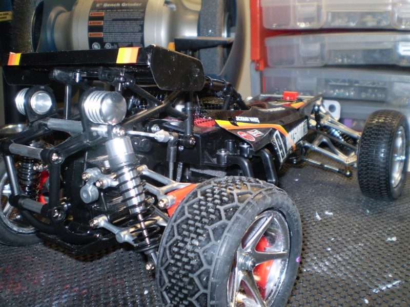

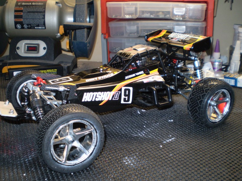

well had this kit for a while. it started as a Hotshot Re-re Kit. But i had a hotshot II runner (beat to hell). So i salvaged the body and Bottom Battery Plate from it (different than that crappy fiberglass thing with bodyclips..
Restored the Body (nitro fuel & lexan polish and new stickers from ebay from the UK), i love the hotshot II body ALOT more than the original, much sleeker. was watching one on ebay selling from the toybaron that ended at $100+ so i decided to restore this one lol

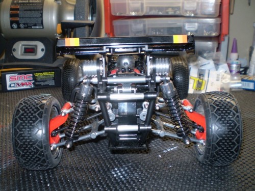

Also added a RCchannel Suspension Kit and shocks.. Very Nice and high quality kit. Added front aluminum steering blocks from ebay (they are ta01 steering, same part, from ebay for like $20, cheaper than thorp lol). Added HPI 5 Star chrome front and rear wheels with losi rubber, and used ultima RB5 Clamp Hex Hubs to adapt the wheels, fit perfectly

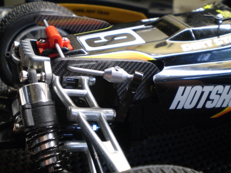

also made front rollbar supports from graphite, the stock ones always broke easy.
also added a steering bellcrank here...

also added universal axles
http://cgi.ebay.com/ws/eBayISAPI.dll?ViewItem&item=200215598694&viewitem=&salenotsupported
going to try and make it to the vonats this year and run this, just got a 40C lipo and my brushless is coming soon.

The steering bellcrank idea I will have to give a shot....

ya the steering, works perfectly. the electronics, suck at the moment, car runs like a dog, well a sick dog... gonna have to try and get a 27t motor in there. is a stock motor technically "faster" than a 17.5 brushless?
