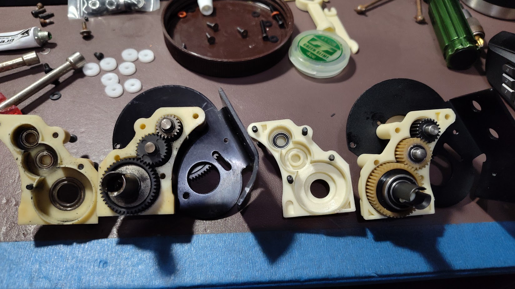

Back on the Transmission topic, if anyone didn't know the difference between the original Stealth and the Fan RC one here's a side by side. Idler gear on the Fan RC has the bearings in the gear rather than in the case.
One on the left is out of my OG RC10T and on the right is the Fan RC one.

Rogue nice side by side stealth comparison. Regarding the outdrives... I'm in the midst of building my trans for the fan kit. I did feel that the rings could use a sanding. I only sanded one side assuming that I don't want the ring to slip on the outdrive right? The outdrive to me felt rough. Like if I placed the ring on it and spun it around it felt gritty. But I hesitate to do anything to smooth it out because I'm assuming I don't want to encourage any spin between the ring and the outdrive. Right? Does anyone prep the outdrive at all?
As for the bellcranks I did get 3/4" screws and a nut to tighten them down. The nut then acts as the spacer. As a spacer it's a little thicker than I wanted and I thought I was going to have clearance problems with the ballcups but it looks like they just clear. I'll probably sand the nuts down to keep the geometry a little truer to the kit.
I can't compare them because my original graphite car is suspiciously missing the transmission but from 30 years ago I recall them being much lighter and smoother and made out of like a hard coated or anodized aluminum.
I love that fanrc replicated this kit for us but this was my concern. The most vital parts may not quite be up to the original. The parts that at least in my mind were the real reason the car was so special. Now it's still to be determined if the Fan parts aren't up to snuff and hell some of these differences could be upgrades. However, I am so grateful to have this opportunity so I'll take it. Next we just need associated to reproduce at least just the stealth tranny.

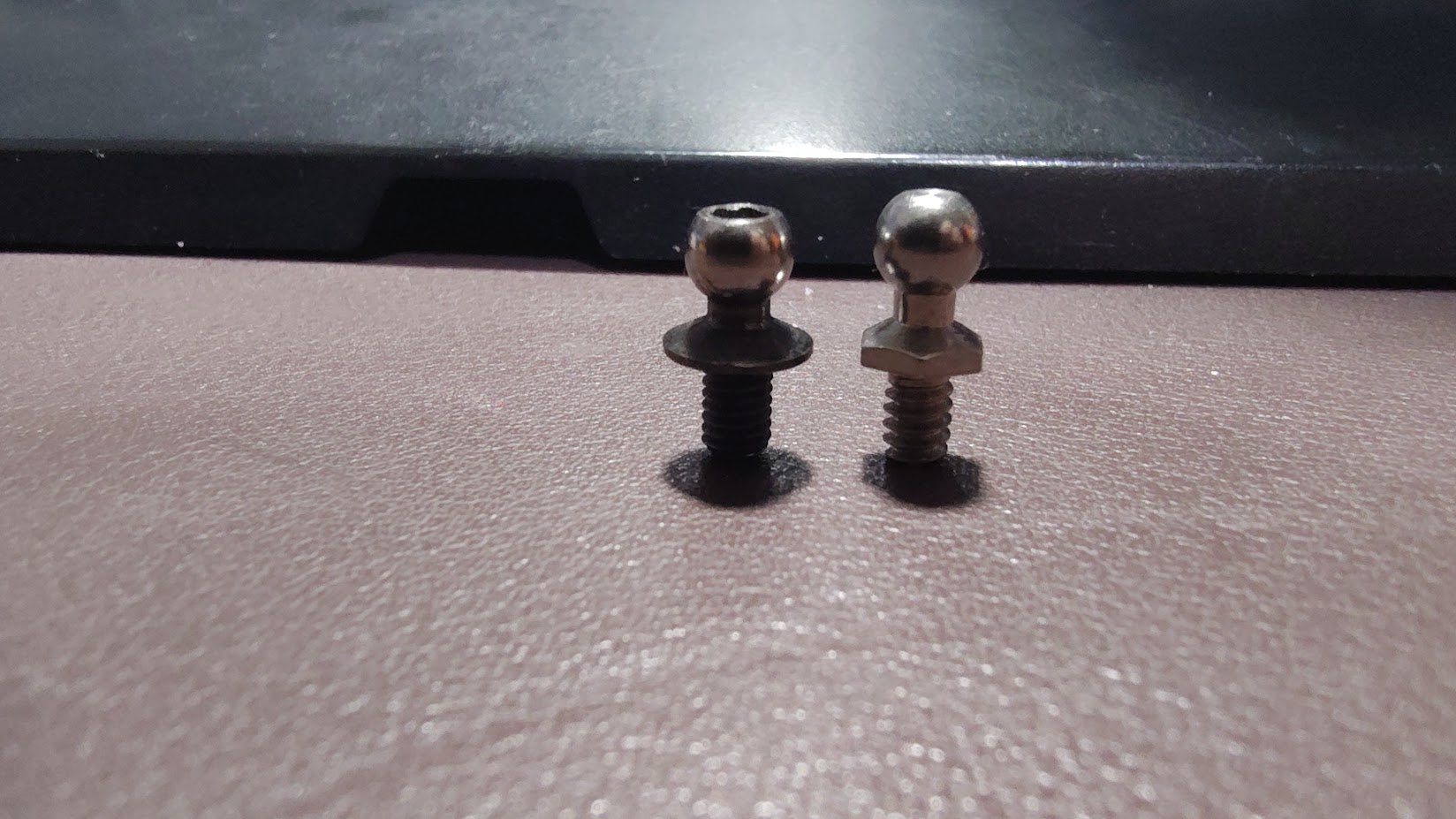

The Fan RC belcranks have material added to the ballstud areas meaning they have more thread engagement than your setup. The pic I posted earlier shows what I'm talking about. This is also what I was saying would need to be shaved down.
I got curious so I looked at the Schumacher ones and they are slightly longer than the Fan RC ballstuds (by 0.4mm), This means you could just shave the bellcranks and be good, hopefully.
Schumacher on the left, 4.49mm. Fan RC on the right, 4.09mm

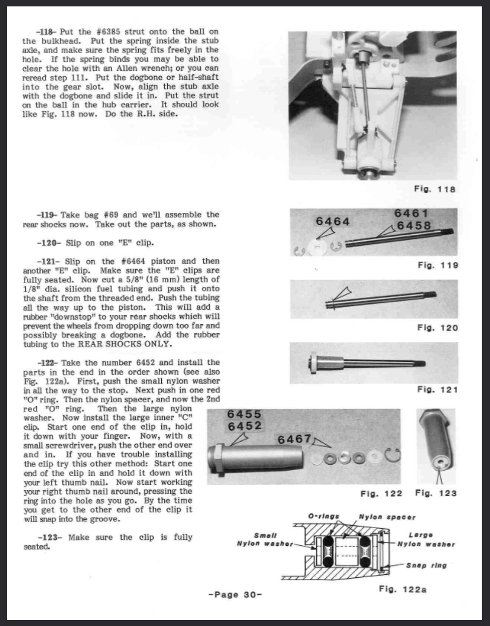

Can I bring this back to the shock shafts for a moment? So there's an issue with the front shocks only right? It sounds like the spacer included in the kit is for shorter shafts than the ones included in the kit? So there's two options... one get the shorter shafts or two get different spacers? 3/8" worth?
Re: Fan RC FR-01
Posted: Tue Aug 13, 2024 1:31 am
by GoMachV
Rear shocks, not front.
The rear shocks included are the 1.32 with 1.32 shafts. Same as all the rc10 buggies used except the world's car. Here is the page from the rc10 manuals. See the amount of spacer used?
This page is from the world's car which had the same 1.32 bodies but 1.02 shafts, note the much thinner spacers needed.
I suspect somewhere AE forgot what to do, similarly to many, many other little things they have got wrong on their rereleases- some as simple as forgetting to include holes. FanRC copied AE, which means he copied their failures too- like the rere world's trans and shock shafts
