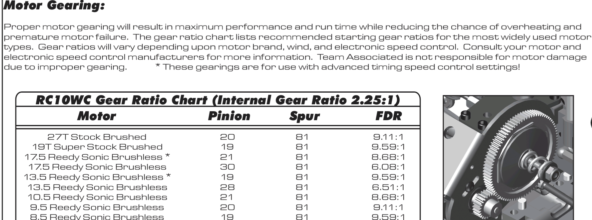

This is the gearing guidance from the RC10 Worlds car manual

scr8p wrote: Fri Nov 03, 2023 8:16 am
tripedaler wrote: Fri Nov 03, 2023 7:24 am Any thoughts if I’m running the 16t pinion?
A 16 is too small for a stock motor.
Good point - no idea why the guy at the hobby shop insisted on a 16t! I’ll order a 20t for my 27 turn motor and an 81t spur. Both 48 pitch.
