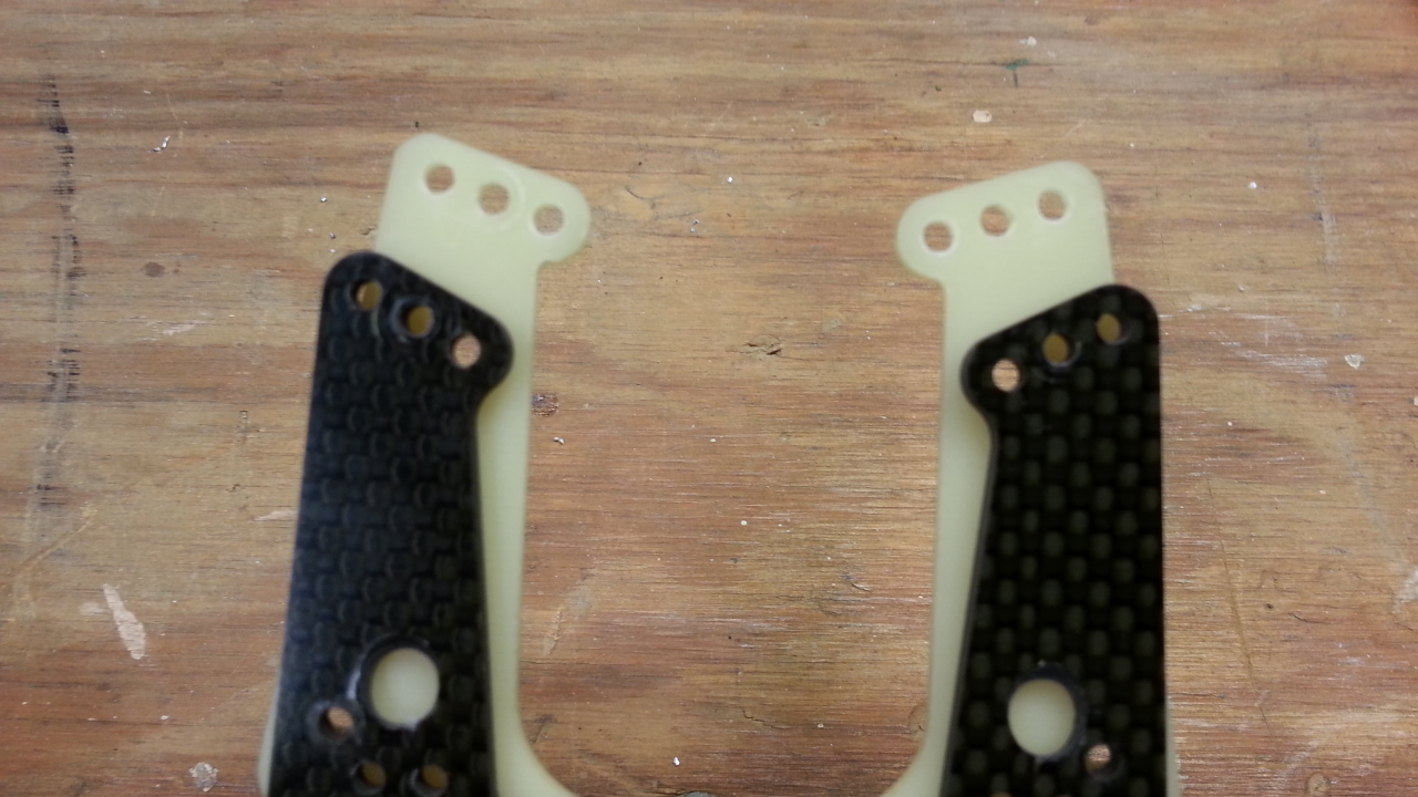

It looks great. When did we get on that subject?
Here's how I see it.. The RPM Worlds tower, The CC Tower and any of the towers that are made for 1.02 and .71 shocks are no good for racing an RC10 with .89 shocks using the narrow front nose. You can use them all day long for a car on the shelf. I would not use them to race with. YOU CAN in fact use that tower with .89 shocks if you are interested in drilling some new holes in them as was mentioned. Again, if it were me, I would not do that. I'm pretty sure the guy building a car in this thread has intentions to use the car as well and my suggestion was to him to use the Worlds tower with 1.02 shocks OR he can get a B3 tower and drill it to fit .89 shocks. He asked this question, I answered with what I would do... If he wants, all day long you can finagle some .89 shocks on those other towers and if he wants to do that, Great! I would not encourage it. If it were me, if I had one of the RPM knockoff towers, I would run the car with 1.02's up front and call it a day. Which is what I think he decided to do.
Its great that you have a one off tower that nobody can get and if they were available, I would have pointed him in the right direction to buy one. But up to this point, there is nothing readily available that is made to bolt up .89 shocks on a narrow nose plate that IMO would function properly.
In any case, if you are interested to see what mine looks like, here it is:
And trust me I stare at it all day long thinking its crooked... Its not. The weave in the tower is crooked,

i asked your opinion about the droop to show you this:
this is my prototype .89 tower over top of a c.c. worlds front tower. when i designed my tower it was supposed to be .89's up top, .71's on the bottom. well, something got lost in translation and the bottom ended up becoming .89's, so the top row was removed before the file was finalized and my tower was cut. take notice that the holes on the c.c. tower that are "supposed" to be .71 holes line up almost perfectly to the .89 holes in
my tower. i could put that c.c tower on my car and there's be like zero difference in the suspension travel.
there's also plenty of room to the outside to add another hole if it was wanted. you could even use a b3 as a template to add the outer hole and reshape the tops if you wanted to shorten it.
but i get the fact that you want a direct fit tower. maybe one day something will be available. i'm done hi-jacking this guys thread now.
