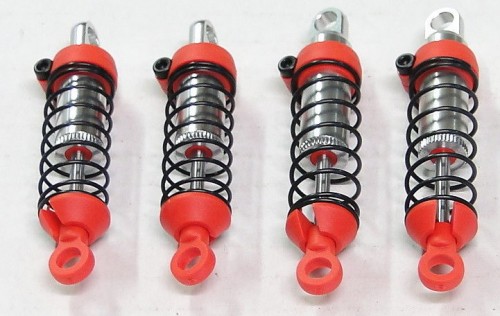

If you're looking for a cheap runner set of shocks to substitute for Kyosho Golds, 3Racing makes a damper set for the Lazer ZX-5 that works great with minor modifications, and at $23 or so for a set of four, you can't go wrong. I have a set on one of my cars and if I was out of Golds, I wouldn't hesitate to buy another set.
http://www.3racing-parts.com/shop/kyosho-lazer-zx5-chassis-aluminium-front-and-rear-damper-blue-color-for-3racing-zx501bu-p-10001396.html
They need to be shortened a little bit, which I did by using short 4.5mm ball-cups and putting 3 to 5mm plastic spacers under the shock pistons which reduces the uncompressed length by that much. I also found the shock oil they're built with is a bit too thick; the shocks worked perfectly with 30-weight (if I remember correctly) and opening up the piston ring holes a little bit. But by all means, if you have Golds, use 'em...you won't find many shocks that perform better.

Equalizers. Teflon-coated shocks. Velvets. Big-bore velvets. Kyosho shocks are just shockingly good.Coelacanth wrote:But by all means, if you have Golds, use 'em...you won't find many shocks that perform better.
Re: Kyosho Raider rebuild
Yep, they are a perfect fit, put them on mine a while back. They're fun to bleed, though.ipenalosa wrote:I have purchased the new scorpion shocks in ebay, and fits perfectly.
