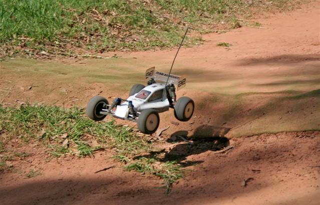

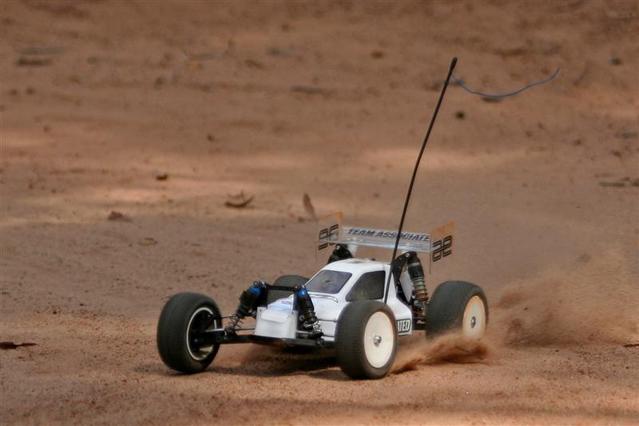

Gave it a go today, just had a problem with one of the front driveshafts bending due to binding at full lock. I set the servo limit to not go to full lock but had a bad landing off the jump which forced it to full lock. Problem with full lock is it goes over centre on the steering link and can get stuck there. So i'm just sticking some limiters to the steering knuckles to stop it turning too far.
Until that happened it was going alright, put the baldest tyres I had on the back and it was impossible to spin out really, just counter steer and give it more throttle!

Thanks! Raced it in 4WD stock at the race meeting today, had the same problem with the steering locking at full lock if I landed the wrong way off a jump, I think i'll have to modify the steering rack so it can't happen, just need to make a rack with the link holes a little further forward. Apart from that it went pretty well!
Got a couple more pics, there's a video too of one run which i'll get up soon.

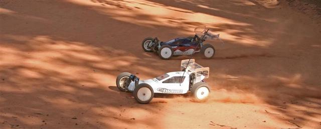

Yep lastenfield it's the 89 worlds track which amazingly had remained mostly unchanged for 20 years. That was the last race meeting on it though, this week it's getting completely redone.
Yeah it was a lot slower than a couple of cars running 13.5's (they should be running 17.5). I was running brushed, probably undergeared. Only had 10.5:1 FDR, motor was only warm.
Thinking of trying a one-way in the form of a Losi XX-4 clicker thing adapted to the rear pulley on mine to see how that handles.
