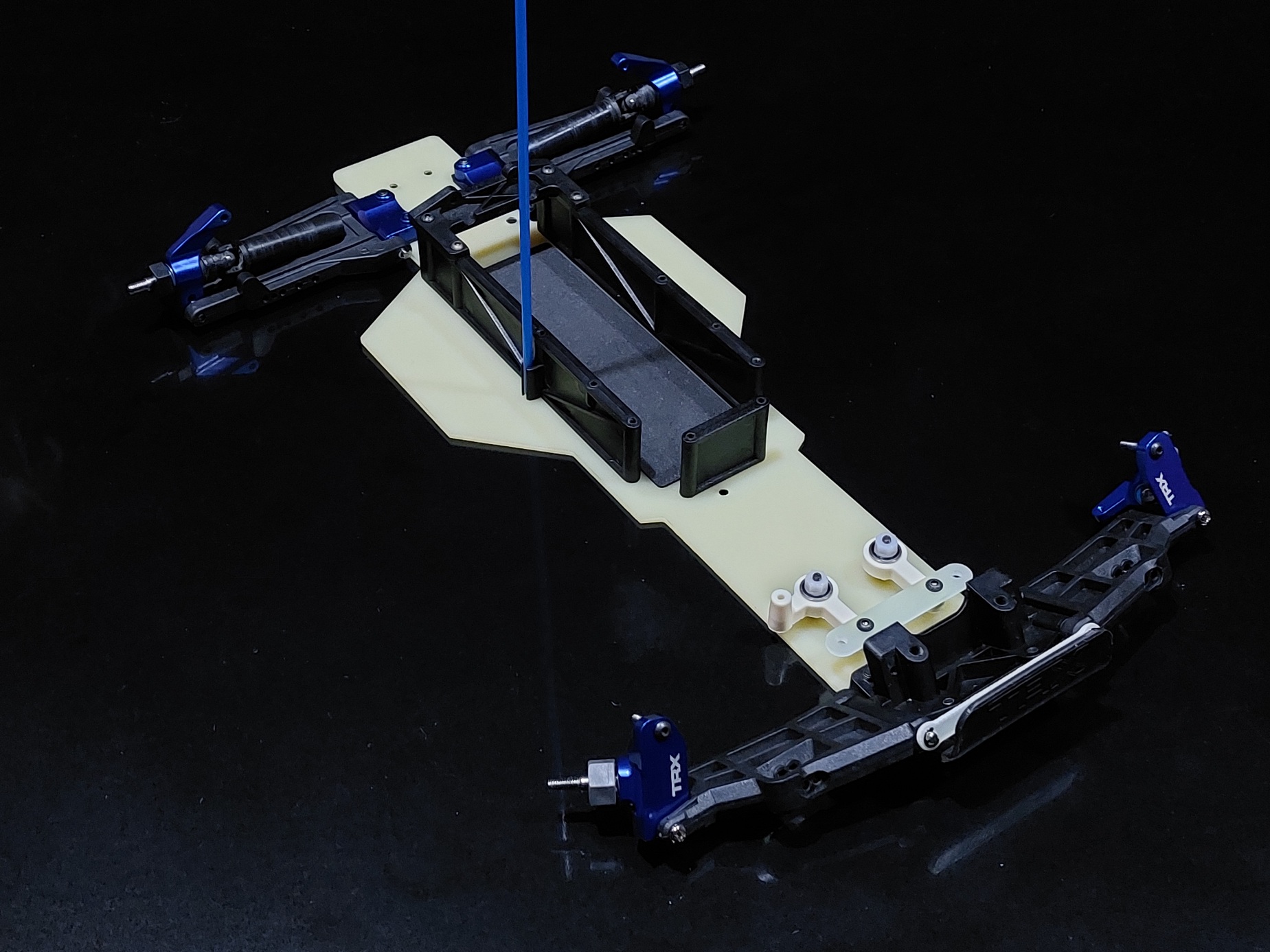

What do you do when you have 89.7% of a complete truck?
You build another one..... a runner !
After all was said and done it turned out I had a bunch of leftover parts including some pretty fancy ones at that. All I had to do was order another Factory Works conversion and a pair of slash rear arms.
Since this will a runner I swapped out the worst chassis of the bunch. This is what I started with.
I was never going to use these blue bits but why not do a Pro TRX-ish build, and I must say so far it's turning out much better than I thought it would

Uh oh.... 'pretty fancy' parts doesn't sound like making a runner. I think these leftover parts have some rabbit DNA in them. They know how to multiply their numbers.
Looks like a nice start! Maybe too nice for a runner.

These SRT’s are pretty cool, and this one is looking very nice so far. So is this number 3?

Thanks, this one makes #4. I didn't plan on it, it just kinda happened
Frankentruck wrote: ↑Wed Dec 11, 2024 9:07 amUh oh.... 'pretty fancy' parts doesn't sound like making a runner. I think these leftover parts have some rabbit DNA in them. They know how to multiply their numbers.
Looks like a nice start! Maybe too nice for a runner.![]()
They do seem to be like rabbits, I wasn't going to use the blue parts anyways so I guess it doesn't matter, but if it turns out great it will be all that much harder to get dirty and scratched.
