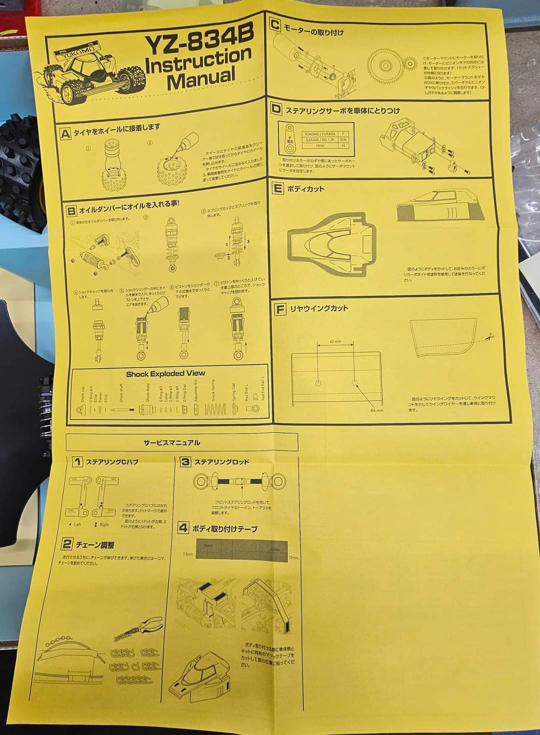

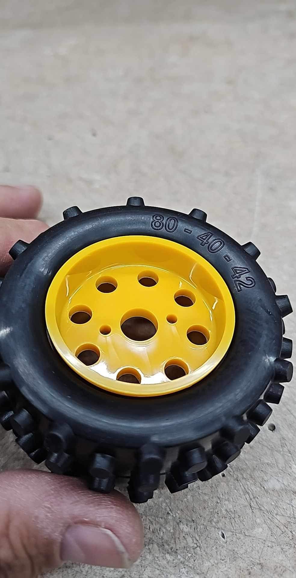

Couple pics of the 834b rere. The rear mono shock portion is a bolt on and has adjustable down travel limiters, and is bearing supported. The rear stabilizer bolts to a fairly original looking support but they drilled a couple holes for setscrews. The parts are mostly compatible-ish, but all 4mm holes are now 3mm and the front bulkhead is now 4 screws instead of 2. Just changed enough to not be bolt on compatible. Also I love what they did with the shorty lipo holders, they clip into the stick pack tray. Very smart.
Last pic shows our new chassis and front mono shock mounts
