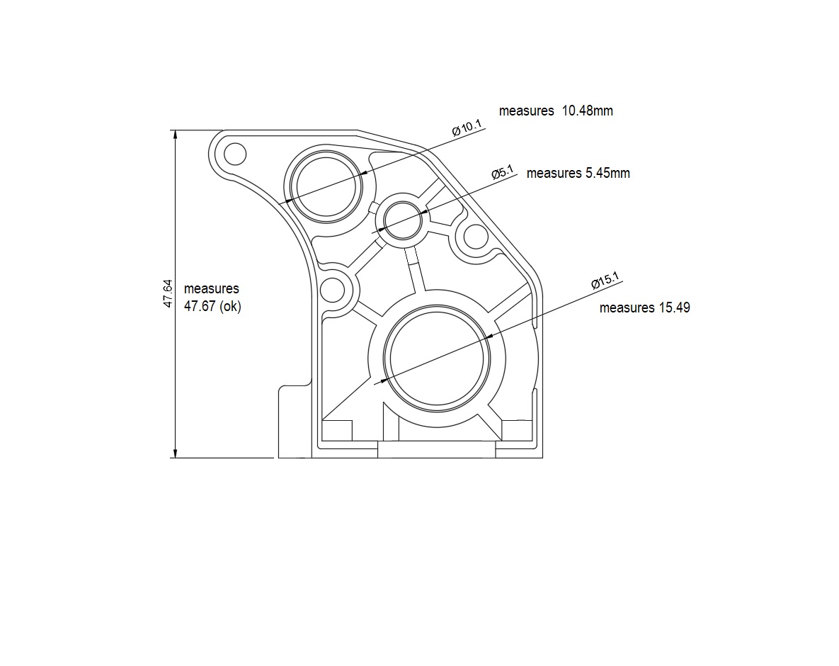

Looking back through the thread, I was planning have a gauge block printed to aid sizing the bearing bores but I never got around to it. Anyway, I believe this question has been answered before but perhaps it’s buried in another thread somewhere. The case halves will printed using MJF; can anyone offer some guidance on the printing process allowance to accurately size the bearing bores to achieve a snug press fit? thanks.

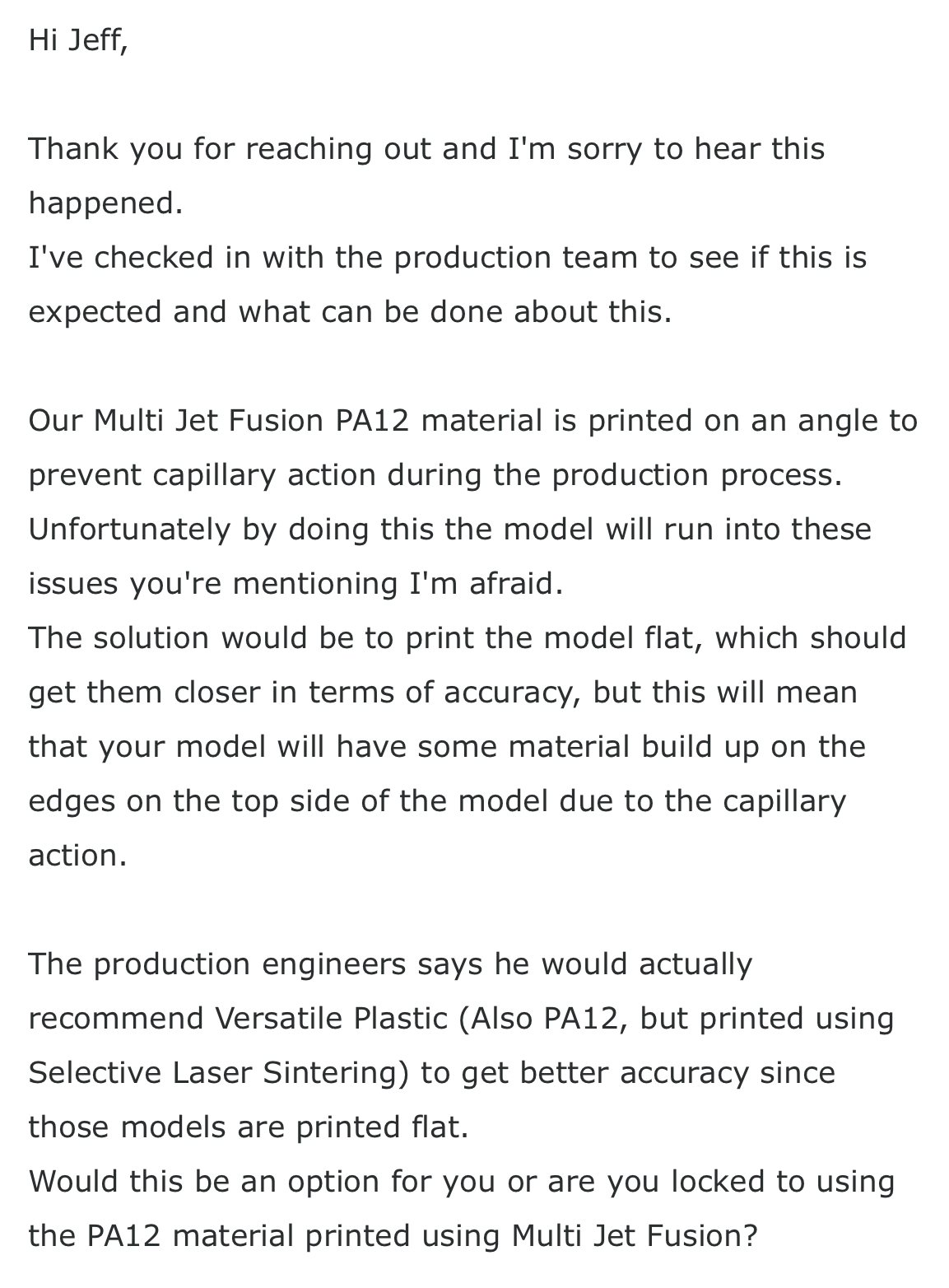

If you are hiring out the printing, you will need to print a gauge and see where it ends up. My attempt to use shapeways to print was around 5% out of spec instead of the .4-.5% they list but only on the holes, not the other measurements When I inquired they told me it was due to the process and to be expected. Their tolerance chart means nothing. The reprint in sls was also loose and I gave up on shapeways after throwing away $100 worth of prints.

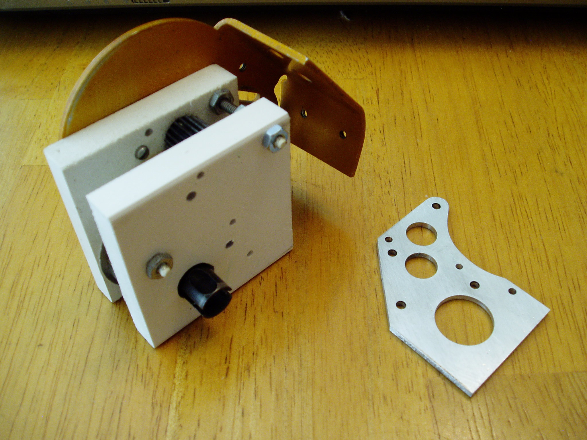

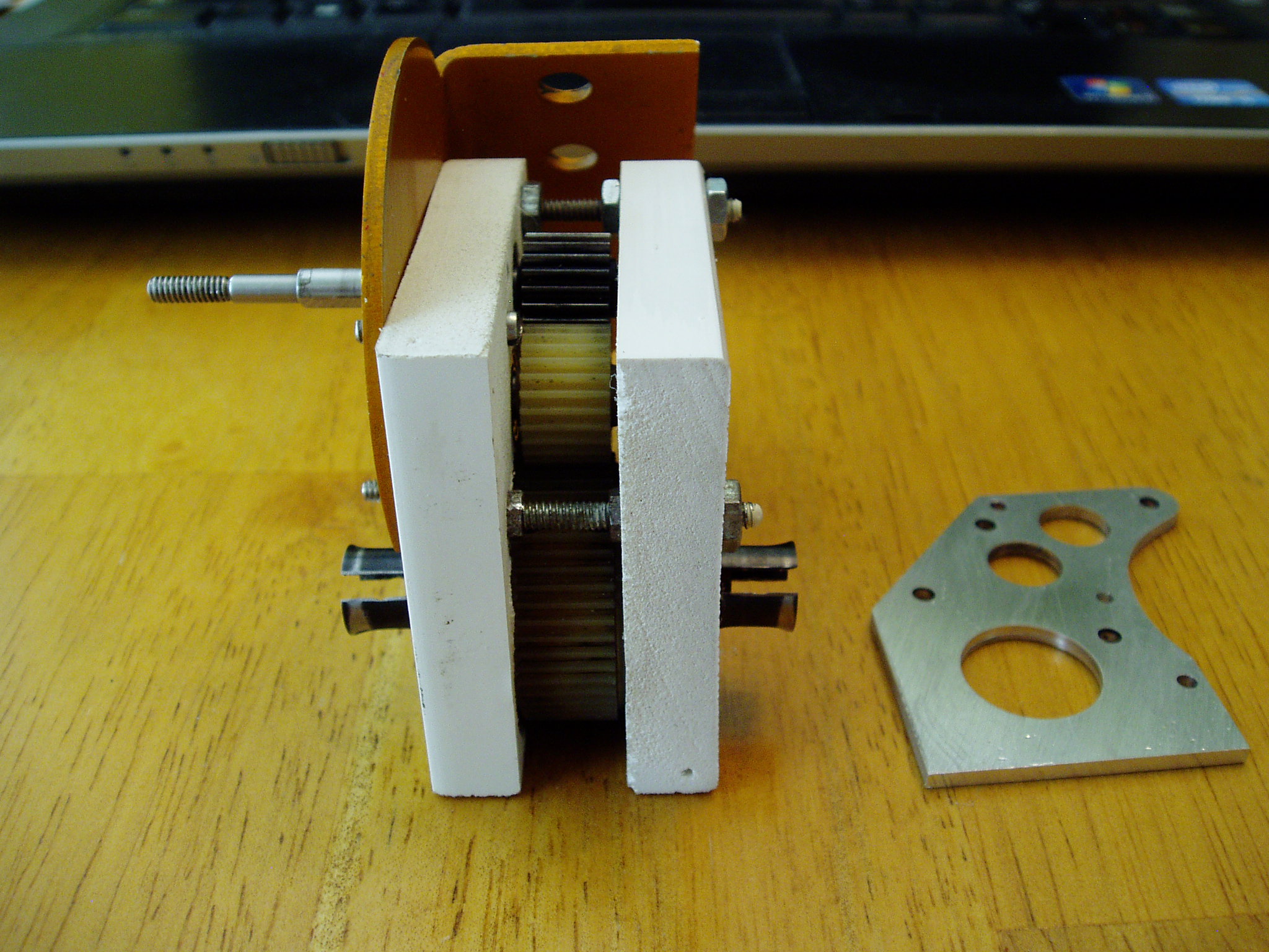

Hey Jeff, can you use your CNC router to make a pair of side plates similar to what I’ve done here?
I’m assuming that your router is far more accurate than any 3D print.
The plates will provide a way to check your design (critical features like gear circles, bore diameters, screw hole spacing, etc.) and allow you to make needed corrections before sending your design to the molder. When the production molds are finished, the molder can send you pre-production inspection samples for you to verify they have accurately captured your design. If the inspection samples reveal some inaccuracy, the molder is obligated to make corrections – they shouldn’t charge you for their mistakes.
Anyway, it's just a suggestion to help you move your project to completion. I really want a set of your cases.

I've managed to locate a spare printed idler pulley from the Mid (Polyamide MJF from iMaterialize).
The bearing bore measures ~7.9mm for an 8mm bearing so maybe I'll use 0.1mm allowance for my cases.
In any event, when the prints arrive, I will carefully measure the bores and document that for future reference - something I should have done before.
