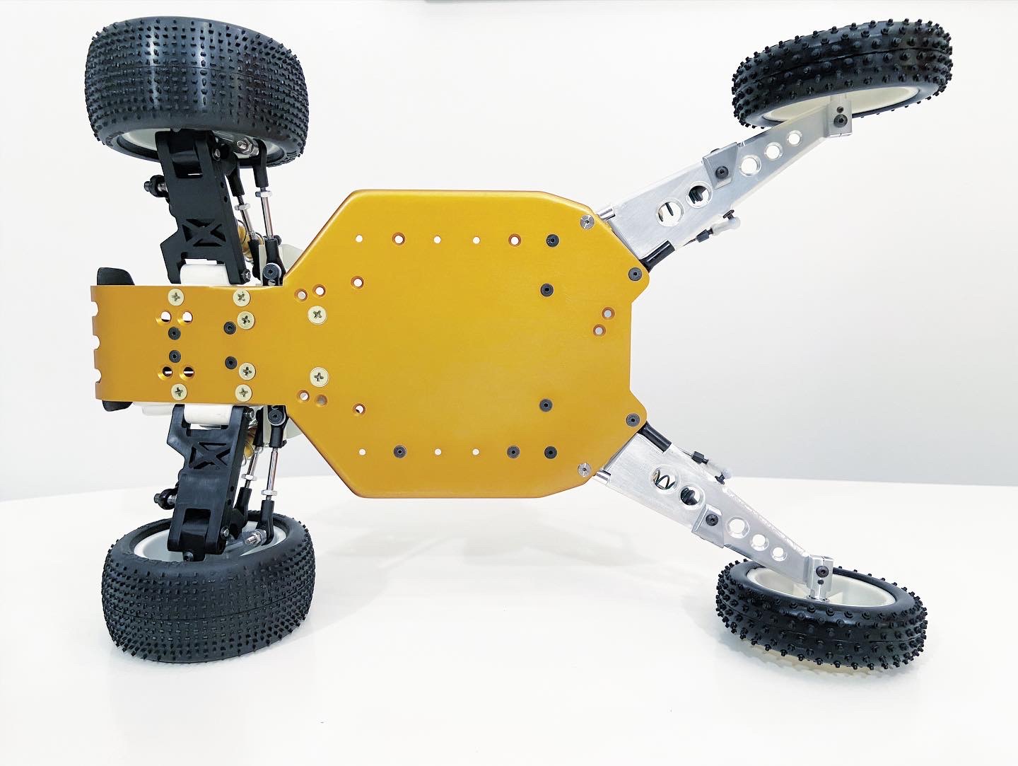

sandkil
Posts: 1076
Location: Stockholm Sweden
Has thanked: 782 times
Been thanked: 585 times
Re: RC10 FF
Post by sandkil »
Worked on the trailing arms and have to consider them done as far as for the M2 grub screws that will fix the toe in adjustment.
It’s almost a finished roller.
Wishing you all a Merry Christmas and a Happier New Year!!

Wow Erik,
Those trailing arms are beautifully finished. i love the holes on them, makes them look industrial!
