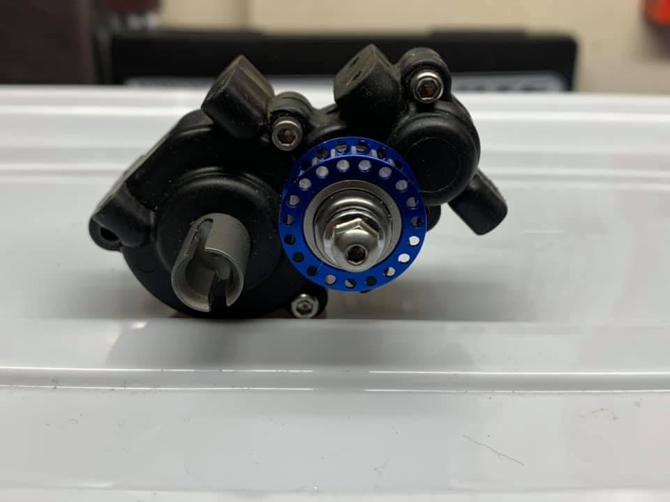

Here’s the starting point:
Had to find a long enough shaft that would protrude out of the transmission to be able to mount a pulley onto it.

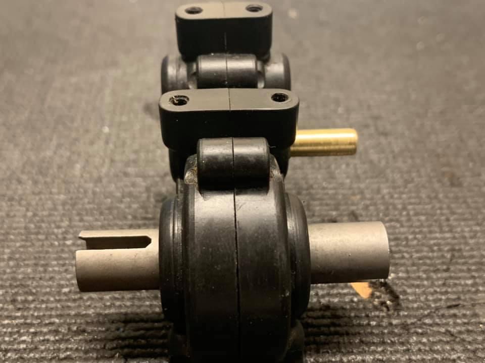

These are 1.2” long, 4-40 threaded standoffs with an outer dimeter of 3/16”, PERFECT RIGHT?? Nope? They are actually a bit larger than 3/16, had to ground them down a bit to fit in the bearings

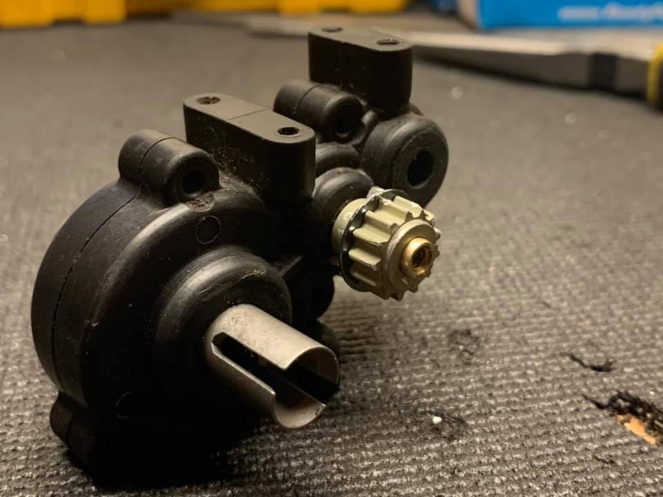

The pulley is a Sakura drift car 13t center pulley, and the inner diameter is 4mm, so I had to grind down the outer portion of the shaft to fit in the pulley, drilled through the shaft using the set screw hole as a guide, and fastened it on the shaft using an m2 screw and nut.
