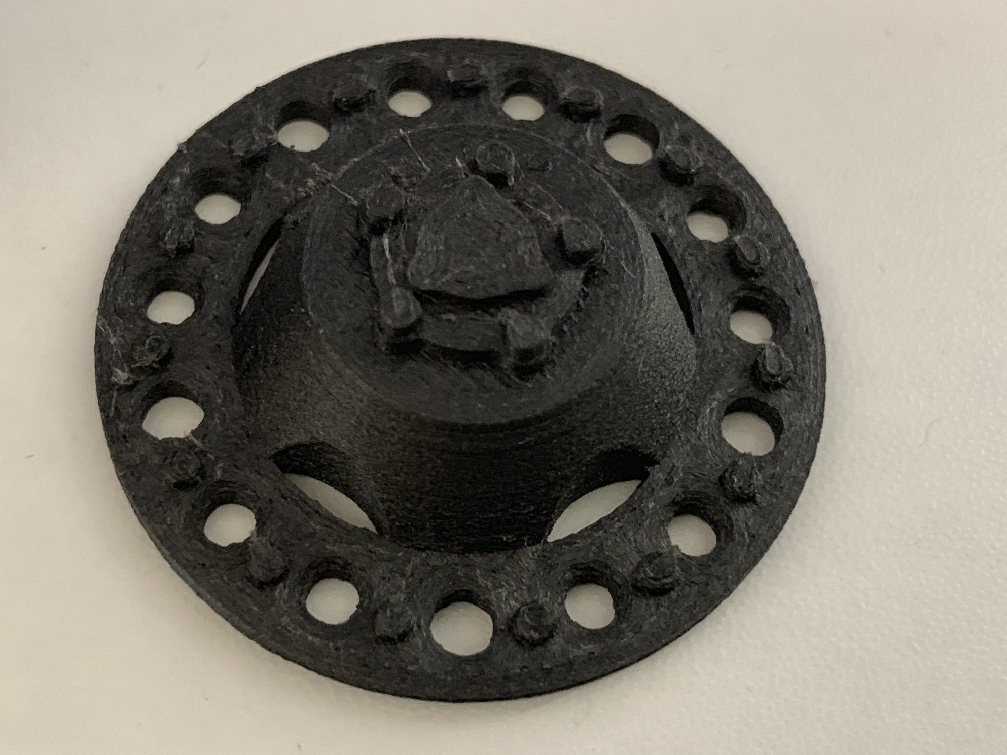

That Schumacher hex adapter is down right clever Dadio!
Did your friend need to do anything special to mount the hex wheels? Schumacher wheel screws are 3mm while typical 12mm hex wheels have a 4mm or larger hole. A collar perhaps?
- Posts: 4055
- Location: Guildford UK
- Has thanked: 2705 times
- Been thanked: 2237 times
Re: Dadio's 3D Printing Stuff
He just used a longer screw and a washer , we did think about printing a stepped washer that would sleeve into the 4 mm hole but so far there's been no problem , we went out for another half hour drive this evening and he even kerb'd it ! I'm quite surprised as they are only printed in PLA , its good quality PLA from 3Dmars , they are even printed flat on the hex so the layering is in the worst alignment for just shearing the castleation's off .
