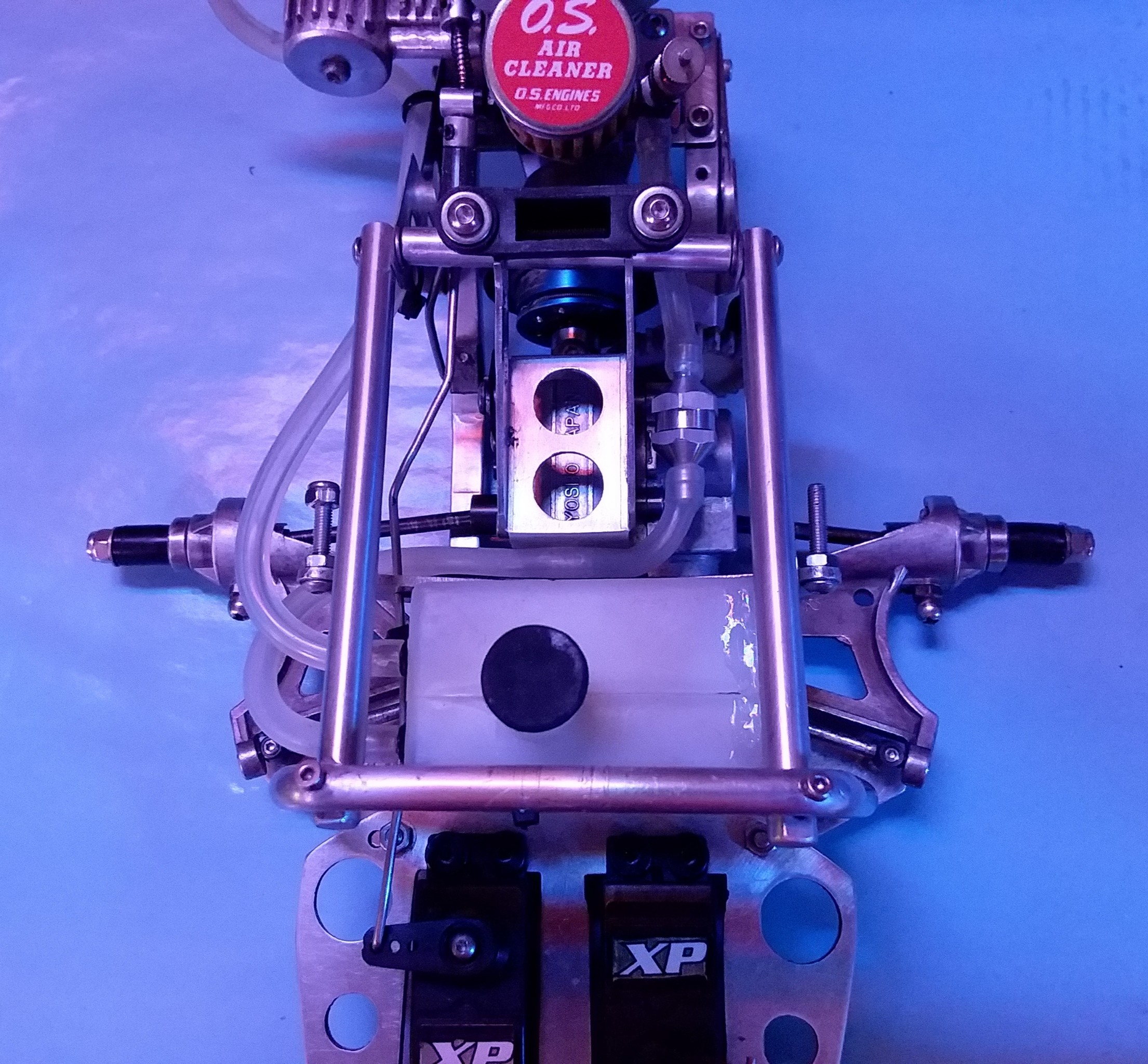

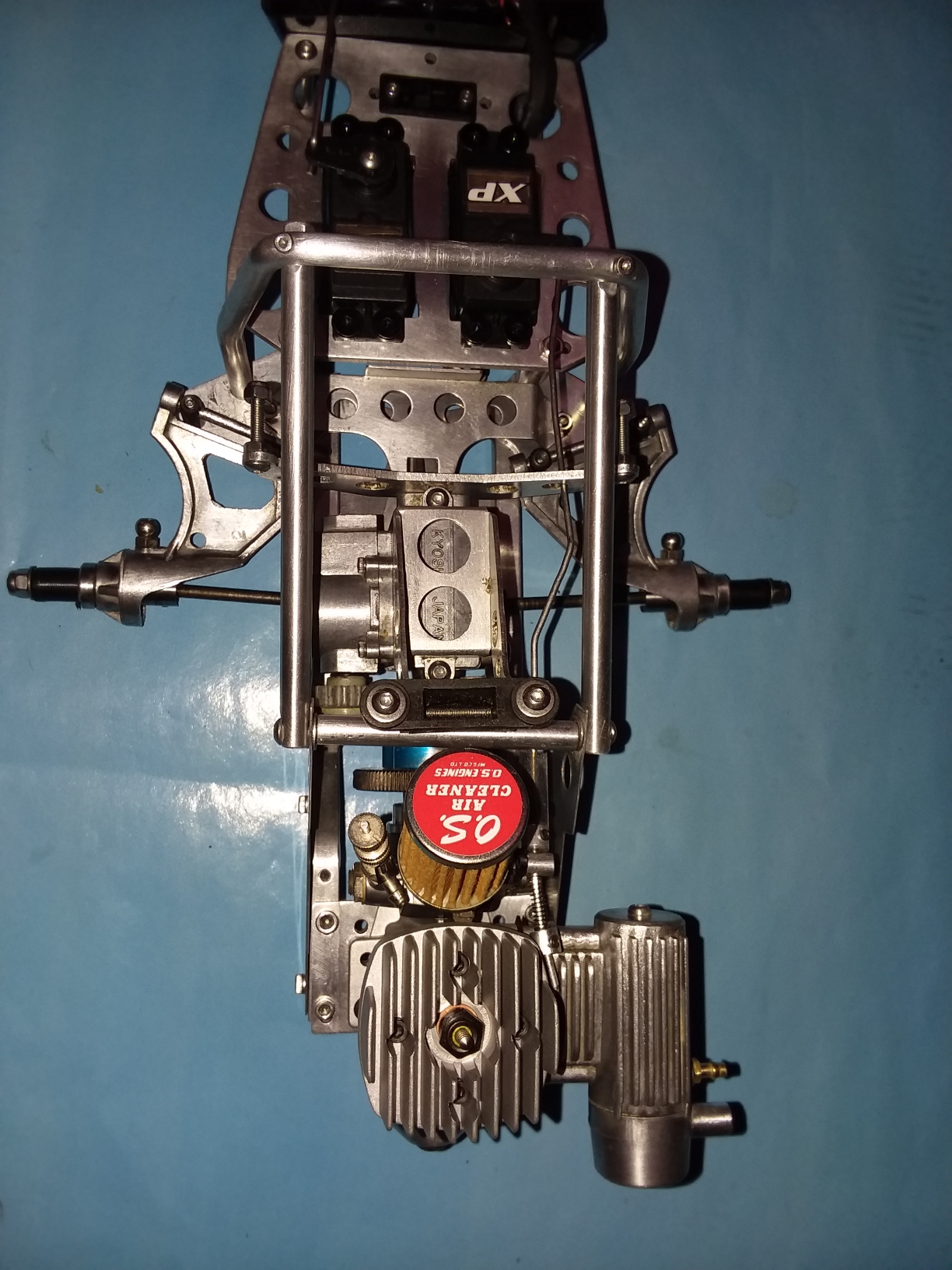

I don't know anything about these cars. Why did they put the engine so far off the rear end? What is the yellow wire that runs to the front bumper? Thanks.

Not real sure on the engine. I think it because they modified a Cox Scorpion for a nitro engine. The yellow wire is for the glow starter, i dont have it for the basket case car. It was gone when i got it. U put a "C" battery on the front bumber in between the springs, It fired up the glow plug via that yellow wire, kinda a cool.

Went with a custom fuel tank. This basket case didnt come with a tank. My Nitro Brute tank had to be cut open and repaired...and i am running a rc10gt tank in that truck now, so i decided to fit the modded Nitro Brute tank in here, hopefully it doesnt leak cause it fits great

The reason why the assault has the engine at the very back like this is historical. Bitd, the first IC offroaders were using cone starter engine from RC planes. The only way to start them was to position them that way. A lot of the early offroaders, especially japanese designs had that "feature", Hirobo were doing it that way too. Also, tire technology was very basic, and the cars needed all the weight they could get on the rear tires. As a result, the cars would pretty much only go straight and then swap ends as soon as you'd lift the throttle, but, hey, this was good fun anyway
Where Kyosho had it kinda wrong is that, in the mid-80's, this was already a long-abandoned technology... then again there weren't that many 1:10 IC buggies, so they probably couldn't redesign a car from the ground up for low volumes, hence the scorpion architecture, which was rear-engined anyway. And who cared how (poorly) it ran, it was just to goof around as there was no 1:10 IC racing anyway
