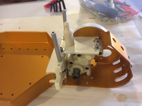

So my bearings finally arrived from Avid and some new nuts and bolts so I’ve got the rear end and gear box rebuilt now.

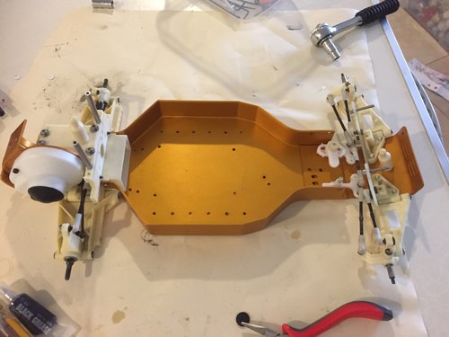

Rear arms on now and shocks. I didn’t fully rebuild the shocks, just cleaned them up on the outside, drained them and refilled with fresh oil.
I think I should probably get new wheels and tyres if I’m going to run this thing. Any recs?
I have the motor it game with, an Old ESC and Futaba radio, servo and receiver. I was just missing crystals, they came in the post and I realised I bought AM ones by mistake. Should be FM. 🤦‍♂️😭

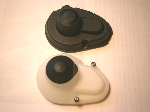

Looking great. What do you think of the RPM gear cover? I've always thought it was a little large compared to say, the World's re-release black cover.

I think the RPM cover was designed to clear the VTS clutch setup.
I myself, for this car, would look to grab one of the rere covers from the Classic (if they're still available). Or an aftermarket one from OldRC.

NomadRacer wrote: Mon Dec 10, 2018 12:15 pm Looking great. What do you think of the RPM gear cover? I've always thought it was a little large compared to say, the World's re-release black cover.
hmm, now you say that. Maybe it is. I’m not knowledgeable on these things like you guys. I just picked this up from AMain website. I didn’t realize there was more than one kind! Maybe I’ll change it later but all these orders and the shipping to Dubai is racking up the costs. My wife is wondering when I’ll be finished with this. 😂

scr8p wrote: Mon Dec 10, 2018 12:25 pm I think the RPM cover was designed to clear the VTS clutch setup.
Oh man. Another part where I’ve bought the wrong thing. Didn’t know there was more than one type!

I didn't realize you where in Dubai! There's slight differences between the black Associated cover and the RPM, not that much though... A little "sleeker".

I forgot to give you the part number!
Associated #6566 GEAR COVER, RC10WC
