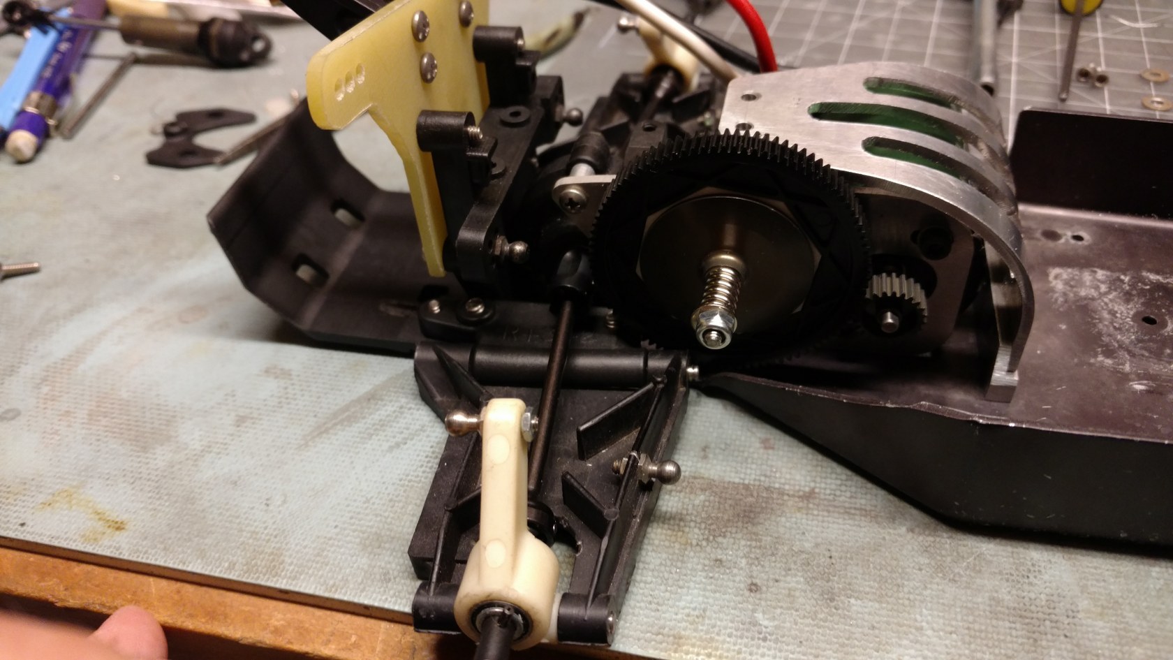

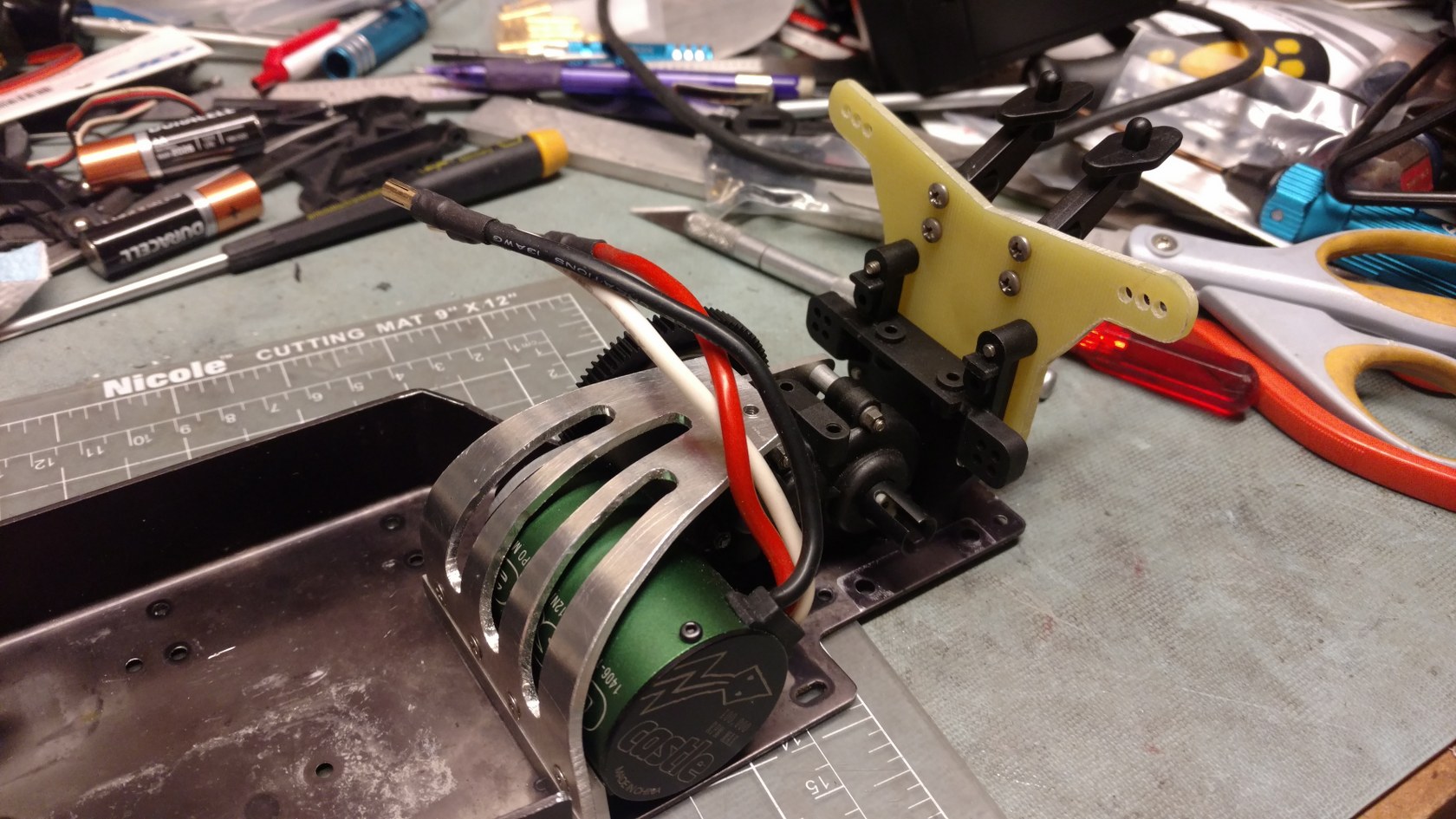

I know it's not quite the same, but I used aluminum to make a waterfall bracket, the motor sits flush and it's pretty stiff. You might be able to make something similar out of plastic, beef it up quite a bit of course. I utilized the existing motor bracket/mount holes, three of them. I wrestled with this area for a while before I decided on this approach.
discgolfer72
Posts: 336
Joined: Sun Mar 17, 2013 5:36 pm
Location: op kansas
Has thanked: 21 times
Been thanked: 36 times
Re: pair of rc10gt-e conversions
Post by discgolfer72 »
jwscab wrote: Thu Aug 30, 2018 11:45 am I know it's not quite the same, but I used aluminum to make a waterfall bracket, the motor sits flush and it's pretty stiff. You might be able to make something similar out of plastic, beef it up quite a bit of course. I utilized the existing motor bracket/mount holes, three of them. I wrestled with this area for a while before I decided on this approach.

No, the work was all done by hand; well, a drill press and the lower bracket was milled, but it didn't have to be.
I should have made a copy before I bent it, but i used cardboard to make a mockup and transferred it to the aluminum sheet. The material is 1/8"
the lower bracket is 1/4" x 1/2" inch rectangular bar. I milled a notch in it 1/4" x 1/8" so the plate sits flush. The bottom bracket picks up the three motor mount screw holes on the bottom of the chassis.
the 'flutes' were hastily chopped out with a series of chain drilled holes and filing. I messed it up, I should have milled it but was taking short cuts. these were done before the plate was bent. I bent it around a piece of steel bar I had sitting here. maybe 1.5" diameter?
wow, that was a lot of description, it feels like it took longer to write than to do. If you are interested, I'll see if I can find the cardboard template and the actual diameter of the bar I used.
