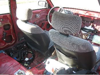

I found it extremely valuable to have a spare harness on hand. Makes it WAY easier to trace wires on the ground and see which pins are what and what goes where. Also if you have a bad connector you'll have a spare.

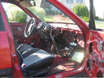

Put some skinny winter tires and about 200 lbs of sandbags in the rear it might not do bad in the snow. But I've owned and driven a car with zero heat and interior in the winter before. Terrible!!!
This was my daily driver junkyard turbo civic gas saver car. Fun little car till it blew from running double the boost it was tuned for.
RC10th
Posts: 4697
Has thanked: 50 times
Been thanked: 1491 times
Re: Project: LS1 Chevette
Post by RC10th »
The dash is...... interesting :lol:
