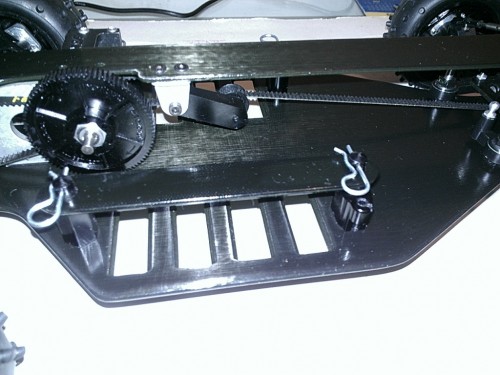

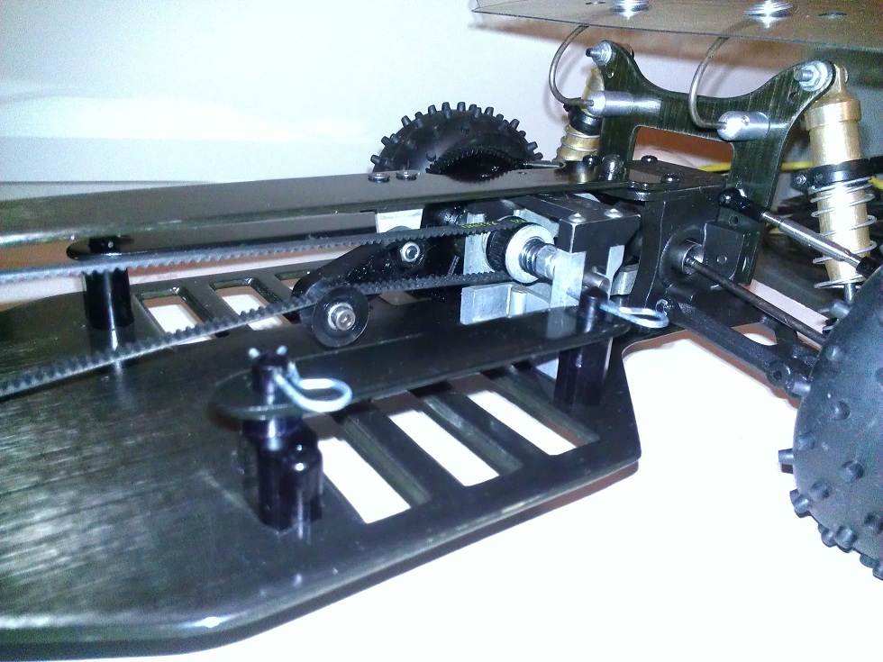

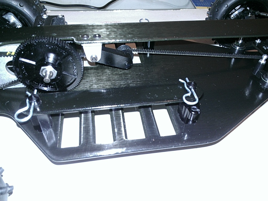

Some of you probably saw this one on eBay not too long ago. I thought it looks interesting, so I picked it up. RPM bulkheads and steering knuckles, nylon rear hub carriers (might be RPM?), A&L steering rack, Ti turnbuckles, Jammin' (?) upper deck, belt tensioner, Andy's front and rear arms, 2mm belt and diffs. Interestingly (not shown in the pics), the diff pulleys are black rather than the usual white. The '91 Works has white 2mm diff pulleys, so I wonder where the black pulleys are from? The owner did mention that he colored the non-black parts black, so maybe they were dyed?
Not too crazy about the chassis and shock towers being painted black, but it's a pretty smooth finish. The four screws on the bottom for the motor mount are not countersunk, so I'll have to replace those with proper screws. I'm neither her nor there on the Kyosho shocks, but I do like the gold and black look, which reminds me a bit of my Lazer ZX (http://www.rc10talk.com/viewtopic.php?f=30&t=32109&start=15). I'm thinking silver/gold flames into a black body would be appropriate here. Not sure if I'll do it on the provided body, which is missing the protective film and has a few scuff marks. Overall quite pleased, though. I have a rear swaybar that I'll probably add to this, and maybe change a few other things (e.g., gotta fix the downtravel on the rear shocks).

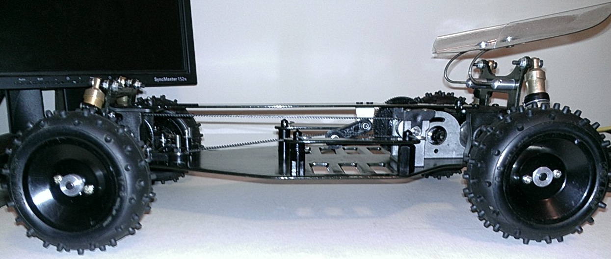

This one is certainly a shelfer, so no need to strip the paint. I think it'll grow on me. I do like the idea of having an all (or mostly) black chassis.
I went through it today and redid the shocks. The rear springs were actually cut, so I tossed those and replaced them with proper Kyosho black springs (also did the same for the front). Also shaved the rear lower deck a bit, to bevel it out more at the back of the rear arms, to get more rear ride height. There were self-tapping screws in the RPM bulkheads. I'm guessing that's how the RPM bulkheads came? Replaced those with hex screws. Also added a TBG 870c undertray. It's a bit narrow, but it fits well enough. Haven't installed the rear swaybar yet. I have two of them and put at least one of them aside for my runners if I need it for tuning. The other one is NIP and I may or may not install it. We'll see.
Next step is the body...

For the top of the RPM bulkheads they are self tapping.. going to swap out mine as well.. going to go hex throughout.. the blacked out look is nice but I have a set of trinity neon yellow wheels for mine that I will use along with a another set of some 2.2 for running that I may dye since they are white.. still getting parts for that one though.. just need a couple turnbuckles for the steering and my custom towers and top deck to get building the roller.. I am just being lazy though..

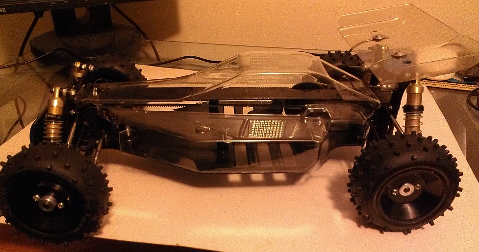

I think I just figured out how I'd like to paint the body for this one...
http://www.sennafiles.com/wp-content/uploads/2013/07/lotus-1986-senna-paul-ricard-1.jpg
Let the decal hunting begin...

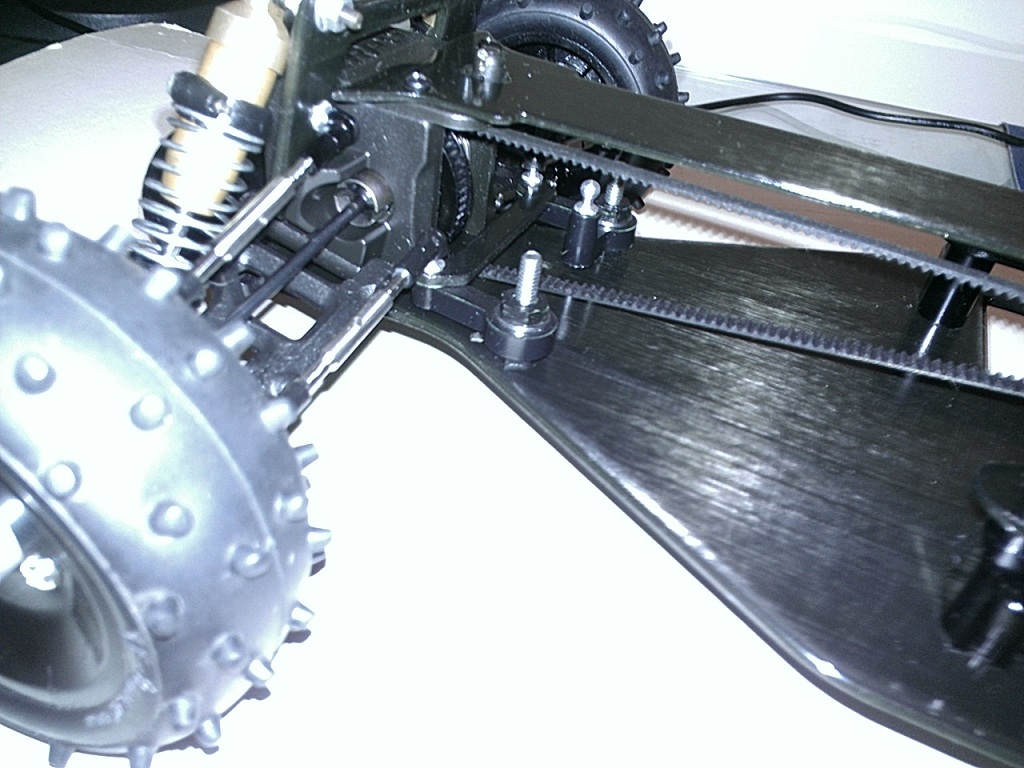

Decided to take off the TBG undertray, because it actually doesn't fit quite right. TBG make three undertrays for the YZ10, and the only one that fits correctly is the Pavidis undertray (which should work on the '93 Works and up). The 870 undertrays are too narrow and that pushes the side pods out. Then the body doesn't fit correctly.

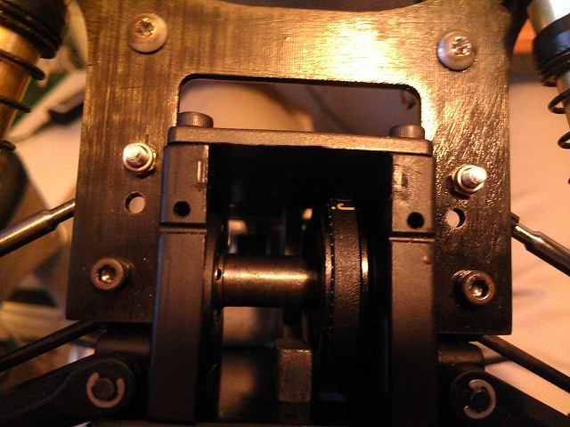

More concerning than that, though (since that's just a piece of plastic) was something I discovered on the rear shock tower last night. It appears that the previous owner was not able to mount the inner rear camber link ball studs in the original position, due to too little space between this ballstud and the rear bulkhead (uh...mount the ballstuds first, then mount the tower on the bulkhead!). So they drilled a hole that is a bit higher up to allow for more clearance. As you can see quite clearly, these holes are not well aligned. So now the rear suspension geometry is cockeyed. That's a blemish I want to get rid of, but since both the front and rear towers are painted, I'll have to replace them both to avoid a visit from the fashion police. Wonderful...

How do you like the rpm bulk heads? I have 1 car that going to be all decked out in rpm bulk heads, and using andys or rpm arms,, and rpm hubs and knuckles. I like the belt tensioner in the back bulk head. All my cars now days are built to be runners. So, do you think the rpm bulk heads will hold up?

Yeah, it's pretty cool. I'm just pissed about the rear shock tower. I may order a front/rear set from Fibre-Lyte.

Hey bummer about the shock tower!
