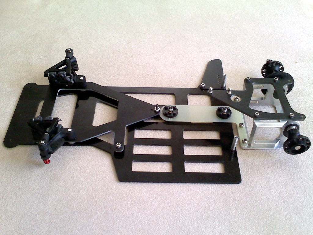

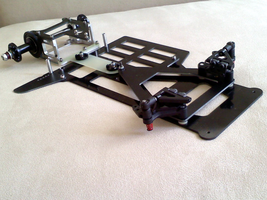

Truth is, I already know what it is, but what I don't know is how obscure it is...if at all. So basically, this is a test. ;)
EDIT - LTO_Dave scores the ID. :)

Is that the TMS or Penguin(can't remember) OM-10 conversion?

Not TMS...but very close. :mrgreen:

Changed the wrong letter. :x
Besides the chassis the parts on it so far are:
- Niftech aluminum left bulkhead.
- T&A Ti rear axle.
- HPI rear hubs. (not the really good kind...they're off an RS10/Super F1)
- Calandra Racing delrin upper front arms.
- Hyperdrive brass pivot balls in the front suspension and t-bar.
I have a new unpainted Associated T-Bird body for it as well.

LTO_Dave wrote: Where did you pick up that beauty?
Got the chassis off eBay a couple of months ago. The parts were advertised as new, and look it, but the kit wasn't in a package and there's one or two parts missing....most noticeably the rear cross brace that the lateral shock mounts to.
Front suspension pieces, t-bar, pivot balls, and lower pod plate are all NIP pieces I picked up here and there. Rest of the parts are nice used pieces I picked up in lots over time.
BTW, this is the fiberglass kit.
