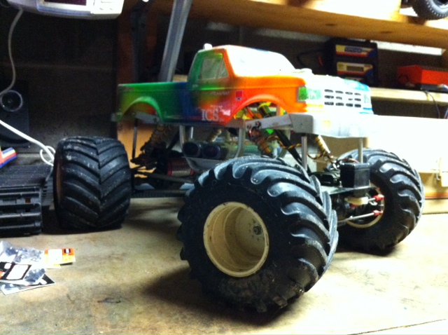

I've got a Clod with the Clodzilla II ladder chassis and a homemade 4 link suspension to mimic the Clodzilla setup. I also have the single floating shock kit that compresses the shock from both ends with anti-sway bars mounted front and rear, wheel widening kit and separate servos for the front and rear steering. I've got full ball bearings and twin Venom 4200 brushless motors and 80A ESCs. The truck is fun and has plenty of speed, but really lacks control-ability. I'd love to have that realistic monster truck suspension and keep the 4-wheel steering but I would prefer to have better control over the crazy thing. My Clod would never be competitive as is, even against other Clods. Could anyone offer up some suggestions on where to start or what to add/delete from my current setup? I really like the apparent performance of this Bigfoot Powers Clod! Very impressive. I have never checked out the Clod Talk site before and may end up venturing that way, but RC10Talk covers such a variety that its just so much more appealing!

get rid of 4 wheel steering. that will help keep it going straight.
get the best servo you can afford, the tougher it is the better it will hold zero.
you can grind off the nubs on the front steering blocks to regain a little more steering.
tighten everything up, the less slop the better.
what pinion? if stock then get mounts and go up to 16tooth. top end will increase but it will be more controlable down low.

Thanks for the initial tips. If I can remember correctly, I wore out the stock pinion gears, but replaced them with the same tooth size. I've got everything tight currently, or at least snugged up to minimize slop. I do need to fab my new steering linkages though. There is an ever increasing amount of slop in my original red Tamiya ball ends. I have just been in the mind set of "If it ain't broke, don't fix it."
