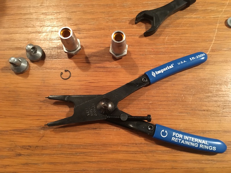

Re: snap ring pliers
McMaster Carr 57805A32, fits shock and 6-gear snap rings perfect
Gonna leave this here on this old thread, 'cause it popped up when I googled for rc10 snap ring plires
