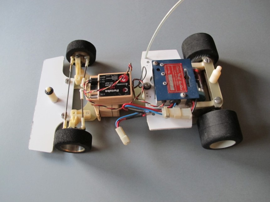

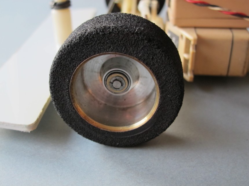

Got a RC12E tody with some unknown parts. Someone has seen stuff like this before?
For the front wheels these look like chrom but are aluminium. The pictures are just some quick shoots in reality these look too good quality for being homemade. Narrower than stock RC12E front wheels.

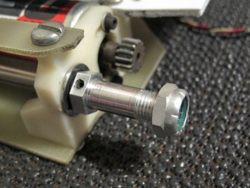

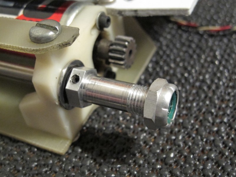

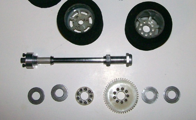

The rear axle/diff could be maybe early schumacher diff or looks similar but with very large metal nut not nylon nut as Schumacher. The left rear wheel is using three small screws for mounting to the hub not the usual two 4-40 screws as original.

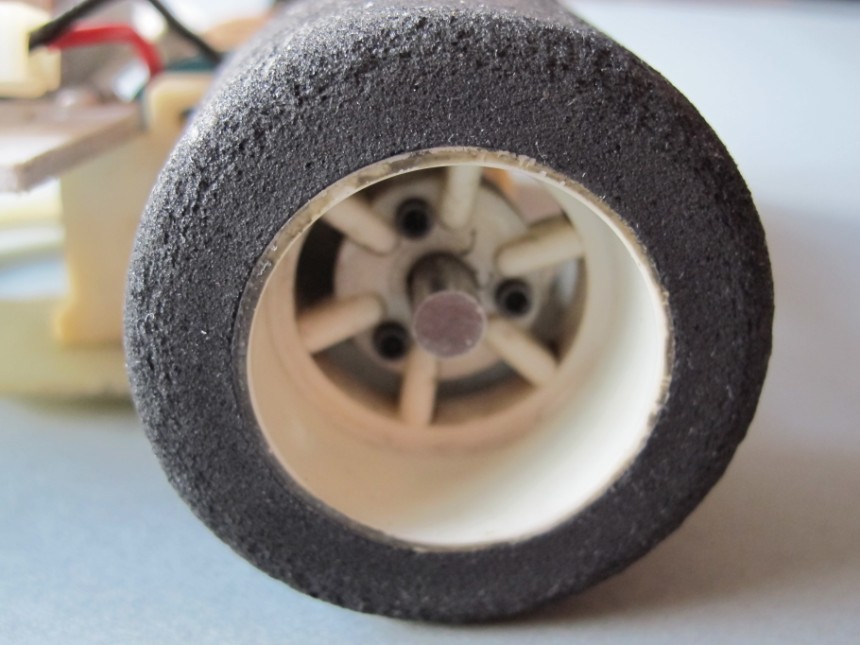

Rear wheels look similar to old Thorp 1/8th wheels, I never have seen such 1/12th wheels before.

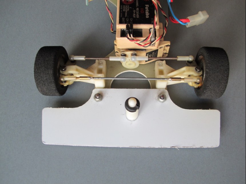

Steering linkage maybe is homemade or maybe any option parts?

The rear wheels can also be from a Leisure electronics car. My Leisure 100 has the same rear wheels and they are stock. Maybe thorp supplied the wheels for leisure because the front wheel in the scan look the same aswell.

I've seen thost aluminum front wheels before but I can't remember who made them. The tires appear to be molded rubber rather than standard foam. The molded front where extremely durable but a bit heavy and not as much grip as foam. I used them on slippery tracks and for enduros.

The rear wheels are Thorp. Leisure and a few other companies probably sourced them from John Thorp.

Thanks for your informations. Yes the front tires are very hard so could be that molded type.
The Thorp wheels are looking very nice.

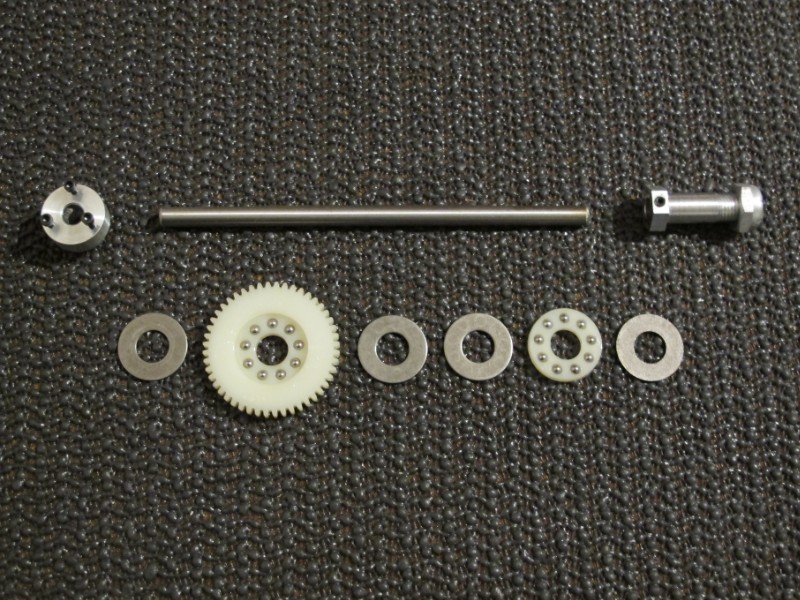

I will disassemble the diff maybe next week for having a closer look. The rear axle looks a lot like the early generation of Schumacher diff. But currently I´m off for our 1/10th pan car nationals, talk about electric racing at 1/8th speed. Very funny.

I had a closer look to the rear diff and it isn´t an early Schumacher diff as I thought before. It is an early Thorp diff
Front wheels are early Bolink aluminium wheels, introduced for the Jerobee car in the beginning.

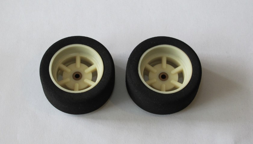

First is front wheels, one choice would be keeping the Bolink aluminium wheels. Another choice would be Thorp wheels, matching the rear wheels.
My second thought of change would be the steering setup. Yes this looks like binding, so removing the front trackrod would be a solution. But then the current setup looks somewhat "different" even when it doesn´t make sense. And ads an old style touch somehow.
What do you think, what would be your choice? Maybe you decide.

I would leave the steering as is, no binding on the shelf
And yes I would probably put matching Thorp wheels on the front.

Thanks. That´s exactly what I think. I have a set of Thorp front wheels.

Finished restoring process now. Actually this was just careful cleaning, no replacing of old parts. I think this is a historic car as anything is 1980 or older, even screws, nuts or tie-wraps. So I didn´t want to take away the soul of history.
Some details,
Body is a factory painted Parma Lola T-333 of 1978.
Electronics are early Futaba FP-S7 servo and FP-R2F receiver. ESC is a very early Electro Craft introduced in 1977, motor an Associated Igarashi 05 modified blue endbell. Front and rear wheels were made by Thorp as the special diff, spur and complete rear axle assembly. The solid rear axle is hardened and grinded, different from kit axle.
Chassis is a lightweight version but not the keyhole. The radio tray had been cutted for a new position of the receiver.
Also there are some unique solutions, maybe a little strange at first view. The steering setup with direct steering is different from usual RC12E cars, the additional forward tierod actually makes no sense but came with that car. The conversion for two body posts was made maybe because that body had been used at a Jerobee car before. At least the Lola body could be used at my Jerobee also.

Thorp diff hub, setscrew to solid axle. Note the size of the 3/8-24 diff nut, larger than pinion.
