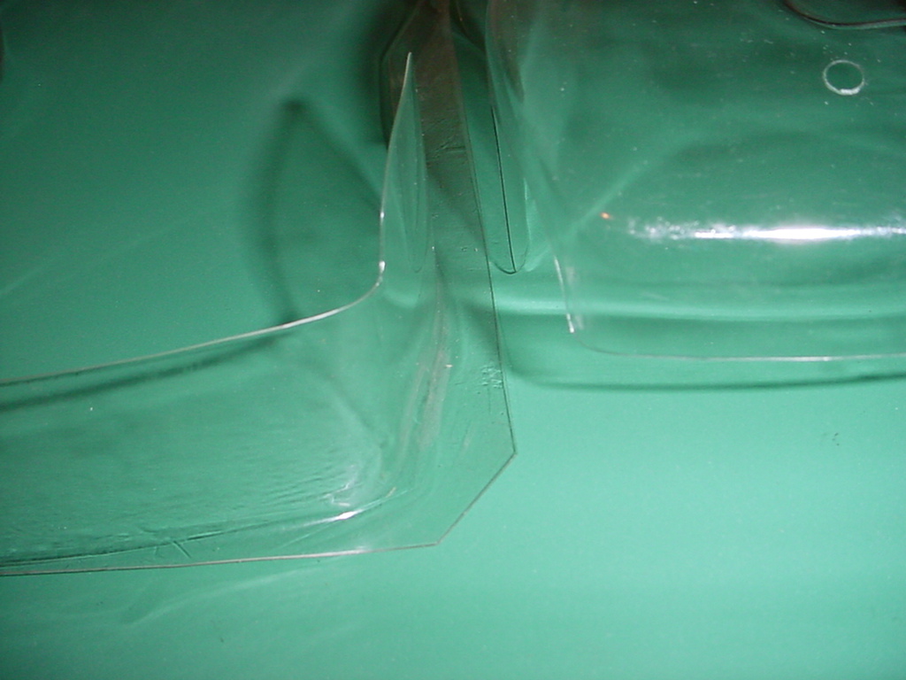

I've never been real happy with the lexan scissors method. Always seems to leave a slightly jagged edge which makes it easier for cracks to develop. I have always used an Xacto knife with A NEW BLADE. The new blade is the key. Lexan is somewhat like glass in that all you have to do is score it and it will break cleanly at that line.
I usually start at one of the front or rear corners and SLOWLY work your way around the body on the molded in cut line. If there is no cut line draw on the outside with a Sharpie where it needs to be cut. Using a moderate amount of pressure guide the knife all the way around without lifting the blade off of the body. Everywhere you have to restart it never seems to break cleanly and leaves a jagged portion that needs to be cleaned up later.
Now comes the fun part. After the body is scored all the way around you can bend a section back on itself and it will snap. Now if you have a clean scribe line the extra piece will basically be able to be torn away from the rest of the body. Kind of like opening the cellophane on a package of gum, you just need to get it started. You might have to bend it carefully when you get to edges or other details in the body for it to break away cleanly.
The result is two pieces of lexan, the body and the excess from the lower portion. If you have to do any cleanup or trimming, use the Xacto knife once again. But put a fresh blade in again, blades are cheap, bodies are not. Do a little practice on some scraps to get the feel for how much pressure it takes.
The results speak for themselves. I've been doing it this way for around 25 years now and I still find it the easiest and quickest method, even for an old shaky handed one like me. The XXT body in the attached pictures was done this afternoon in under 5 minutes and is the first one I have done in over 3 years. Just takes a little practice.
