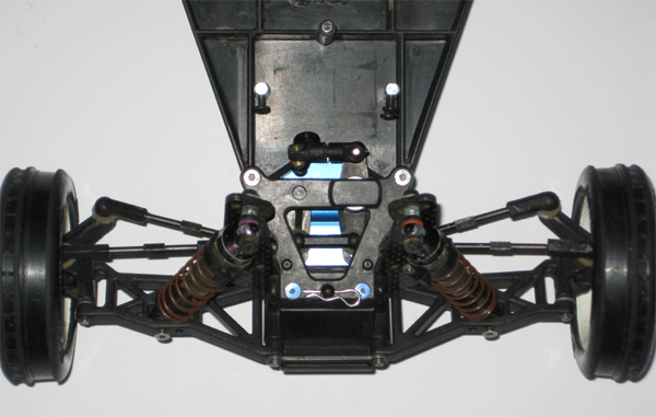

Since I am no RC10-expert at all I thought that I would ask You in this forum.
I have been looking for a B3 for a while in a somewhat good shape, a "runner". A friend of mine here in Hamburg had one, a B3 he said. It looked good and we made a trade: (he got an old, not complete Kyosho Scorpion-chassie from me).
As I got home I cleaned it a little and discovered a few things that made me wonder (and have some doubts) if this is a B3, B2 or a mix of the cars.
The things I refer to are the front and rear suspensionarms + the chassiplate (with only 1 option to mount the steeringservo). These parts are from a B2 or am I wrong? I would be very grateful if someone could help me out a little and thank You very much for Your time :)
// Torbjörn

Looks like a B3 with a B2 body.

It has Aluminum shock caps,those were on early b2's. He might have converted it from a B2 to B3 at some point. The rear arms have 2 holes, I thought the later cars had a 3rd outer hole added.
Ahhhh ok! :D Makes sense to me too since I found the 2-hole frontshockmount in the box that followed. (The B3 had 3 holes, is that correct)?
Many, many thx for Your help!
// Torbjörn

Spoke too quick. You are right. those arms are B2. No provisions for sway bars.
Steering turnbuckles are B3.
-Todd

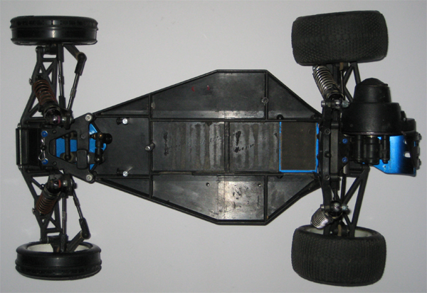

Only two shock holes on my B3 arms. Both front and rear.
If we could see under the body, that would help.

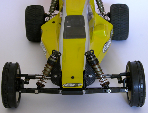

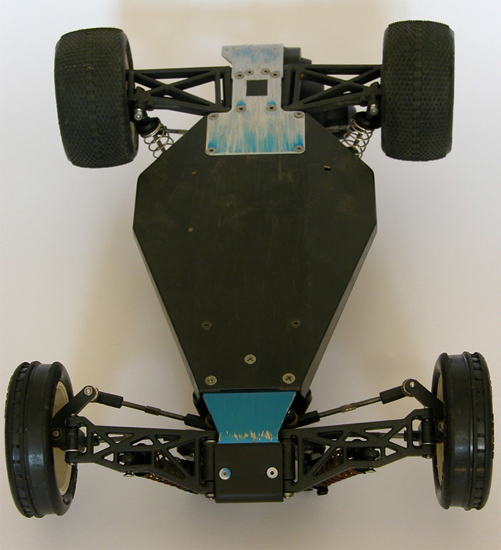

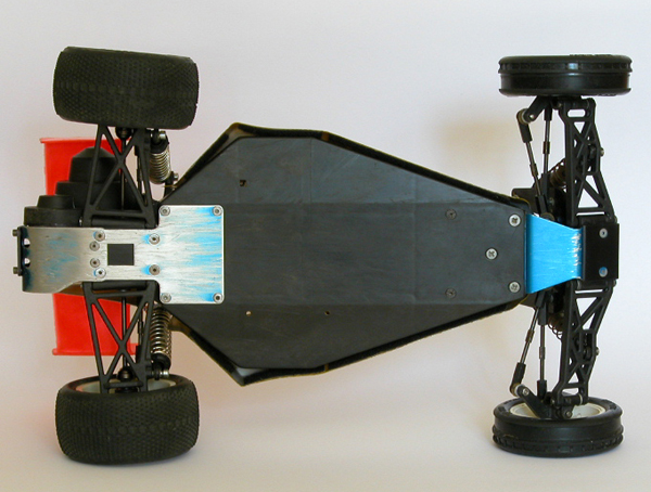

Some more pics here! :)

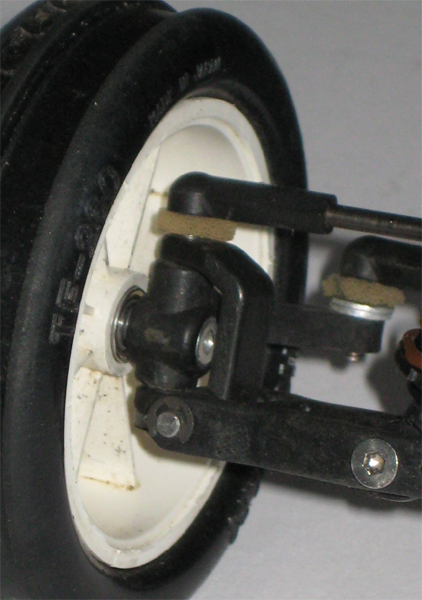

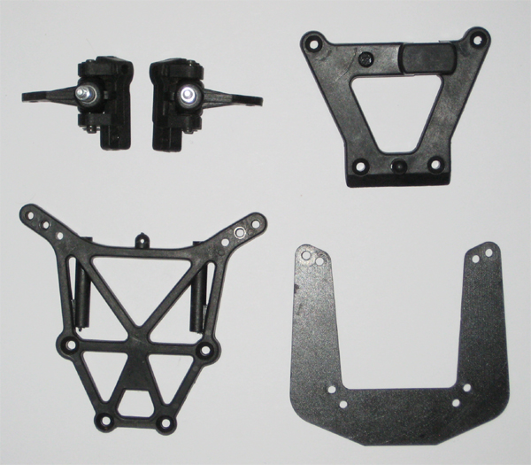

I did find some more loose parts that appears to be from the B2. It seems like he really changed it into a B3. The rearshock mount that I found is slightly smaller than the other one that is mounted now, the front top-plate looks a little different, steeringblocks & blockcarriers looks like the ones on slotcarrod´s car http://www.rc10talk.com/viewtopic.php?f=35&t=10942
Makes me think that this originally indeed is a B2... :?: ....and if it is I will definitely rebuild it to what it once was:)...

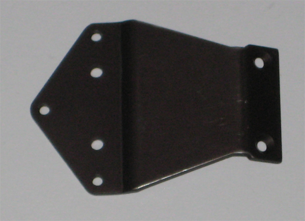

Noseplate from the box. Edit* This is much shorter than the one that is mounted now and I assume that this is for a completely different car?
blocks & carriers mounted at the moment. B3?
Only 2 holes for the servo

The parts that I found in the box

Looks like this car was originally a B2 but now has mostly b3 parts on it! It would be nice to see the top plate and inside the chassis, to see if it has the mounts for a sway bar??? That would tell it all!
Very nice car anyway!
Edit: Spoke too soon LOL! It is a B2! I would try to make it back into a B2, The b2 is far more rare! Looks like you would only need a black nose plate and a black B2 rear chassis plate, front arms, I think front upper turnbuckles and old type ball cups, and some universals from what I can see! If you are using it as a runner I would just use the CVD's.

Edit: Spoke too soon LOL! It is a B2! I would try to make it back into a B2, The b2 is far more rare! Looks like you would only need a black nose plate and a black B2 rear chassis plate and some universals!
Oh cool, thx a lot!! :D I did find a noseplate too! Is it a little shorter than the B3-plate??

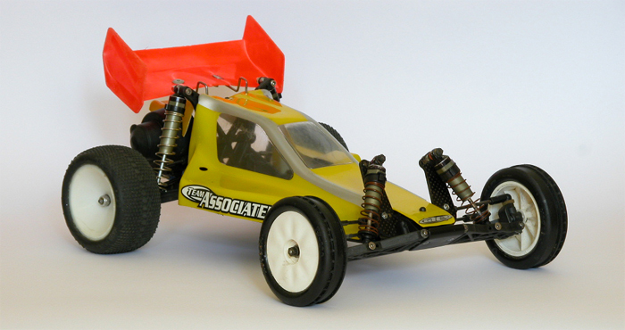

I do like that wing. Anybody know what it is?

AE also released a B3 conversion kit that mainly included towers and body i think. I can't remember all the details. The blue Anodized parts were a FACTORY TEAM option i believe for the B3.
Nice find. BITD the B3 was my first buggy.
