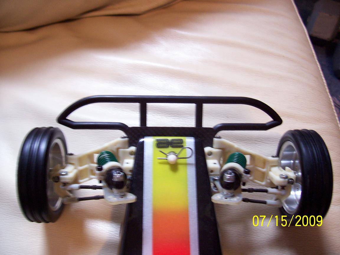

there are a few bumpers out there. Parma , porline, crp. I have a parma on my graphite. the pro line won't work on the graphite becuase the tires hit the the bumper at full turn i dont have crp so i cant say on that one. Stripping the paint may also remove the anodizing on the chassis . I have heard the brake fluid works but havent tried it. you may just want to pick up another chassis. let me post some pics.

here are a few pics.
PROLINE on the original gold tub
PARMA on the graphite.

i recieved a bumper with my rc10 graphite when i bought it off of ebay. It works really well, cause i run mine in the streets of san francisco and i hit the curb/ parked car's tires at full speed all the time w/ no dammage to the chasis (side scrapes of course, never head on yet), have snapped the front shock tower once though. Some bumpers do not mount on the orriginally drilled holes, and you gotta drill them yourself, so be careful you get it mounted right. I have one of the bumpers pictured above (the second one).
