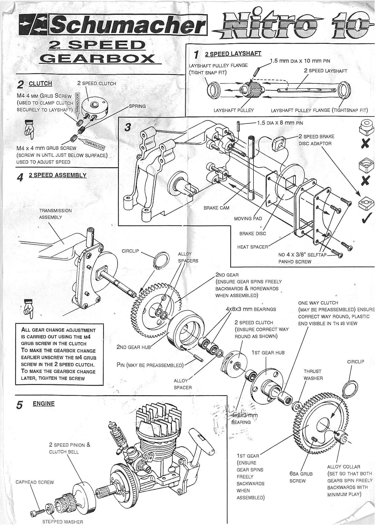

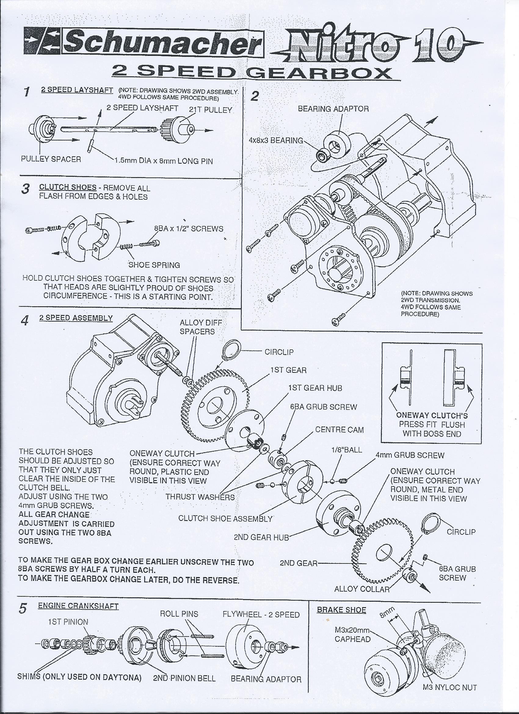

If you'd like some more comparisons.....
This is Schumacher U1399Q, the 2-speed setup for the Daytona. Later came U1665X (offroad) / U1666Y (onroad), the 2-speed setup for the later mk.3 Nitro 10 range. The first version is pretty much a copy of the PB 2-speed, while the second generation has some slight changes...

Yes, a pawl instead of shoes

The first one is exactly like the PB two speed but fitted with a second one way bearing as I tried but its for a nitro engine that's incapable of running backwards so it could never lock the transmition , the second later one seems to be like the HPI version or probably vice versa .
I love learning all this stuff thanks for sharing it guys , I think the PB version is a more elegant design as it would have a more gradual engagement than the later Schumacher or HPI design , those would both be quite a violent on off switch as the pawl engaged or disengaged . When holding the mustang and revving it up the engagement of second gear is quite sudden but when driven its easy to miss the exact moment of gear change as its fairly smooth , I found so far its easier to hear it change down and certainly you notice the cars attitude in a corner change more than you hear a change of revs .
