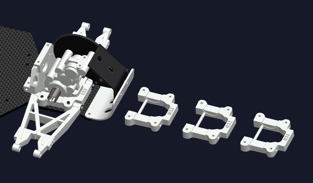

Niki
Posts: 522
Joined: Wed Nov 02, 2011 7:32 am
Location: Finland
Been thanked: 36 times
Re: NIX91 Questions and Answers
Post by Niki »
New stronger rear arm mounts are ready for racers and runners. Also smooths out stress in mounting holes.
NIX91-153 Race rear arm mount (1.5deg toe-in/side + 3deg anti-squat)
NIX91-033 Race rear arm mount (3deg toe-in/side + 3deg anti-squat)
NIX91-032 Race rear arm mount (3deg toe-in/side + 2deg anti-squat)
NIX91-031 Race rear arm mount (3deg toe-in/side + 1deg anti-squat)
NIX91-001 still available for replicas.
https://www.shapeways.com/shops/nixconcepts?sort=newest&section=NIX91&s=0
-Niki-
